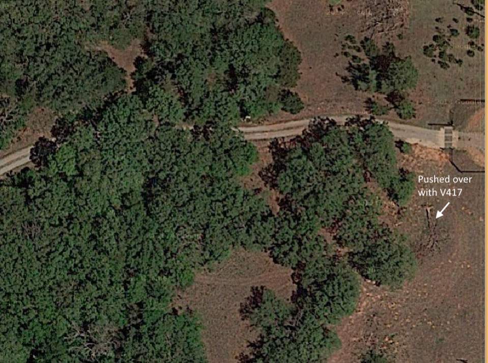

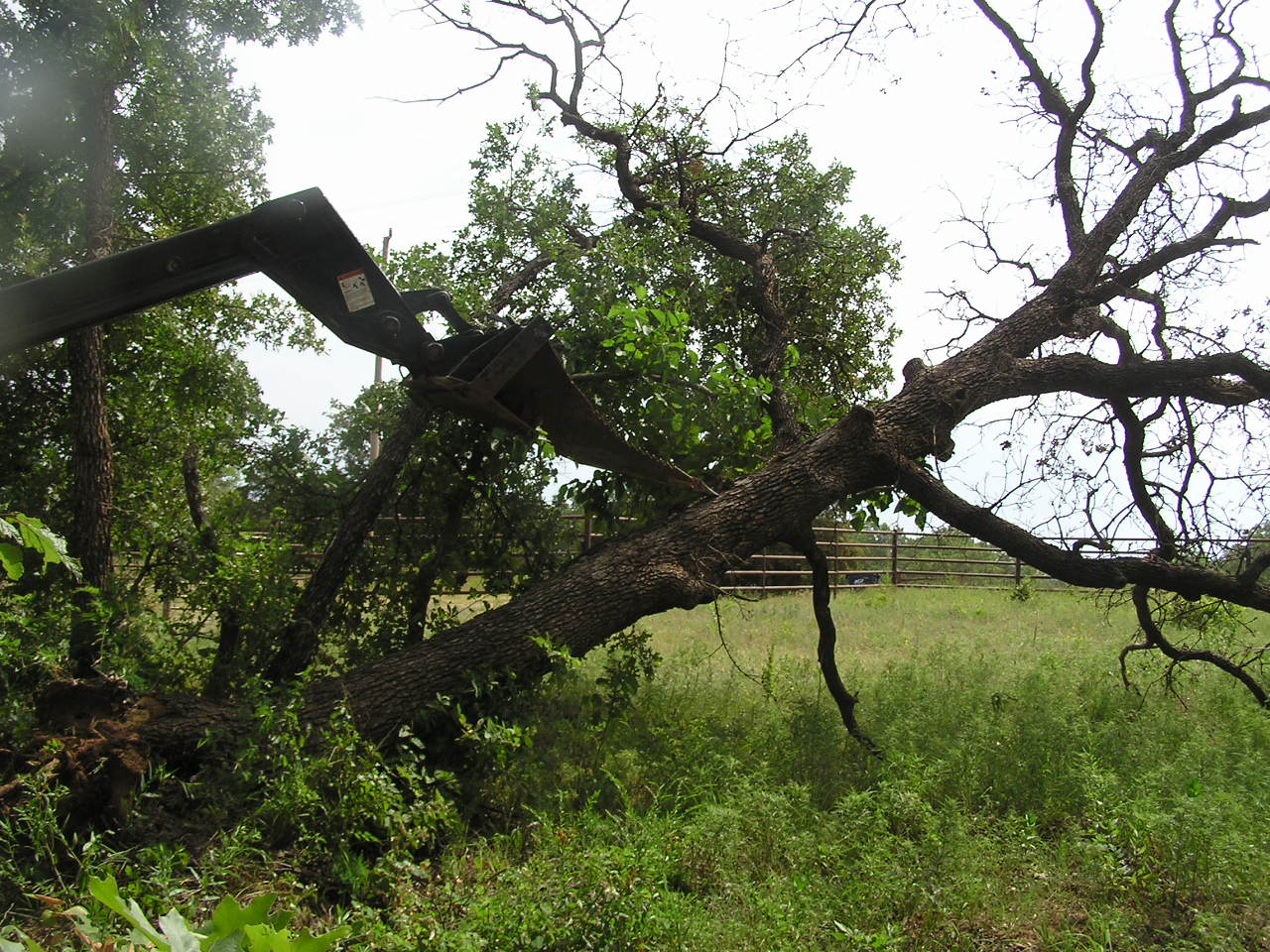

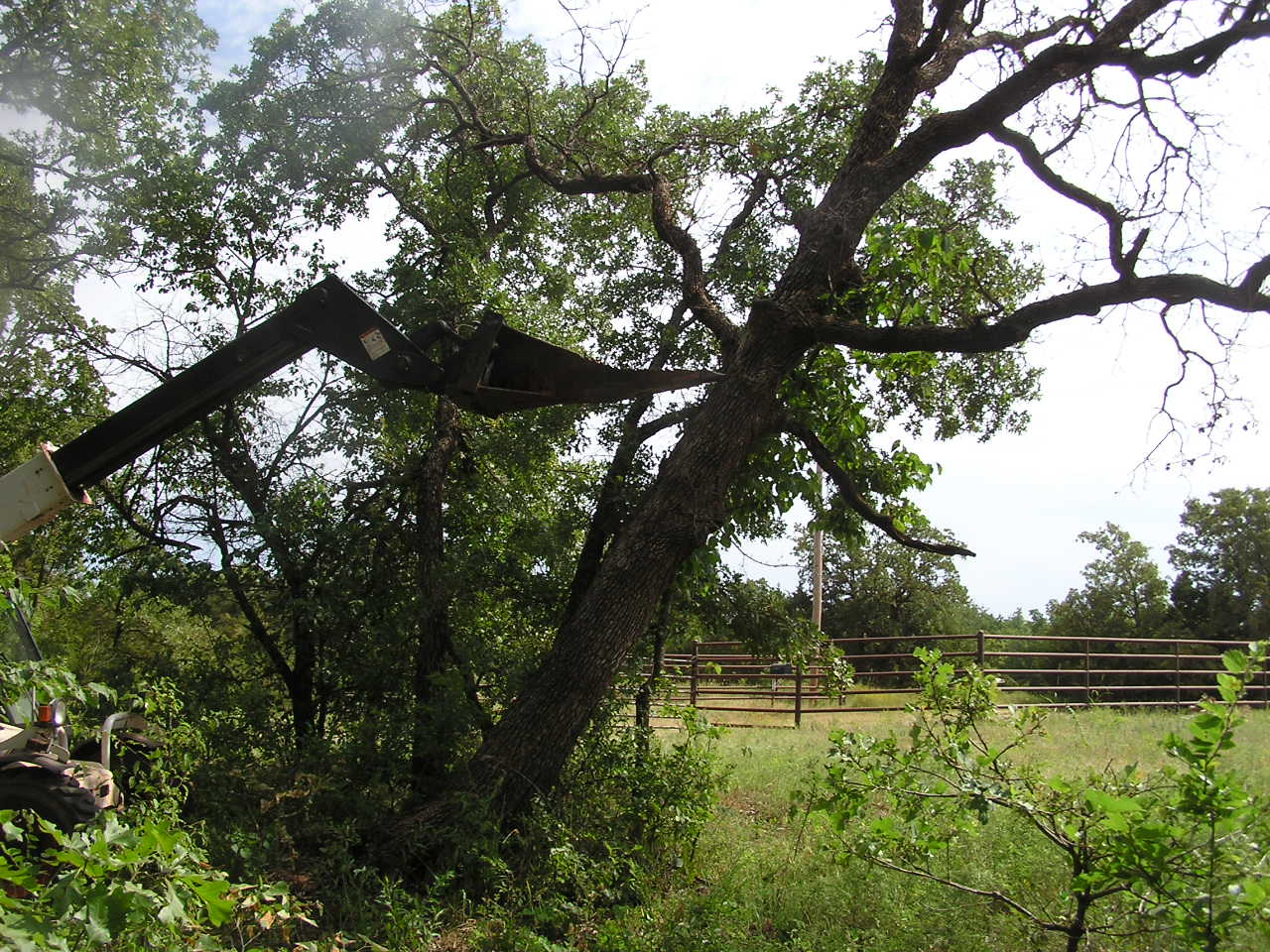

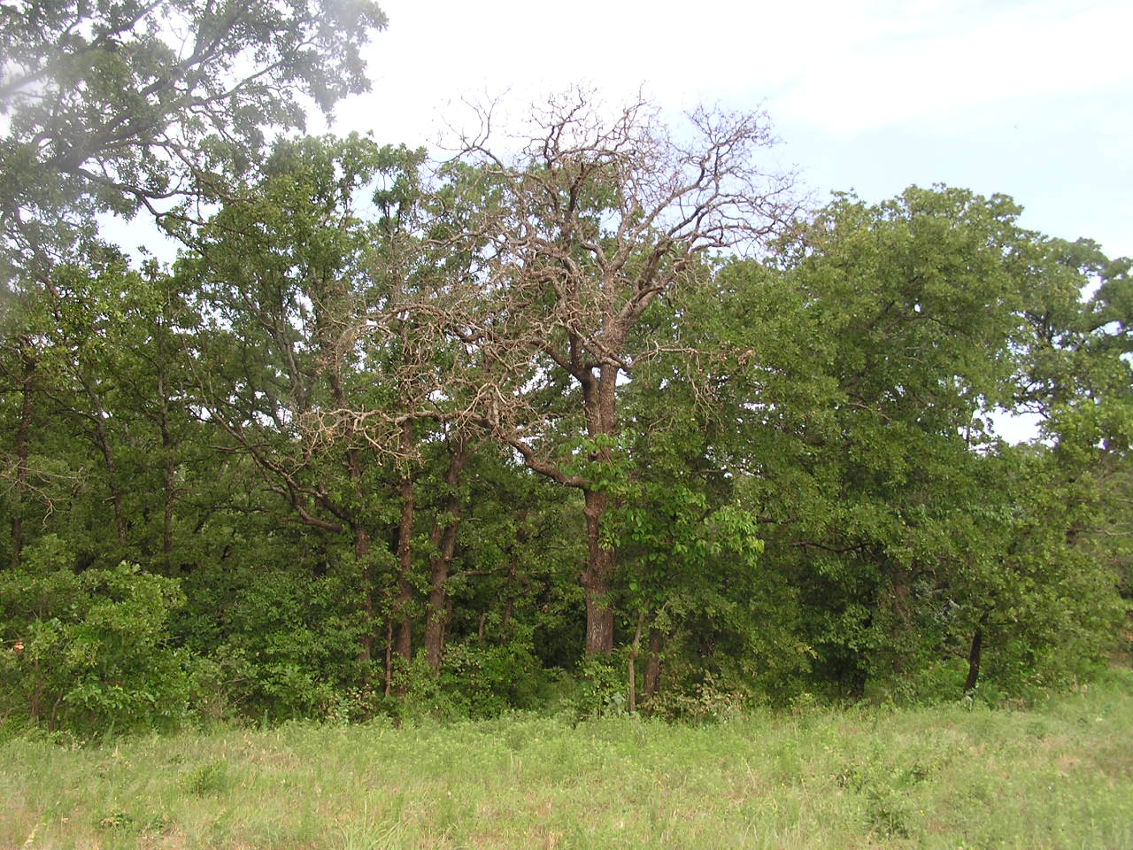

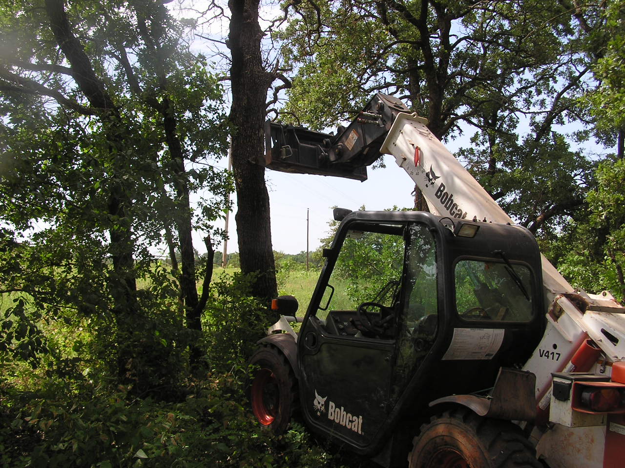

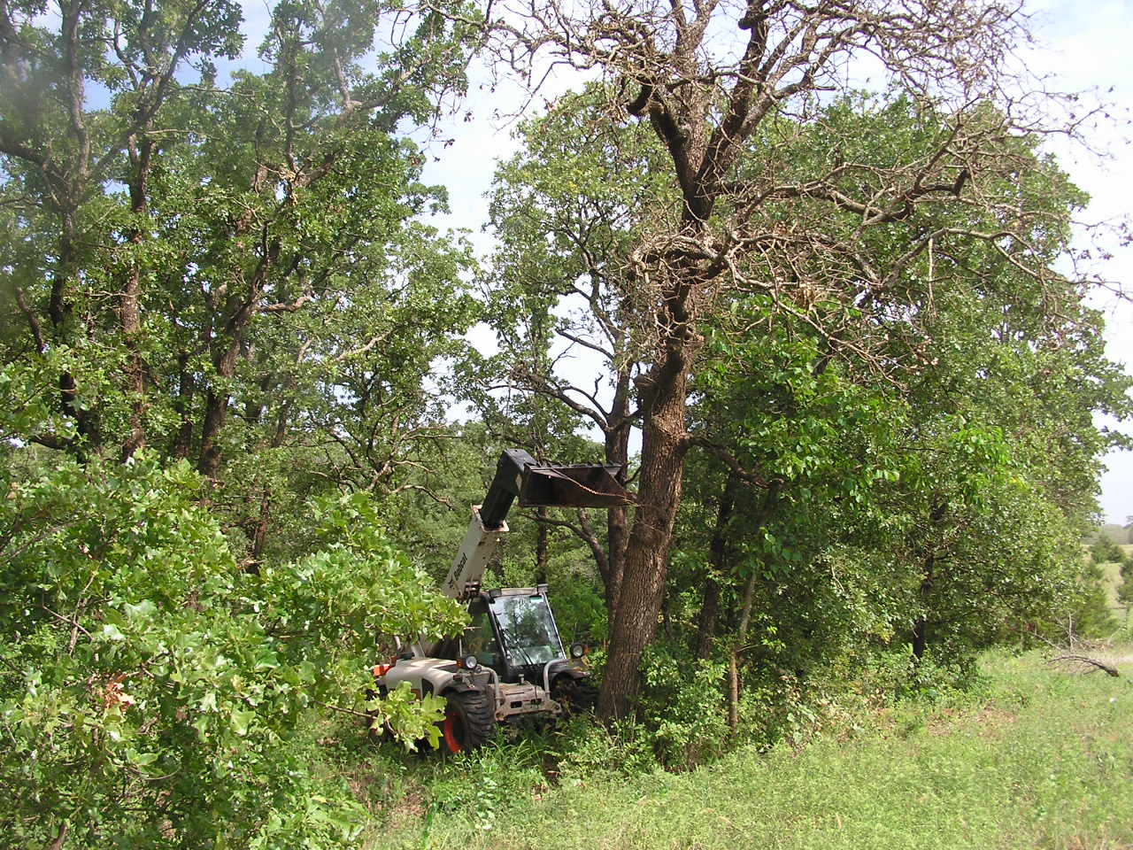

This is how I deal with big dead trees using the V417 and the stump bucket.
Slowly extend the boom.
Top of the tree is on the ground, drive around and pop the roots out.
Got the roots out and several months later, moved it to a brush pile.
It showed on the satellite before I moved it.

I do that with my tractor as well, but only if I know the tree isn't going to lean or fall back towards me. If I can't get behind it or know that it won't fall back, then I'll attach a cable and pull the bottom out towards me from a long way away.
Oh, and another thing I always do: Make this the first job of the day so I'm not tired, in a hurry or not looking at all the options/angles and/or all three. Like that hickory tree above: I had already spent a good part of the day out in the woods, was a bit tired and just didn't feel like messing with it at the time. Thought about it over night (and listened to the suggestions here) and took it down - safely - in about one minute.
