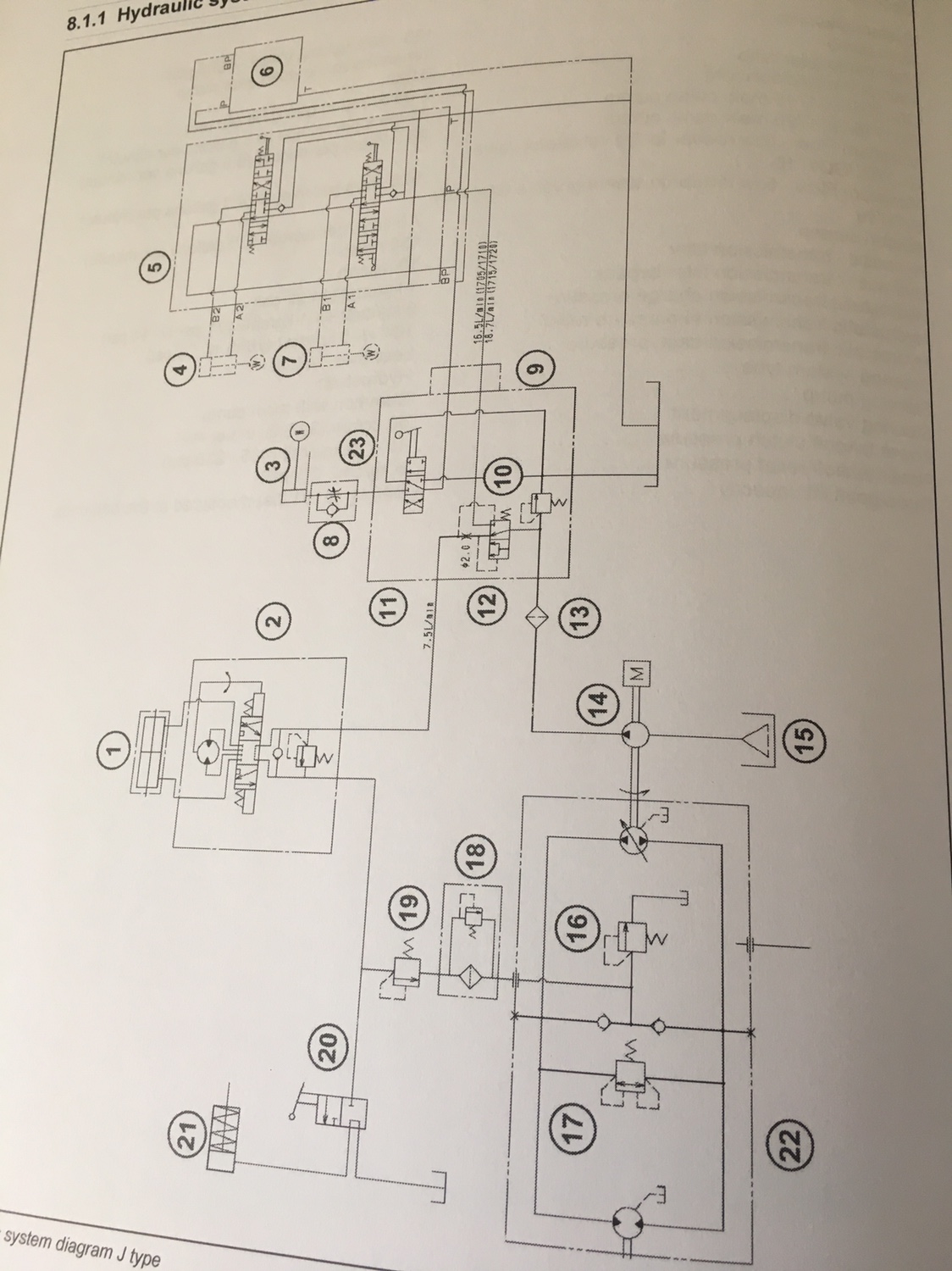

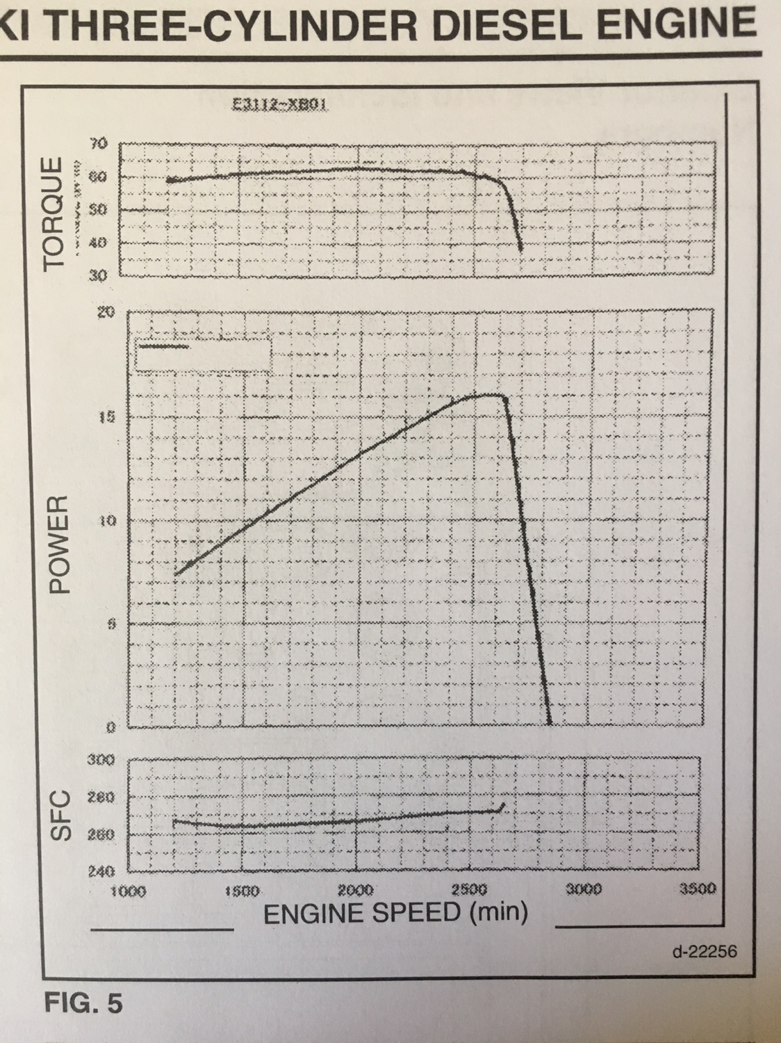

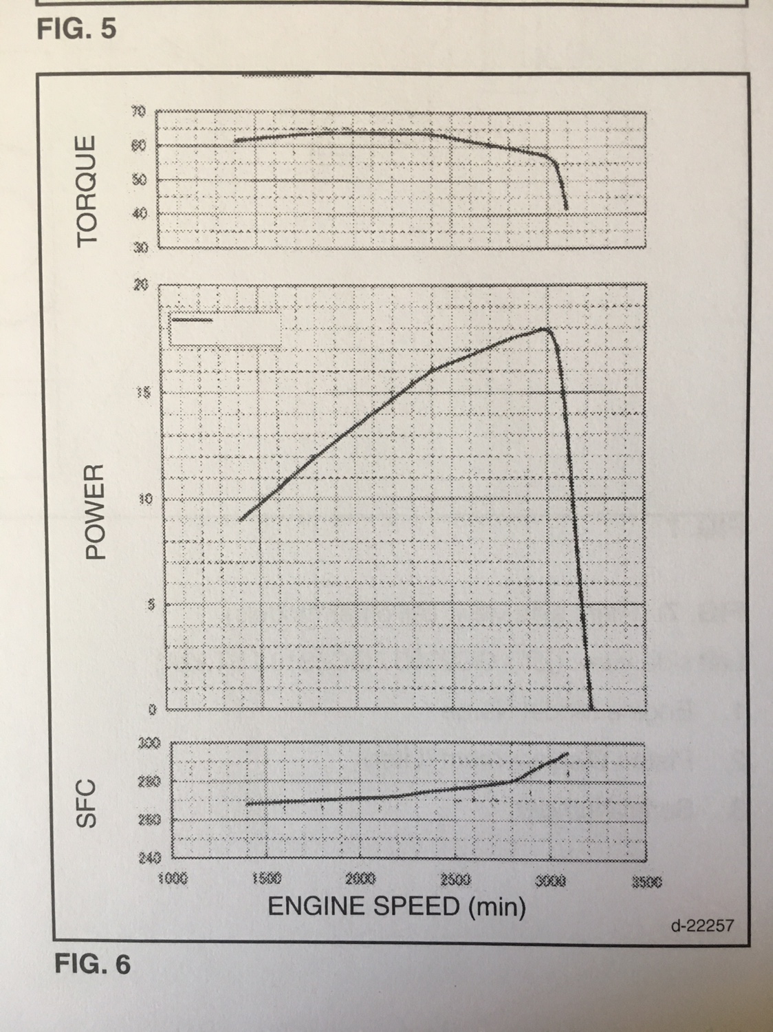

Found these in the engine service manual and thought they were worth posting. A lot of conclusions can be drawn from this data!

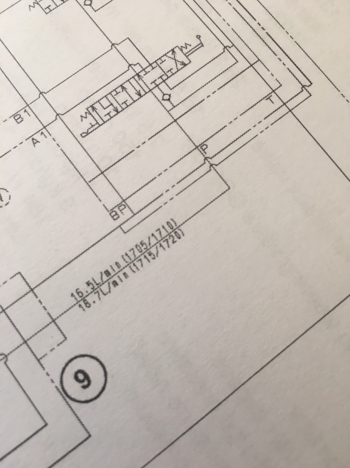

My simple conclusion if your stuck between the 1705/10 vs 1715/20: If you are mainly using PTO attachments at 540rpm you will see just about the same power and much better fuel consumption with the less output engine. If hydraulic flow is critical and you are already thinking of a log splitter or other heavy GPM flow needs then going for the higher output engine may be best. (13% more flow for attachments on the higher output models 4.9 vs 4.4 gpm at the attachments). Why doesn't Massey make the dealers more aware of this data, the multiple dealers I spoke with were all knowledgeable but when asked the difference they all said, better seat, light guards, and just a bit more power. Really I think for anyone considering it's about PTO vs hydraulic flow use. Also for mowing the SFCs are much better on the smaller output motor. Just my 2 cents and a little contribution from a newbie member. Have a great Labor Day weekend!

Comparing the SFC (specific fuel consumption) charts to one another was my simple conclusion, depending on what throttle % you use on what application the lesser power GC has better fuel economy. To get that extra power in the higher power GC takes up quite a bit more fuel, not just at the higher RPM it can obtain but throughout the rev range....at least according to the data. If you are running a PTO implement at 540rpm (per most implements), the high power GC makes 18.7hp at the PTO the lower power GC makes 18.5hp at the PTO additionally the lower power GC makes 540rpm at the PTO at 2532rpm, the ladder at 2829rpm (quite a bit more fuel used on the higher GC for 0.2 hp. To me this equates to the lower GC cost and fuel savings being the better deal for most PTO driven implements (if you run recommended implement rpm). Now if you are going to be running compact tractor implements on a SCUT...then please get all the power you can.....

Not sure I don't disagree with your 2nd statement, however the PTO if ran at recommended RPM has better fuel economy on the lesser engine (as mentioned above). Higher HP shows up at the hydraulic port by the measurement of more flow at the same given pressure. Which is why you do see a pretty significant jump in flow at full RPM in the higher output engine at full throttle where the power difference is greatest.

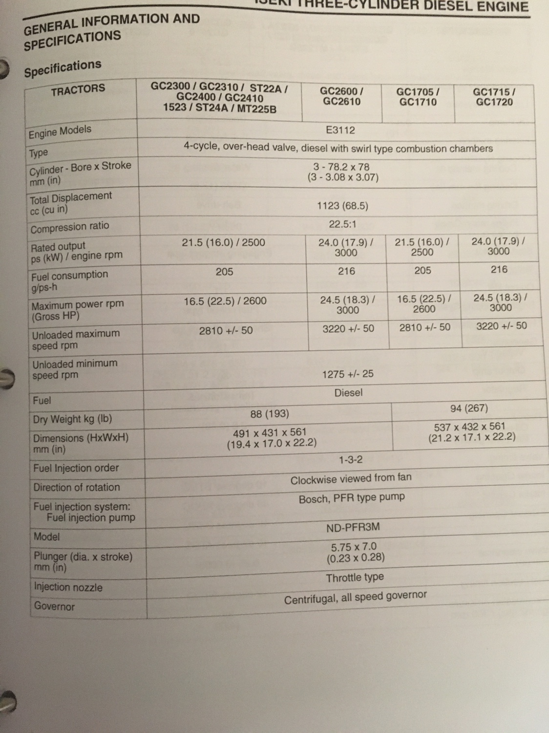

The gc1715/1720 makes it's extra power with more RPM and more fuel. It's the same engine and same fuel pump, just adjusted for more fuel flow in the pump.

According to the charts, at 2600 rpm the 1705 makes a bit less power with a bit less consumption than the 1715. The difference between the engines must be more than just having a raised max speed since the curves are different at same speed points. It's still probably all in the tuning though. The 1715 appears to be fueling a bit more at same rpm plus it has a larger rpm range.

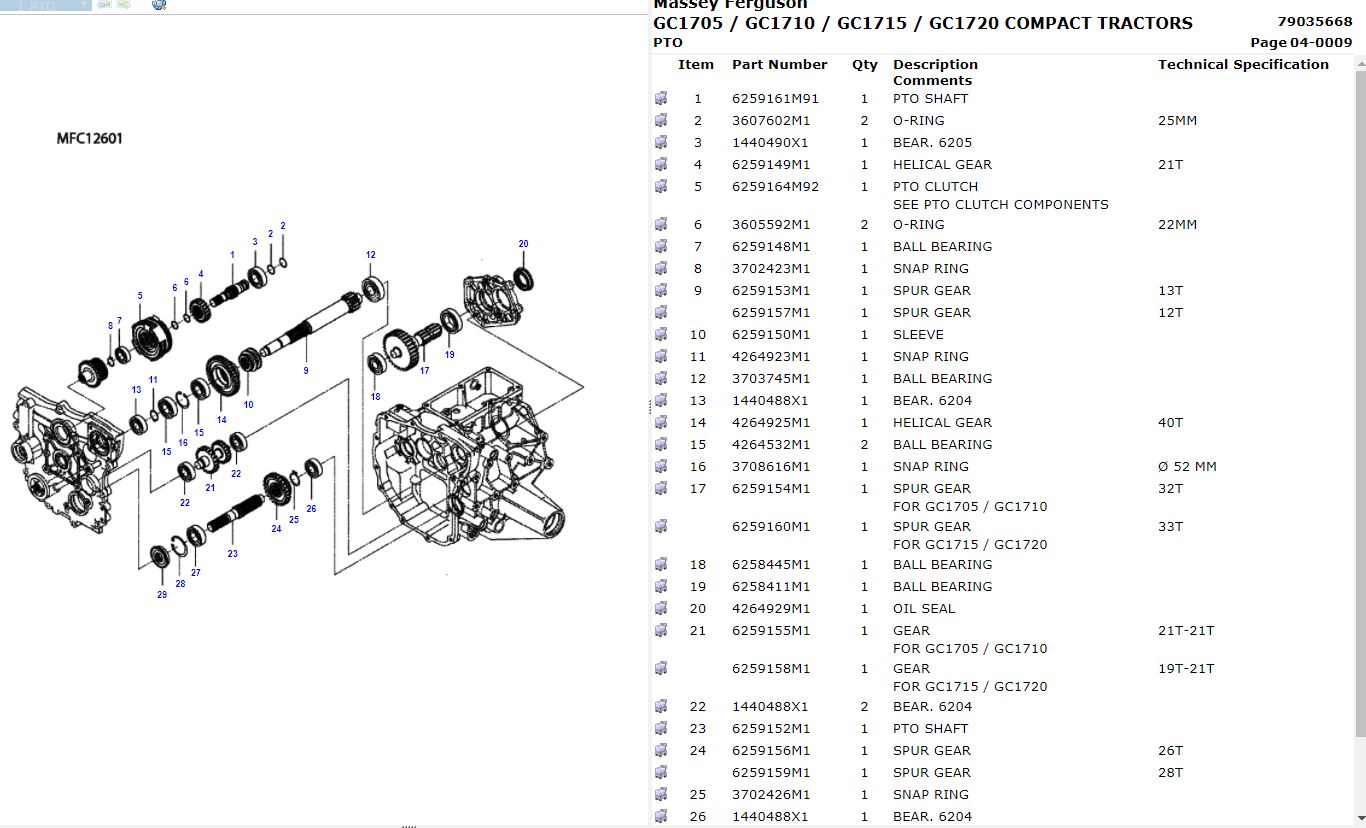

Keep in mind that the gearing for the PTO is different so 1715 runs at higher engine speed compared to 1705 for the same PTO speed so the consumption difference is more than just the slight difference noted above in the 2600 rpm example.

No, they wouldn't use the same amount of fuel. The 1715/20 are set up to flow more fuel in the pump for any given rpm. That is one of the physical differences between the two. The fuel pumps do not have the same flow rates. Yes, the charts confirm this...

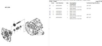

You really had my mind wondering...."you are right since the PTO is gear driven and to obtain 540 rpm at the PTO takes different RPM on each model....something in the gearcase is different! (which most people have never mentioned at least in my research....) ......So I went and looked at the parts book.....low and behold two gear shafts are different in the gear box between the two models.....Here is the real odd part....usually when you increase engine hp you increase torque and thus you can gear "up" the transmission (meaning go down in ratio)....however on the 1715/20 they actually gear down and make it so you run higher RPM to obtain the 540 PTO RPM.....alright this was my 10 minute review....when I have time this weekend I will look into this further.....pretty interesting!
...and gearing different on hydraulic pump, which explains the different flow and not just being about the greater RPM.....
