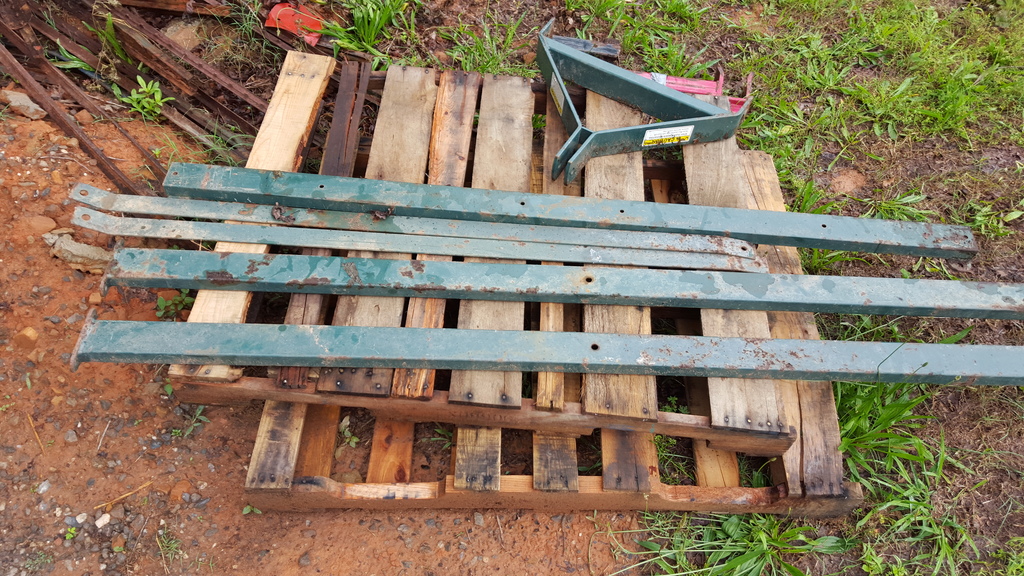

I was cleaning up around an old run down barn, and found this...
Looks as if it will make a small platform on the 3-PT... I have no idea what it would be used for...
Maybe I can use it to stack and carry firewood or something....
What is it?
What should it be used for?
Thanks

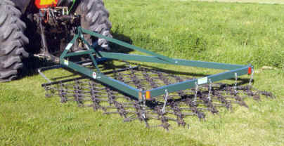

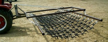

Looks like a lift frame for a chain harrow.
Examples:
The first one looks very close.

Wow - the first pic in green looks like the same model....

A good description and video here:
Hackett Flexible Chain Harrow SG Pull type with Draw Bar
In their photo, you can see why a lift frame is desired. Otherwise, you just have to drag it on the ground wherever you go. Some use it with a 3pt boom to lift it for moving.

Thanks guys...
With my property - I am not sure that I will have a use for this, + The chain was not in that junk pile, but who knows there is still more junk to go through.
I was looking to make a platform to carry 55gal drum, or the 275gal tote full of water to get to my fruit trees.
The steel is good, but I am not sure what kind of weight I can expect it to hold.
Maybe make it into a firewood rack, or just use it as a ballast box frame....
