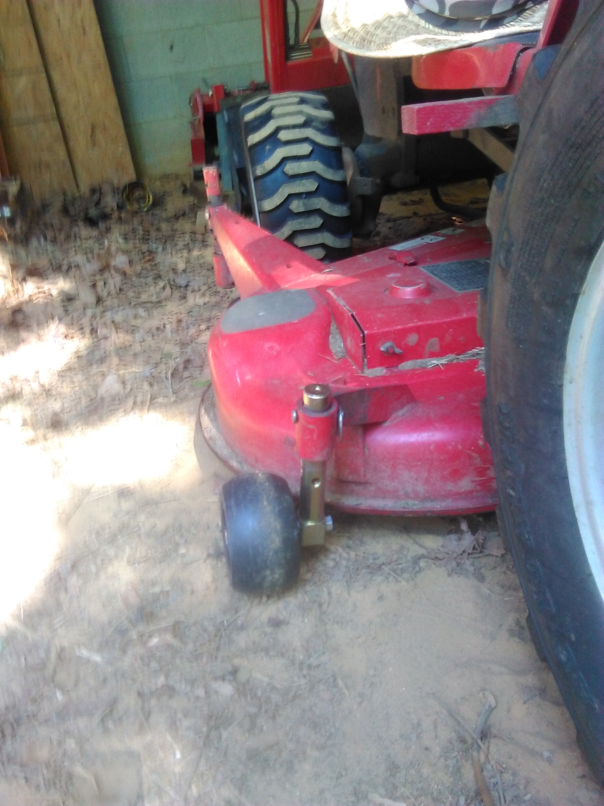

I have replaced 1 rear gauge wheel with the Kubota (no grease fitting) equivalent. Costs for pin & wheel assembly were $32 delivered to my door. The pin fits while it is shorter than the MF and I did grind off ~1/8" off the shaft insert. It was too long to fit. Alternatively I could have gotten a longer bolt.
My solution for now is to just keep the wheels high enough to just barely touch any high spots. That's probably the way they were designed to work. The Kubota solution adds more options for height, more importantly they can be turned 90 degrees for removing/sliding the deck from underneath the tractor. At 73YO that's getting to be more important. ;-)

Pics of the kubota rear wheel on 2325 mower deck

...Just saw your pic; not too shabby! And those were standard Kubota parts?

"Just saw your pic; not too shabby! And those were standard kubota parts? " Yup!

mewaschuk, I don't remember the part # anymore, but I got it from Messicks, Kubota Parts | Buy Online & Save It might have been this part #: K5221-72600 I can't find a pic nor specs for this # now. Spend some time on their site looking through the mower deck parts, and you should find it. Good luck.
I looked through the various parts diagrams and that does appear to be the part number for the whole assembly. I ordered just the post and a new wheel of the assembly. Post =$22.90, wheel = $8.65 axle/shoulder bolt = $8.16, washer = $0.10 and nut = $0.30 $40.11 for those parts.
