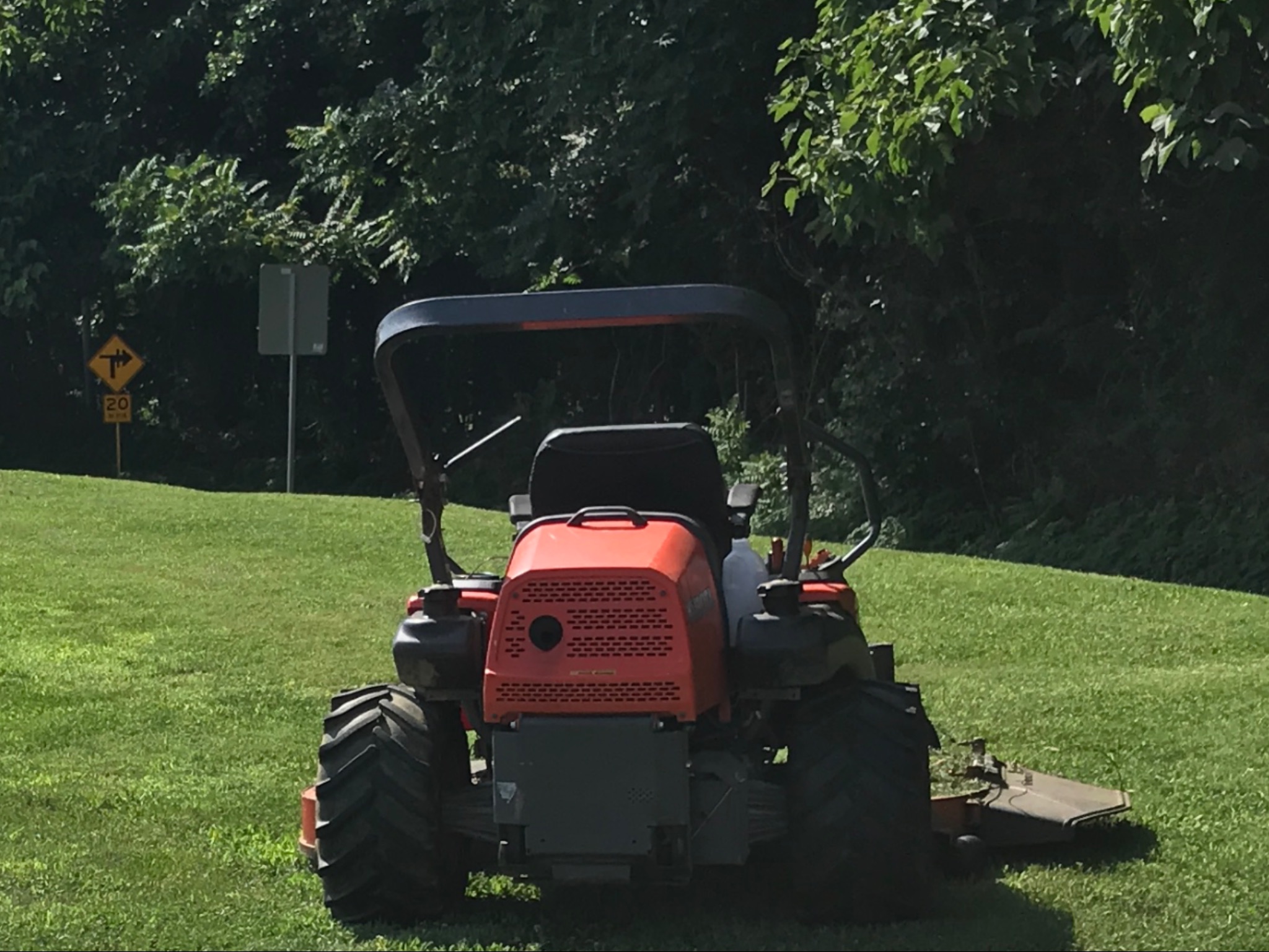

We have a dated awd, center actuating Husky which are no longer being built. Love the darn thing on our super hilly yard and would buy another if we could. What to do, what to do, what to do..
