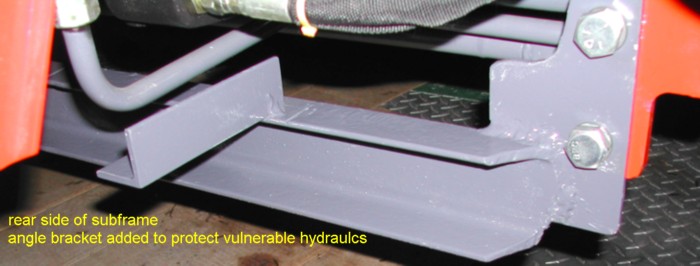

Has anyone put together a bolt on fix to put some protection around it. If so, please show a picture. I'm the worlds worst welder so I think it would have to be a bolt up fix if I were to do it.

Putting a guard uner there is on my to do this winter list, when it's too cold to find a reason to use the tractor :laughing:.

I believe Michigan iron makes and sells an und body cage.

This filter must hang down a long way.
Can anyone supply a picture of it?
I'm using a full belly plate and that is no guarantee that something won't get through.
Here's a couple pix from a subframe thread. The hyd pipe in the
second photo can easily get hit, and spew your oil on the ground
at 8.3GPM. I built protection into my hoe subframe.
I put a skid plate under my Bobcat CT230, using an old remnant of
JD FEL bucket.
   / fractured the HST filter mount #20
Did they same thing about 2 years ago, easy fix just replace the housing. I also built a guard around mine and have bent the guard but never broke the filter off again.
