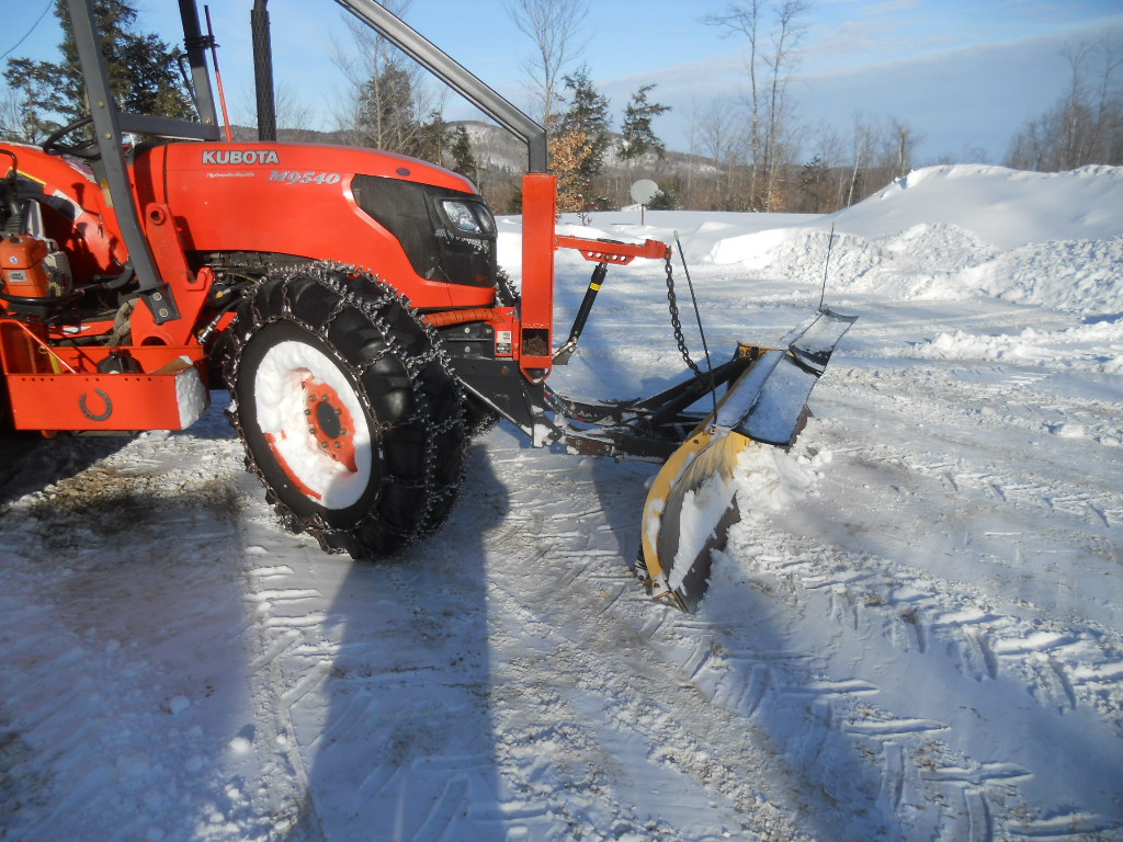

Nice setup. I bet it works good on your tractor.
   / Frame mount snowplow Kubota 9540
#12
I mounted a 9ft straight blade in a similar way and I think you'll be happy with the set up. Initially I was looking for a v blade but I was concerned about valving the angle cylinders from the tractor, the blades I looked at used single acting with spring return.
Dose the fisher have double acting Rams?
Yes, they use d.a. cylinders on the blade.

At first glance at one if the pics I thought you mounted grapple arms to your plow! Naaah. Though if it was real icy...
Nice work- should be a treat.

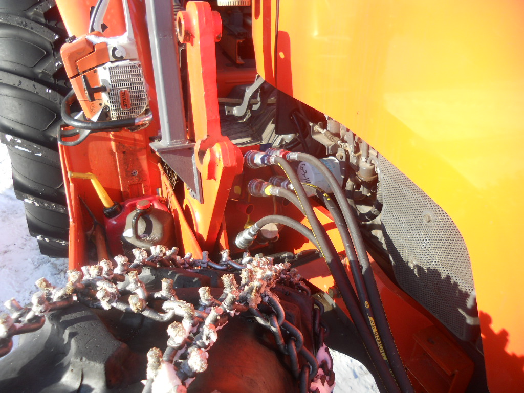

Just got the hyd. lines & fittings to finish. Got to break it in today and I'm happy with it. All of the plow's 3 functions are on the loader's joystick, just a little learning curve. It's almost too fast, even at an idle. The factory quick connect fittings are 1/2", "necked down" to 3/8 hose, then ultimately 1/4" at the cylinders. I was hoping that would restrict it down somewhere near what the electric pump that it was designed to operate with supplied.
