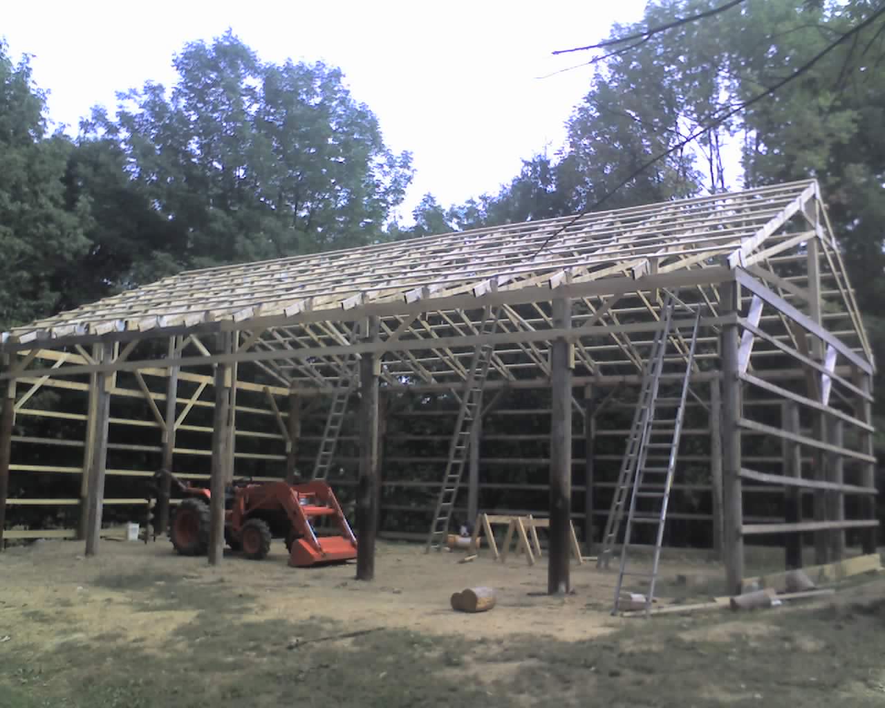

I think eddie has pretty well nailed it spot on.
It doesnt matter how handy you are, or how good at building things you are, you will never be as fast or as efficent as someone who is in the business and does it day in and day out.
Framing it yourself will absolutly save you money. How much you save depends on the bids you get. But at the expense of your time, and possibly not being done to your satisfaction.
Framers can be pretty competitive. It (depending on reigon) may not cost as much as you think. Because while they do charge a good bit for their labor, they are getting a much better deal on materials, and will have less wasted materials because they know exactally what they are doing.
Plus, as others have mentioned, you have to take your health into consideration. Are you physically capable of doing the work?
If you are, and feel you can tackle it, and if it will save you enough to make it worthwhile, there comes a great sense of pride and satisfaction in doing it yourself.
Personally, I aint picky. I know my work aint perfect. But I'd rather have something I did from scratch that has some "character" vs a perfect building that I just watched be build.
Here is a shot of my framing:thumbsup: Probabally one of the pics eddie was refering to about biting his tongue:D
And heres a link to my thread. (I know there are a ton of others that people have done) http://www.tractorbynet.com/forums/projects/192429-my-uniquely-built-30x50-pole.html
