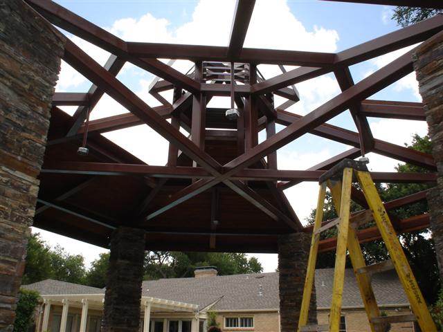

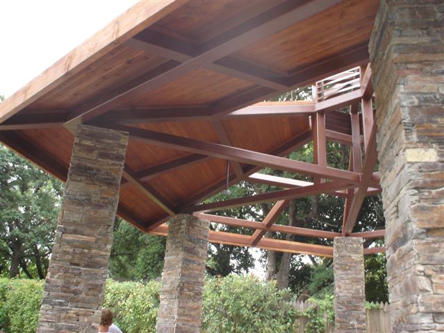

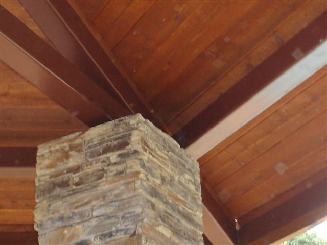

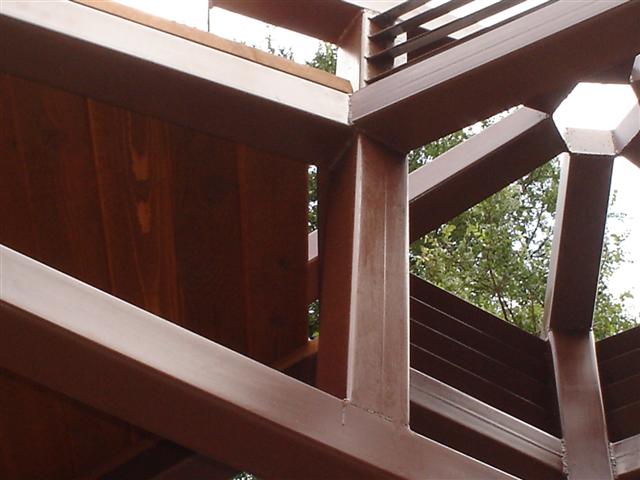

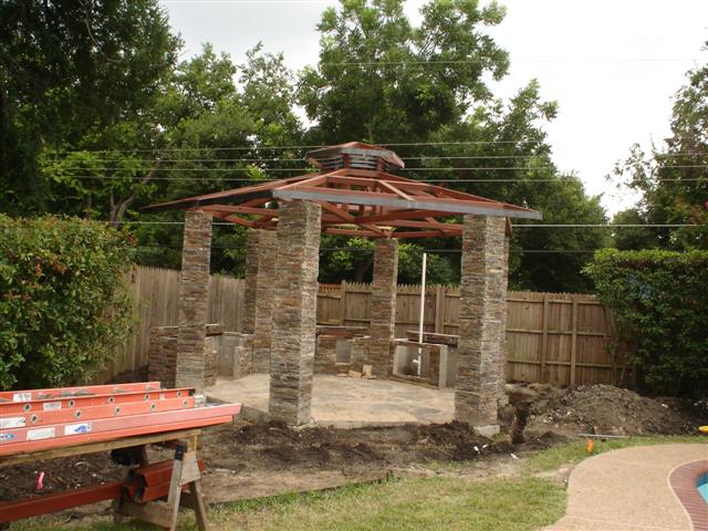

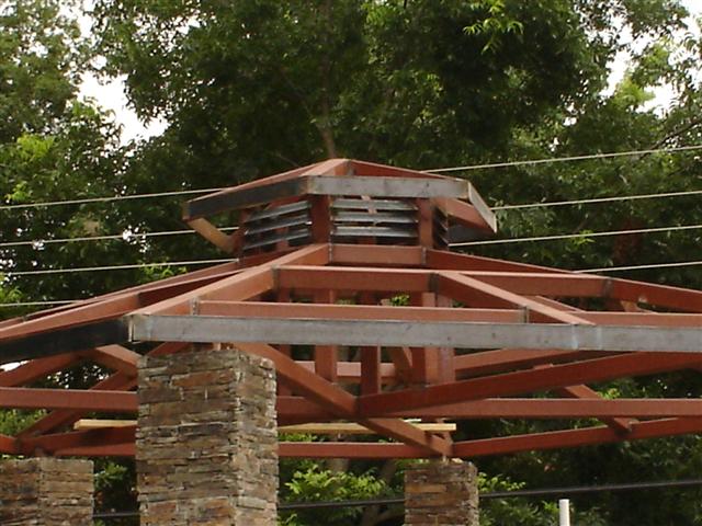

What I'd do is visually verify the straightness along with squareness of the sheet ledge. You can use a string but you always check out the string with a look, right?
If the forms were done right and the sheet ledge lines are correct then it's nothing but a thing. Depending on how you're going to attach your sheets, purlins in between the posts or on the face of the posts, I'd line up accordingly along the sheet line and start welding in posts. I'd pick one end to measure off of for post spacing and then pull off of the ledge for the other direction. Plumb up the post and weld that puppy in. When all the posts are up I'd do a top plate and then do the trusses.
I stick build with steel sometimes. What has simplified this for me is the new steel cutting steel blades for circular saws. I can do radical compound angle cuts accurate enough to weld them up three hundred and sixty degrees. I'm attaching some photos of a gazebo I just left for the wood guys to cover. It's about twenty one foot in diameter. The steel is all four by four eleven gauge and I did it all by myself. If you want to have fun grab a twenty one foot piece of four by four eleven gauge and place it on top of two posts ten feet high.
