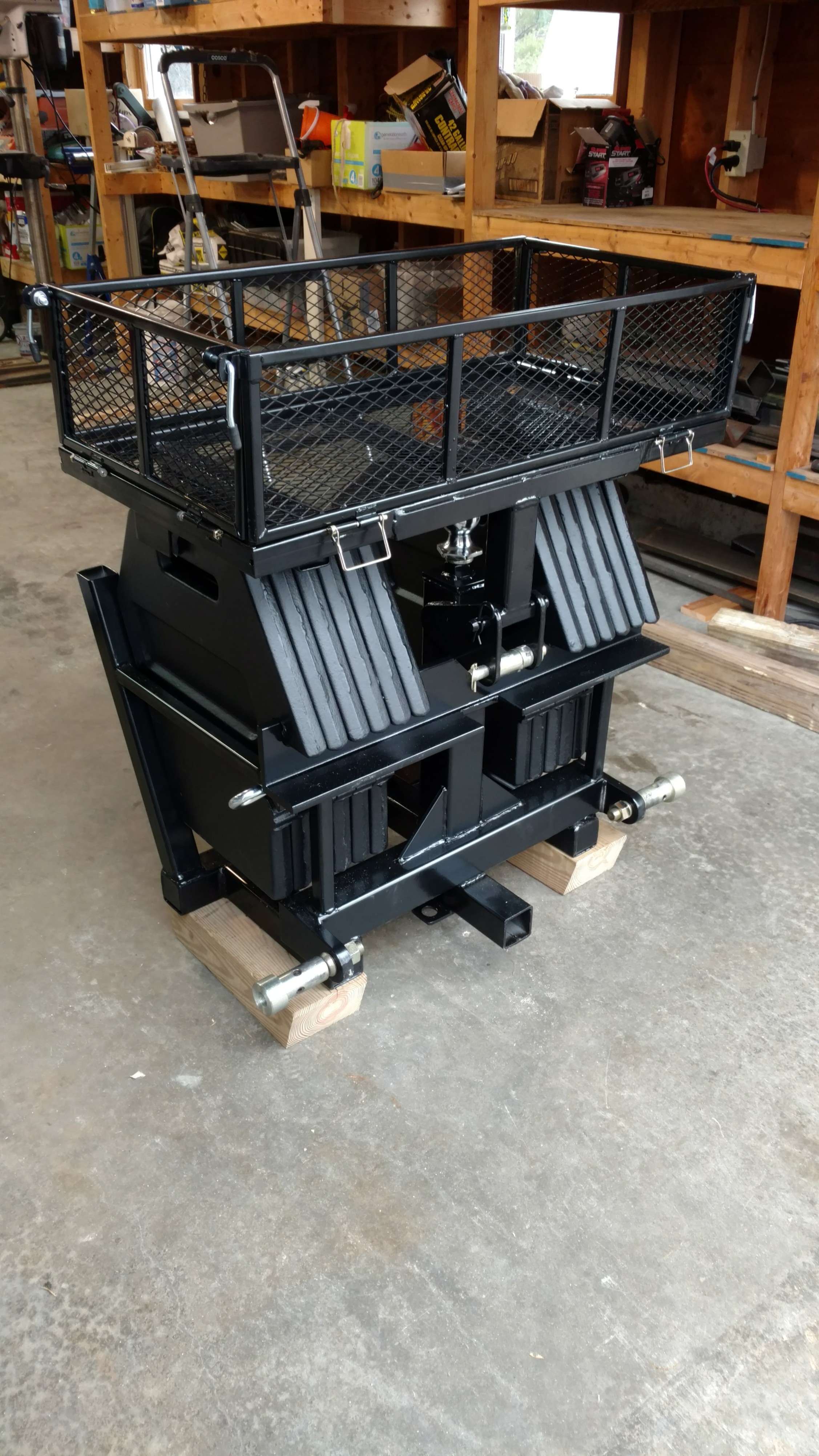

I needed a heaver 3pt ballast so I bought twelve- 100lbs Case suitcase weights for 60cents per pound with the idea of converting a TSC trailer mover I had into a weight rack... I also ended up buying about $80 of hardware and metal. Most of the metal was stuff I already had but wasn't free when acquired. A lot more than my previous concrete box.

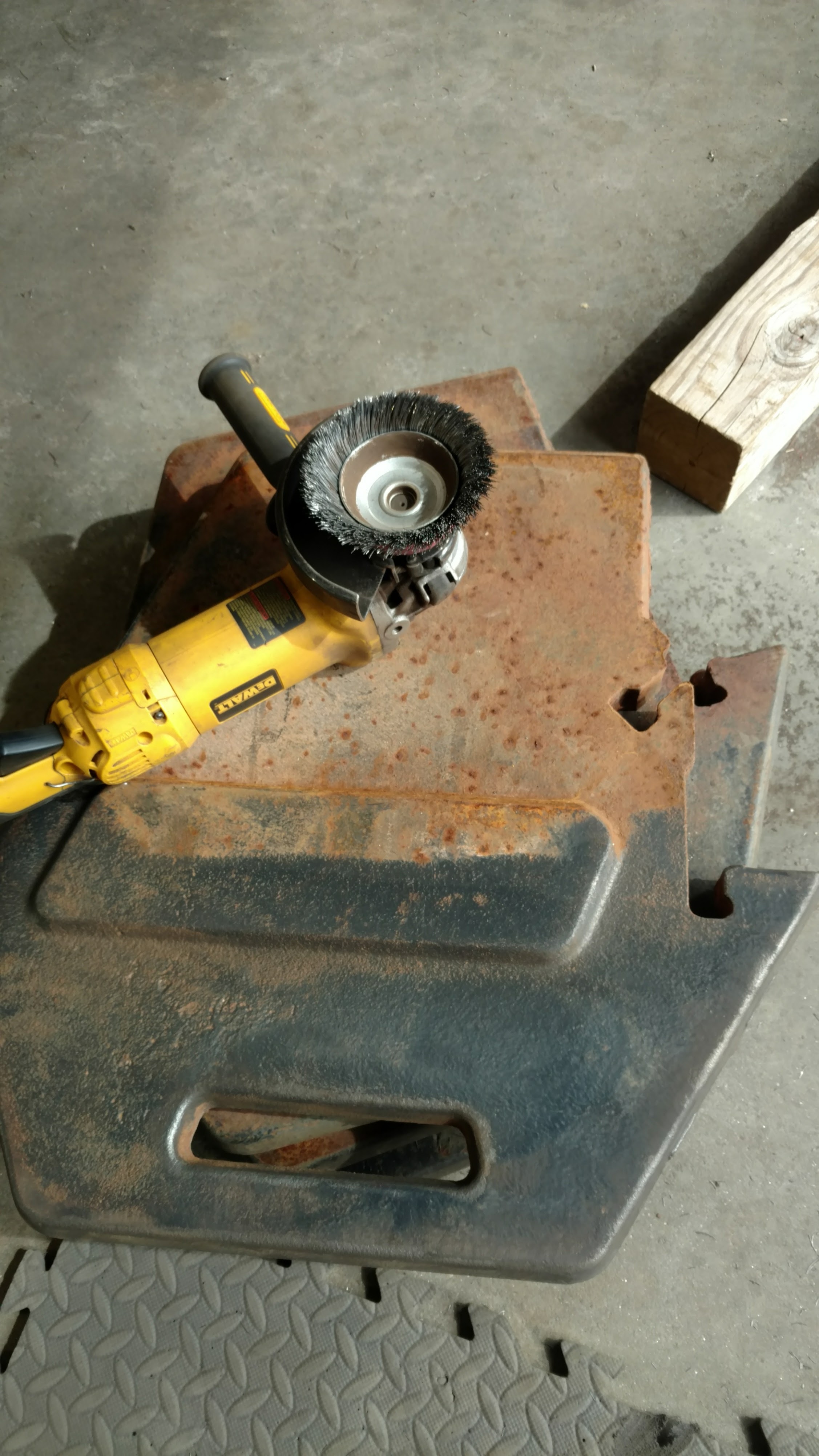

I first wire wheeled the weights (glad I wore safety glasses):

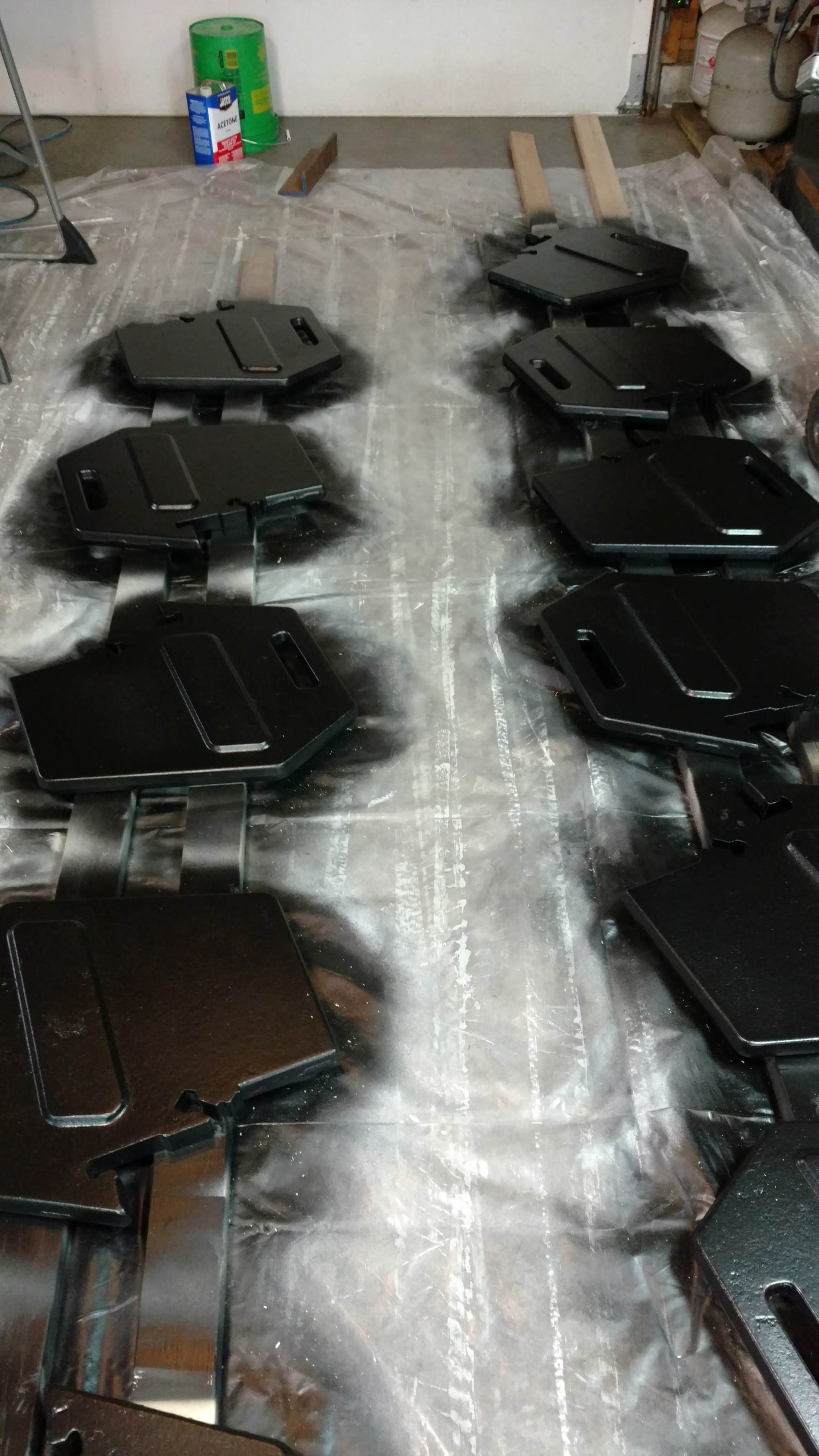

Then I attempted my first HF spray gun paint job with rustoleum primer and semigloss black (came out good enough):

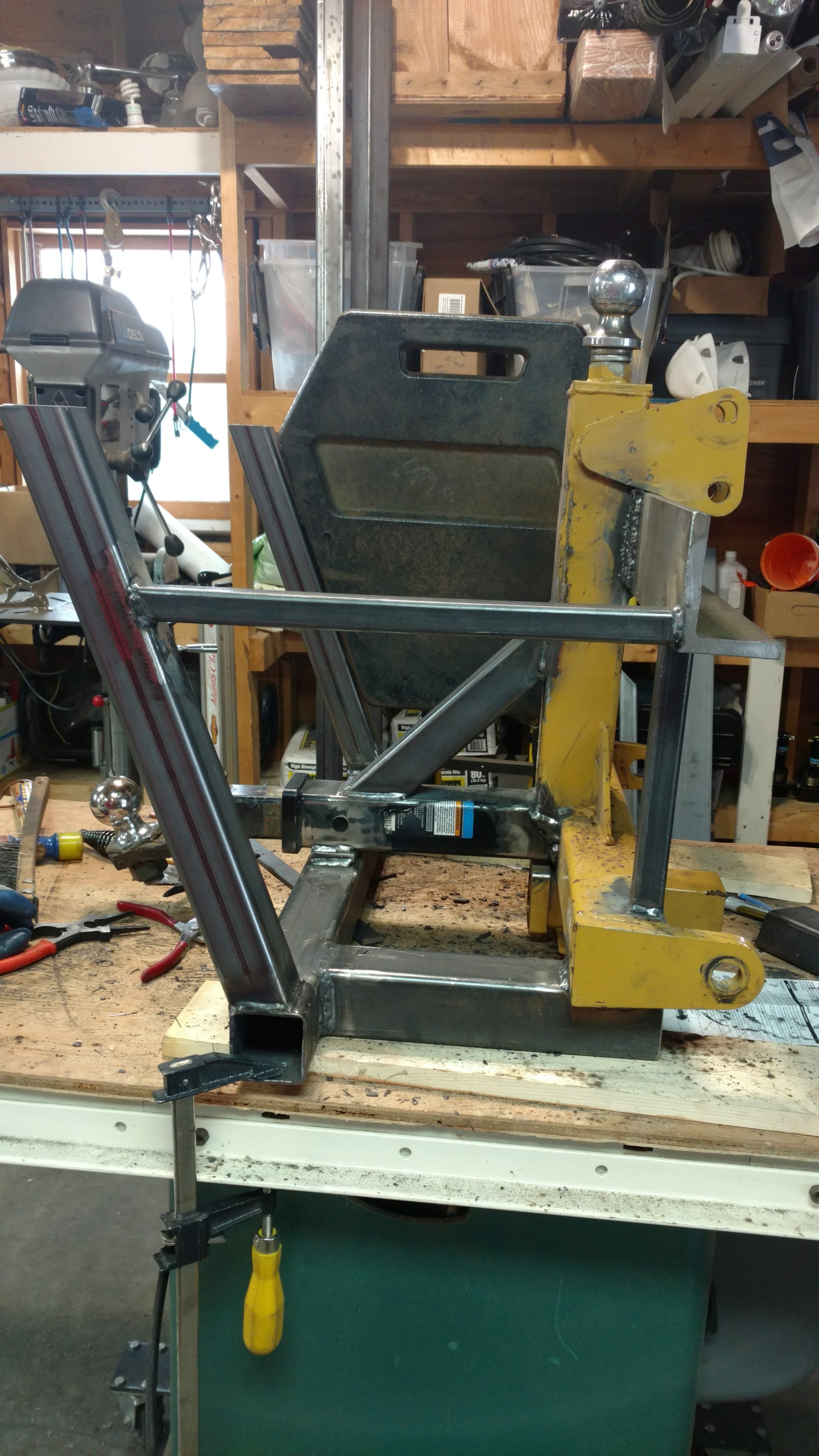

Then I welded some 1/2" thick angle to the old trailer mover to hang the racks on and fab'ed a base to keep it up right:
About this time I realized the hitch receiver would be too short and I was going to loose the box on top of my old ballast box. :confused2: I really needed the rack to be ballast, a carry-all box (that can hold long handled tools), bumper-pull AND gooseneck trailer mover... I also wanted to protect the weights some for when I accidentally back into crap... I also wanted to be able to see the trailer ball when hooking up bumper pull trailers (hmmm won't the box be in the way?!)... I also did not want to put a lot more money in this thing so I used the stuff I had. Ok, this was supposed to be quick and simple! :confused3:
So I extended the hitch receiver and supported it better, added some "bumpers" to protect the weights.

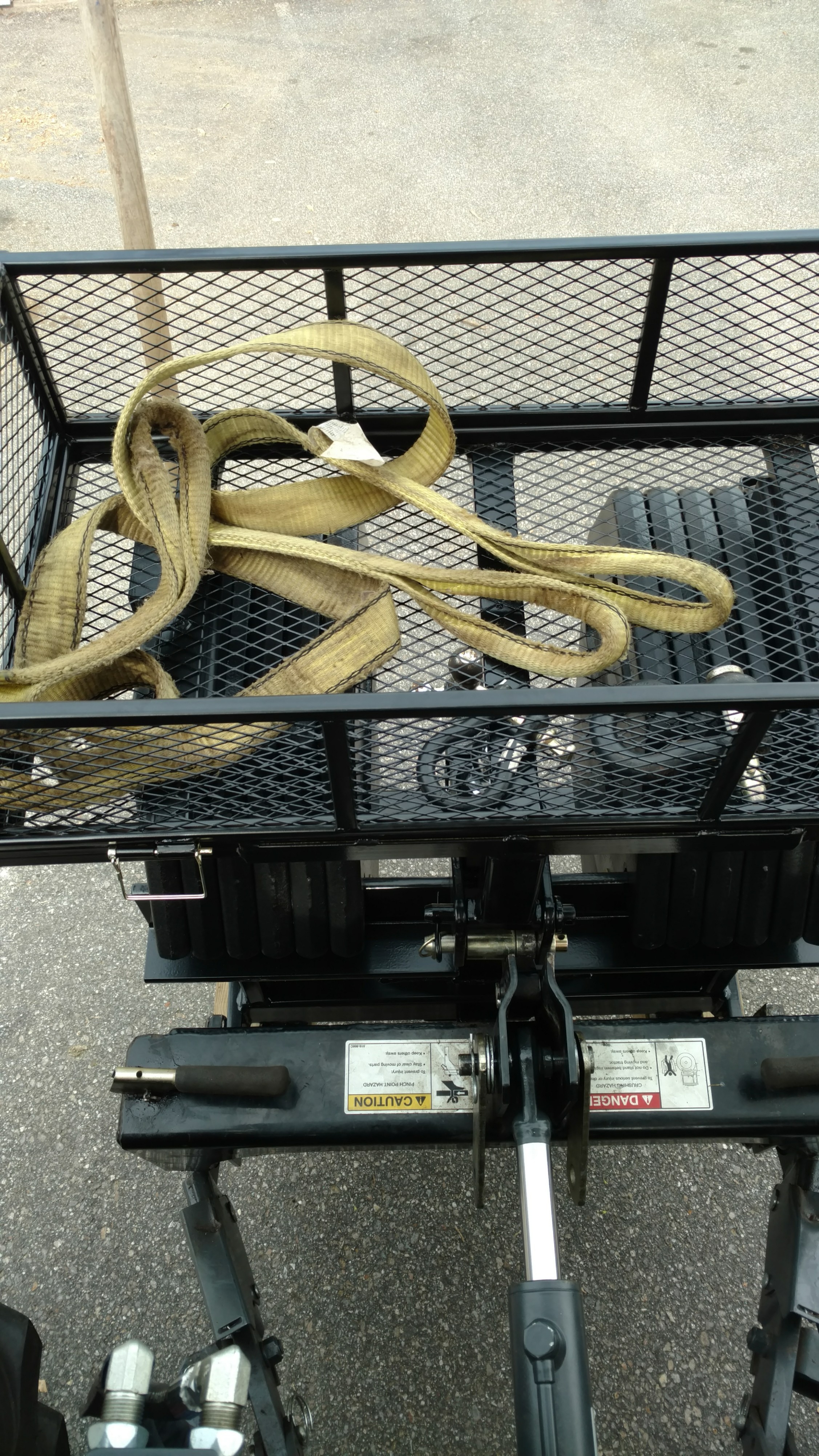

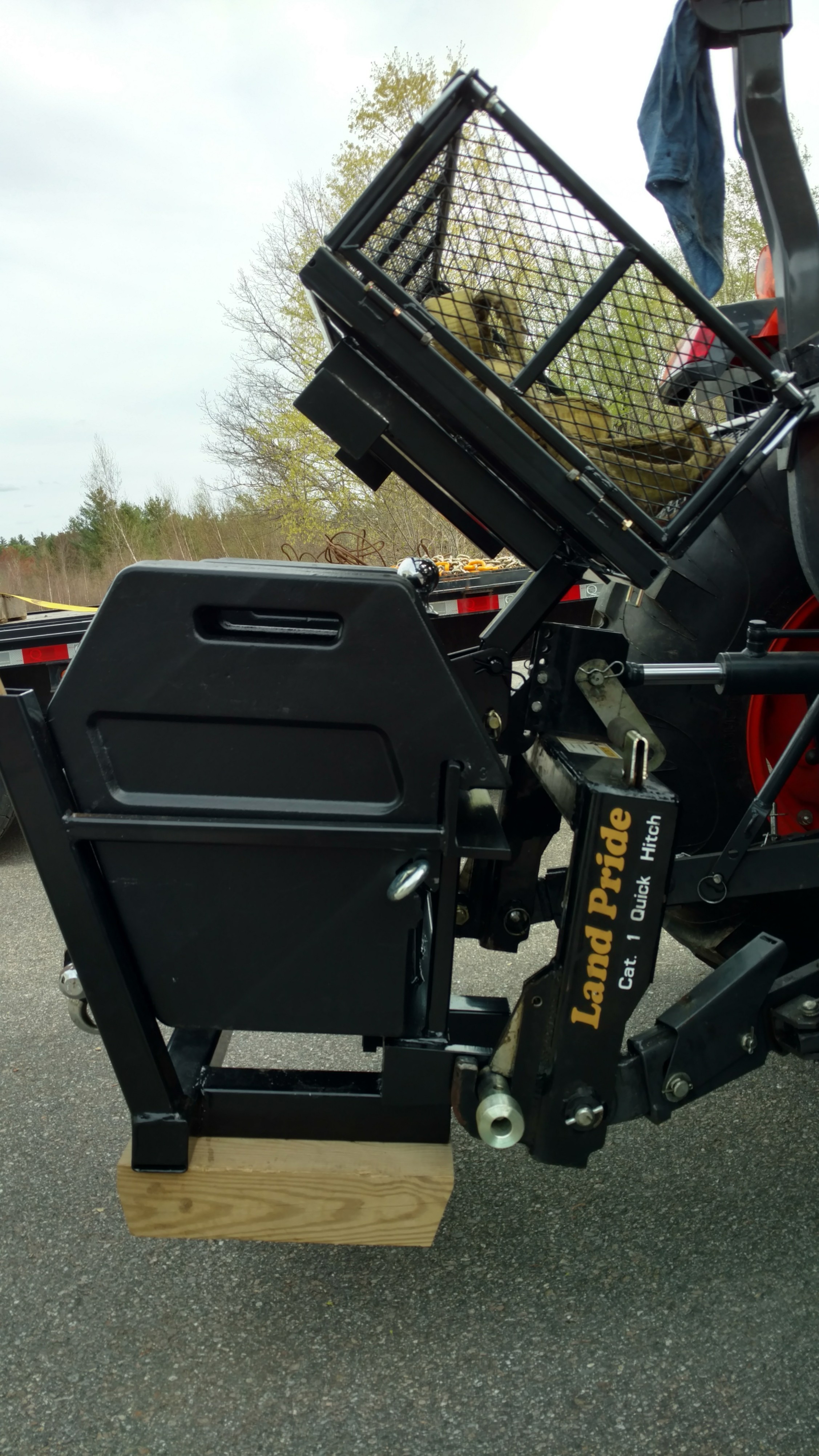

Now to move on to the carry-all box: I "re-purposed" a cheap Chinese garden wagon my wife never uses (she won't miss it right? Wrong. - but that's another story :censored:). I figured out how to mount the wagon "basket" on top of the weights where it can be flipped up out of the way to remove weights, comes off with one pin to use the gooseneck ball, AND is see-through to see the bumper-pull trailer ball! I was pretty happy with my creation at this point so I wanted to paint it. I also realized this was going to be a huge PITA. Tons of little surfaces, old powdercoat and paint, rust etc. So I decided to put MORE money into it and have it powdercoated.

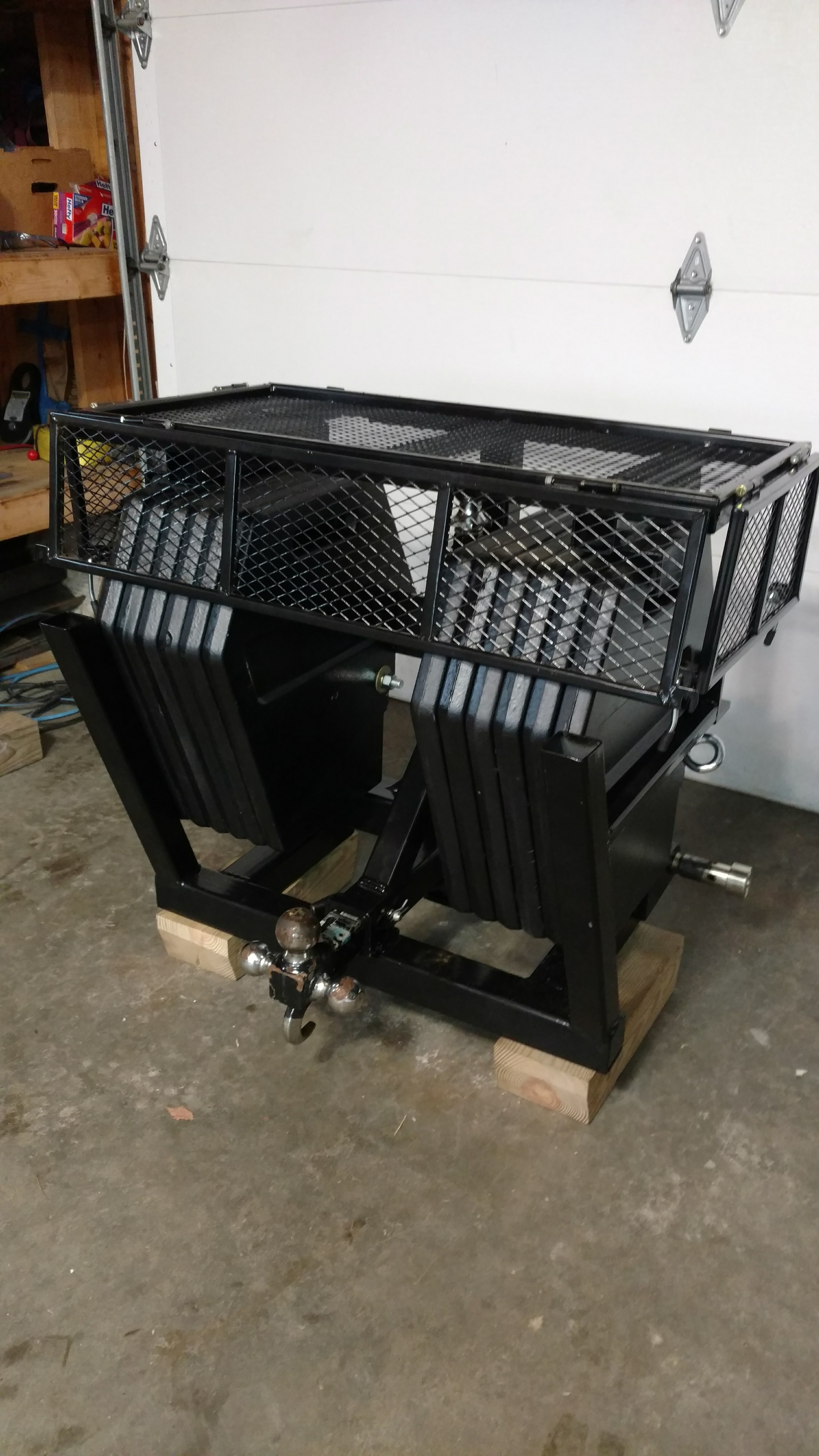

So for $300 the guy gave everything an acid bath, sandblasted, epoxy primer, and flat black powdercoated everything (except the weights). Looks good to me. First time I've had anything powdercoated. I weighs just about 1300lbs.
   / Franken-ballast: expensive and poorly planned! #3
I like it but don't back into your car with that thing. It would be like a giant can opener. Did they powder coat your blink on the lip? People pay to have that stuff done.

Like a Swiss army knife for a tractor . Nicely done. Like it.
   / Franken-ballast: expensive and poorly planned! #7
This really is a great job and useful. More guys should do this rather than load their tires.
Weight on; weight off. Weight on: weight off. It's that easy and makes the tractor so much more versatile.

I would way rather have a useful implement that also serves as ballast. My backhoe serves as my ballast. My tires are also loaded, but I've yet to find a use in which I wanted them to be unloaded.
