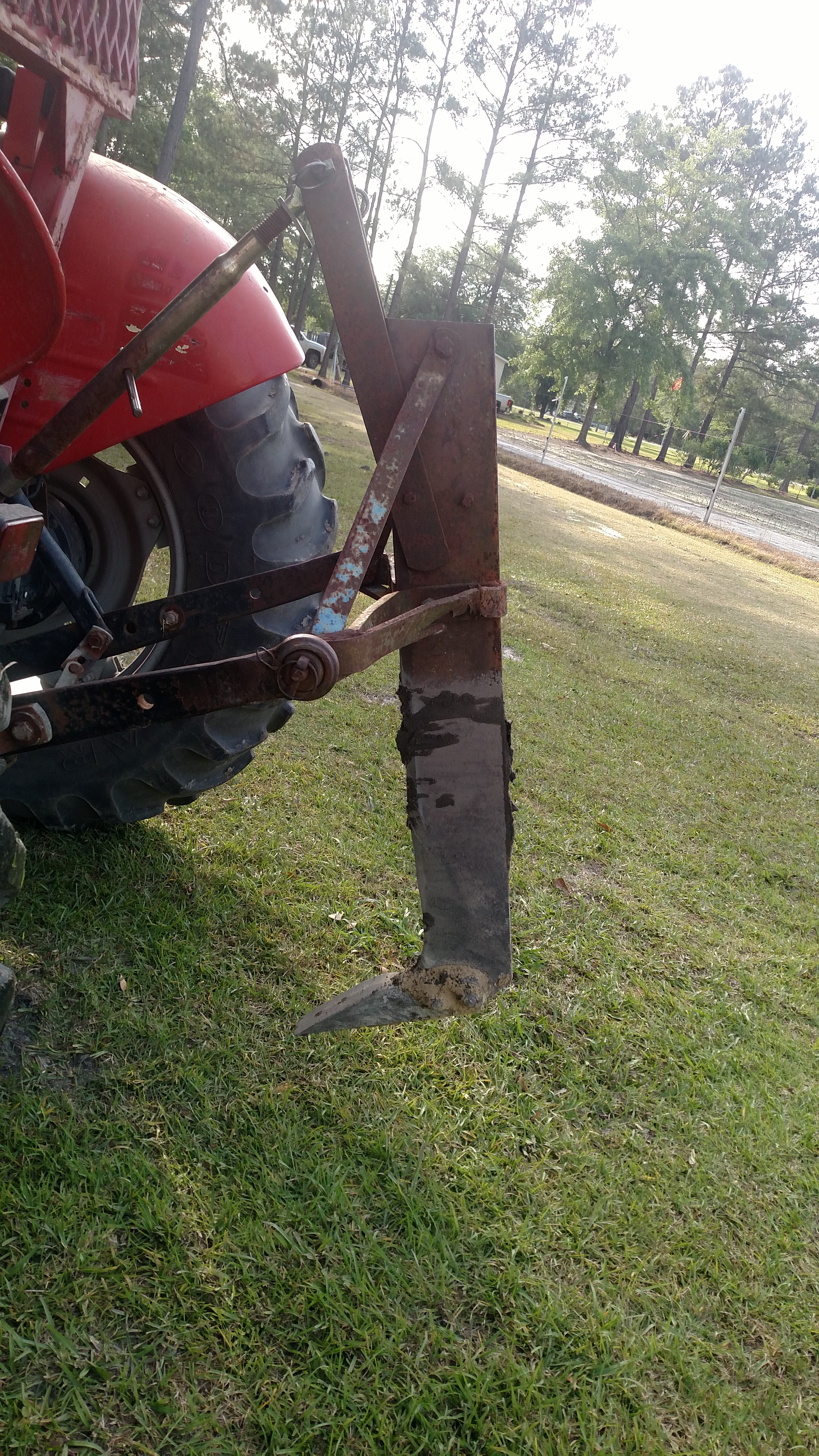

Now that sure looks like it has seen some use. What is nice about yours are those two back braces that help keep the cross-member from buckling.
Believe it or not, took off some scrap steel to the junk yard, ended up swapping it out for the sub soiler and some cash.
Somebody actually sent it to the yard!!!!

Now that is awesome.....WTG !
Hey, what is that apparently very thin metal on the tooth? Seems like if you hit a good root or rock it would bend it up in a hurry.
   / Franken-Tooth Root-Stump Puller, V1.0 #14
It's not thin, it's just sitting down in the dirt in that pic.
Courtesy of some fire ants building a bed around at some point.

Better pic of the tooth after some subsoiling.
You can see where the grapple at junk yard pinched that back brace.
Seems to still work fine

Very nice. Have you ever used it to rip roots and stumps out or do you use it more for trenching etc?
   / Franken-Tooth Root-Stump Puller, V1.0 #18
Both, so far I've managed to stop the MF in 1L and pick front tires off ground with lift pulling on big stumps. Tractor weighs in around 6300# with all the extra weight..It's a strong subsoiler.
