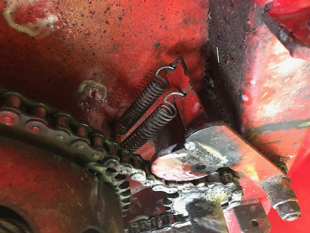

Jul 31, 2018 / Fransgard 4000 winch tensioner Fix? Thread Starter #11 OP R rogdan Gold Member Joined Sep 2, 2004 Messages 273 Location West Virginia Tractor Farmtrac 360 DTC TLB How can I tell the condition of the roller chain and if it needs replaced?
Aug 1, 2018 / Fransgard 4000 winch tensioner Fix? #12 A Agvg Elite Member Joined May 25, 2013 Messages 2,918 Location Norway Tractor Mf135, Ursus C-355, David Brown 995 Take it of and check the slack side wise, be very care full if you lubricate it, it's best taking it off clean, let it submerge in thick oil then hang it up and let it drip off for 24h.

Aug 12, 2018 / Fransgard 4000 winch tensioner Fix? Thread Starter #13 OP R rogdan Gold Member Joined Sep 2, 2004 Messages 273 Location West Virginia Tractor Farmtrac 360 DTC TLB Well the chain seems to be tight as well as the bearing so I think this is the only repair I need to make. Thanks again for the help Attachments two.jpg 134.8 KB · Views: 61 one.jpg 127 KB · Views: 80
Aug 12, 2018 / Fransgard 4000 winch tensioner Fix? #14 A Agvg Elite Member Joined May 25, 2013 Messages 2,918 Location Norway Tractor Mf135, Ursus C-355, David Brown 995 Looks nice, you have some logs to pull before you have to redo it
