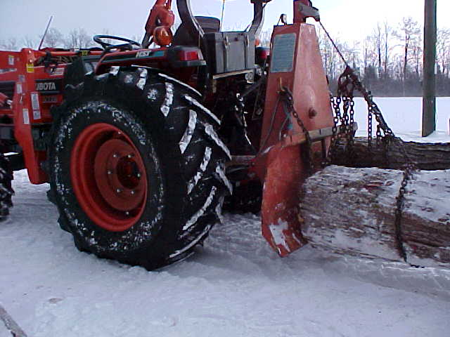

In the years that I have follow this site on an off never heard much about winches for logging, since this is what I use my tractor for the most I though I would post a few photos. And also remind any one who would like to get one that you can only pull so many logs at one time, sometimes one tree may be to much!!

I have been using mine and love it,I wish I had bought it last summer before I started logging.It would have saved me so much time and wear and tear on my tractor.
