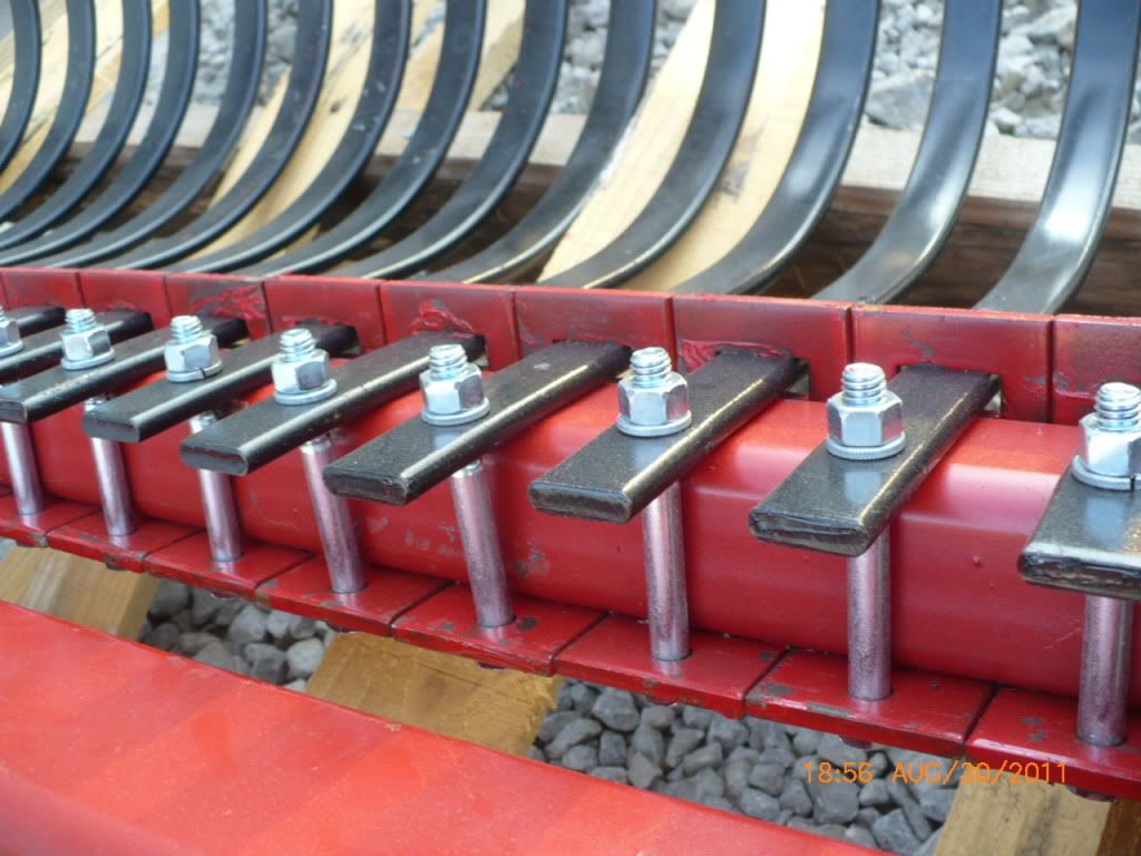

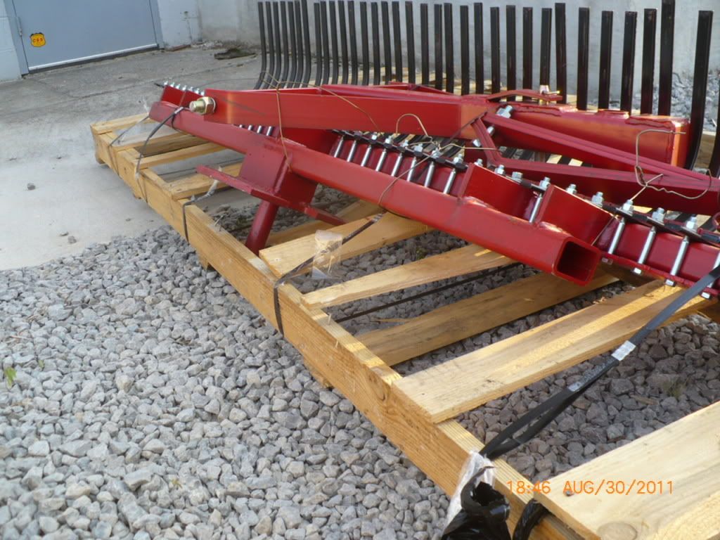

Well got my 7' Fred Cain Landscape rake today. Purchased it from Sweet Farm Equipment in KY. Well it was somewhat scratched up from shipping, the pallet it was delivered on was too weak and broke in several places. The nut that attached the rake to the 3 point frame had been dragging the ground for a while.

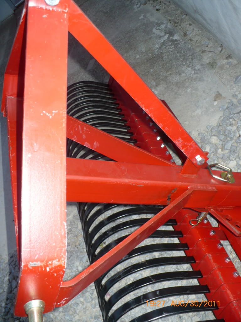

I can live with a few scratches but the paint job on this thing is horrible. I am disappointed with that. :(

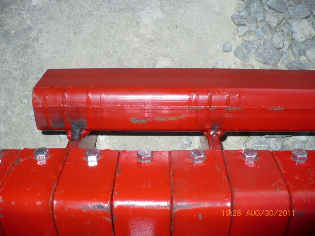

I know its not a show piece and will be worked hard but for what I paid for it I would expect it to look nice and new upon delivery. Its almost like the metal was not cleaned before it was painted.

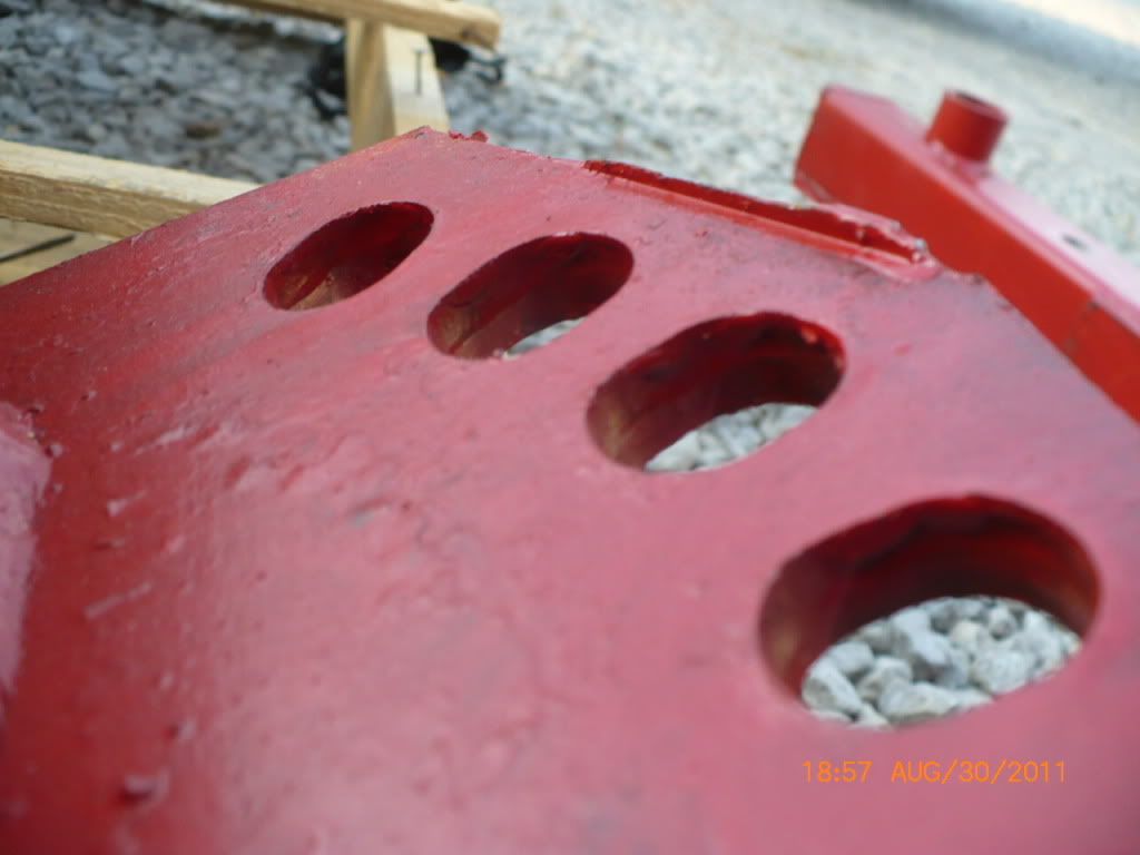

Now to the lip I will have to grind down for the rake to rotate properly.
Its not too much to ask that you don't have to work on a brand new attachment. Maybe I am being too picky. It is well built but the finish should be way better.

You're right but the workmanship looks like crap. Burrs from sheared edges, (btw, those are excellant finger slicers, usually they're like a razor) lousy looking welds, the paint was put on using a mop by the looks of it. Not impressive at all......Mike

The finish does look bad and looks like finish clean up was not done. :( Other pictures that I have seen of Fred Cain rakes did not look like yours. But what you paid is not a high price, go price out a Woods or Land Pride. I believe that those would be up over a grand. :eek: Hopefully Sweet will do something to help you out.

I have a Fred Cain rake and there is no shear edges sticking up like yours. The paint is not great but most of the welds looked fair but none of the equipment I have seen has a great paint job. They dont seem to abrasive blast anything and maybe not even remove the oil prior to splashing on some paint. The one thing that I found on this rake is that the shaft where the rake attaches is a bit long from the side brace points which makes it rather weak and easy to bend which I unfortunately did to mine. Ihad to cut off all the bracing and the old square tubing and replaceds it with a heavier tubing that is a few inches shorter. The tubing has no need to be that long anyway as you can't rotate the rake 180 degrees with it hooked up anyway. It took me about a half day to remove and replace the box tubing, but now I have a much stronger rake than originally designed and after degreasing and power brushing the new parts, I have a pretty decent paint job on the new stuff.
The tines on this rake are pretty tough also. I have backed into trees and bent them up pretty bad, but you can straighten them without them breaking. They have enough spring tension to pull a big load of dirt without bending, but are ductile enough to enable you to pound them back into shape if you accidently hit an immovable object. Overall, I would say mine is worth the money I paid.
