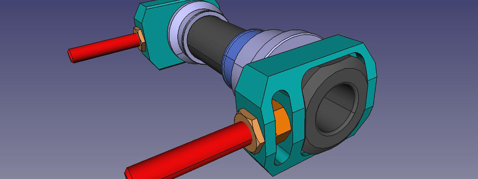

For the ability to do 3D, then the OpenSource FreeCAD is the best value. FreeCAD: An Open Source parametric 3D CAD modeler FreeCAD even has the translators. A big plus doing the 3D to part for home or hobby use. Even making drawings with tolerance clearances are easy.
