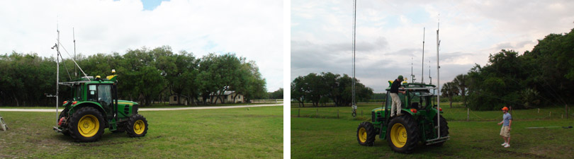

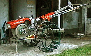

Here are some 80/20 tractor items I had just skimmed via StartPage Images

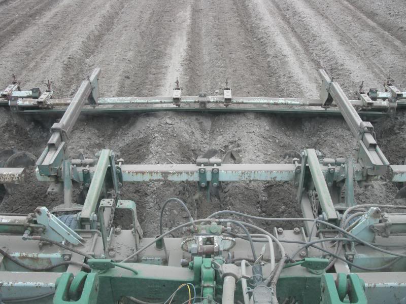

Here is a implement with repairs using the 80/20 structural stuff.
