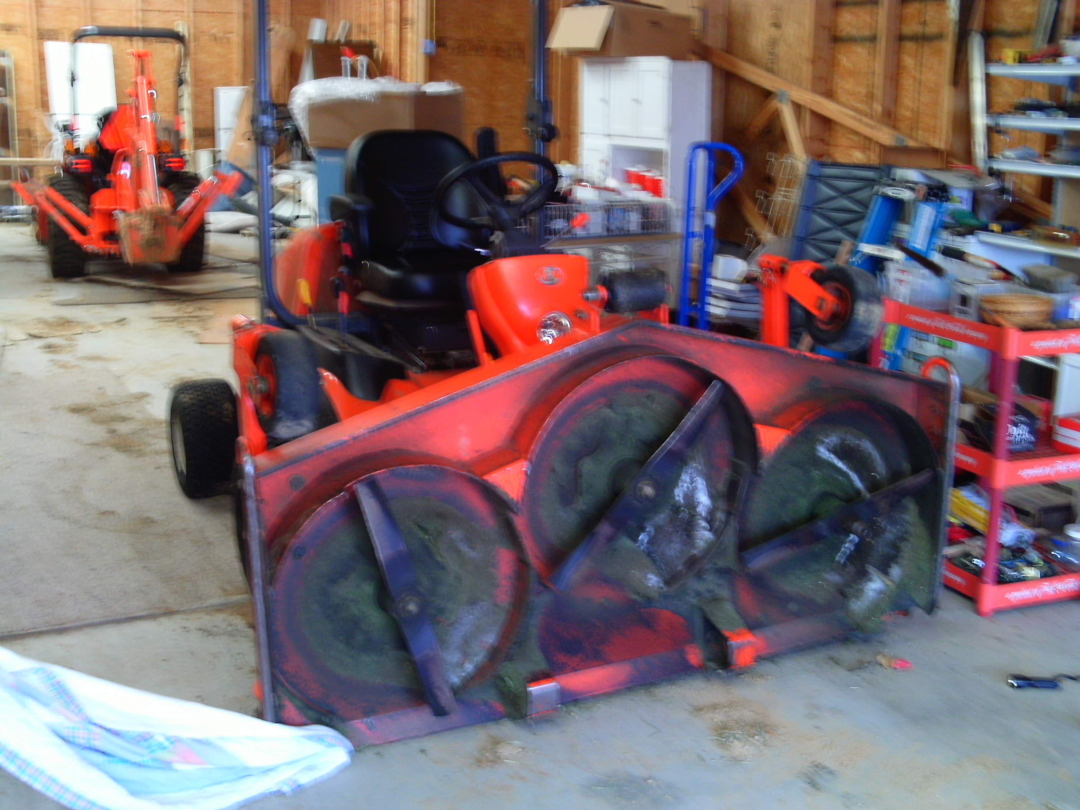

Here's where my new blades are going. Also found a bad part when I changed the blades on my new F3080 that I bent a blade on so Barlows is getting me a new part under warranty. Like free parts. I have compressor, air gun but no 30MM socket but Jerry did so he figured he had to take my blades off for me. I also bought a socket at Barlows for $10 30MM that I'll have at home. 2 bottom plow is for sale or trade.

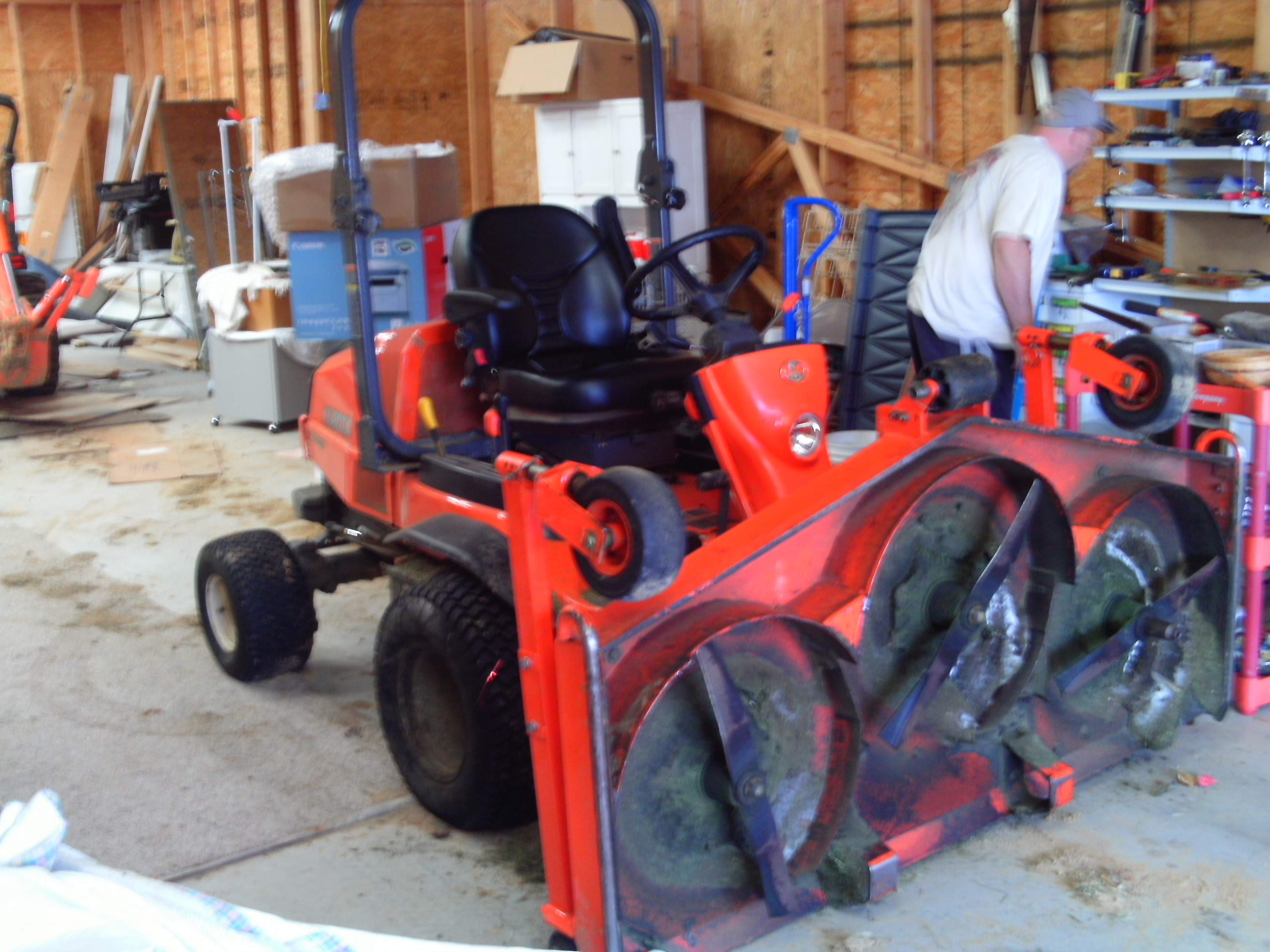

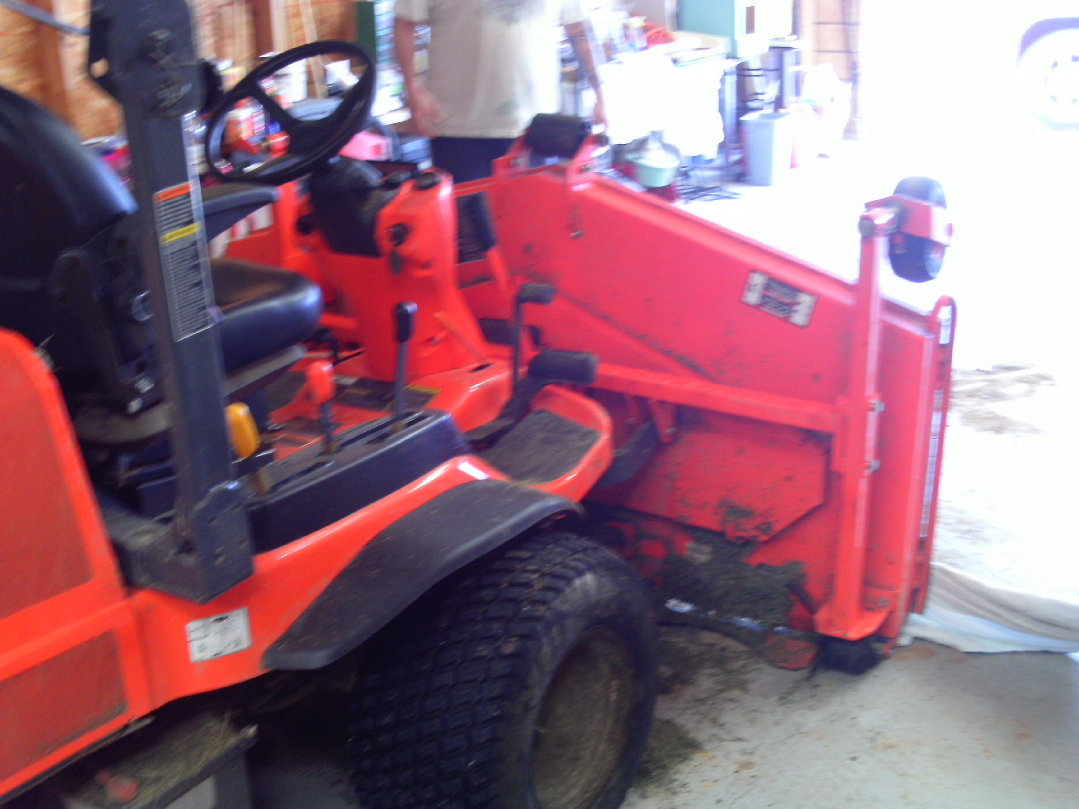

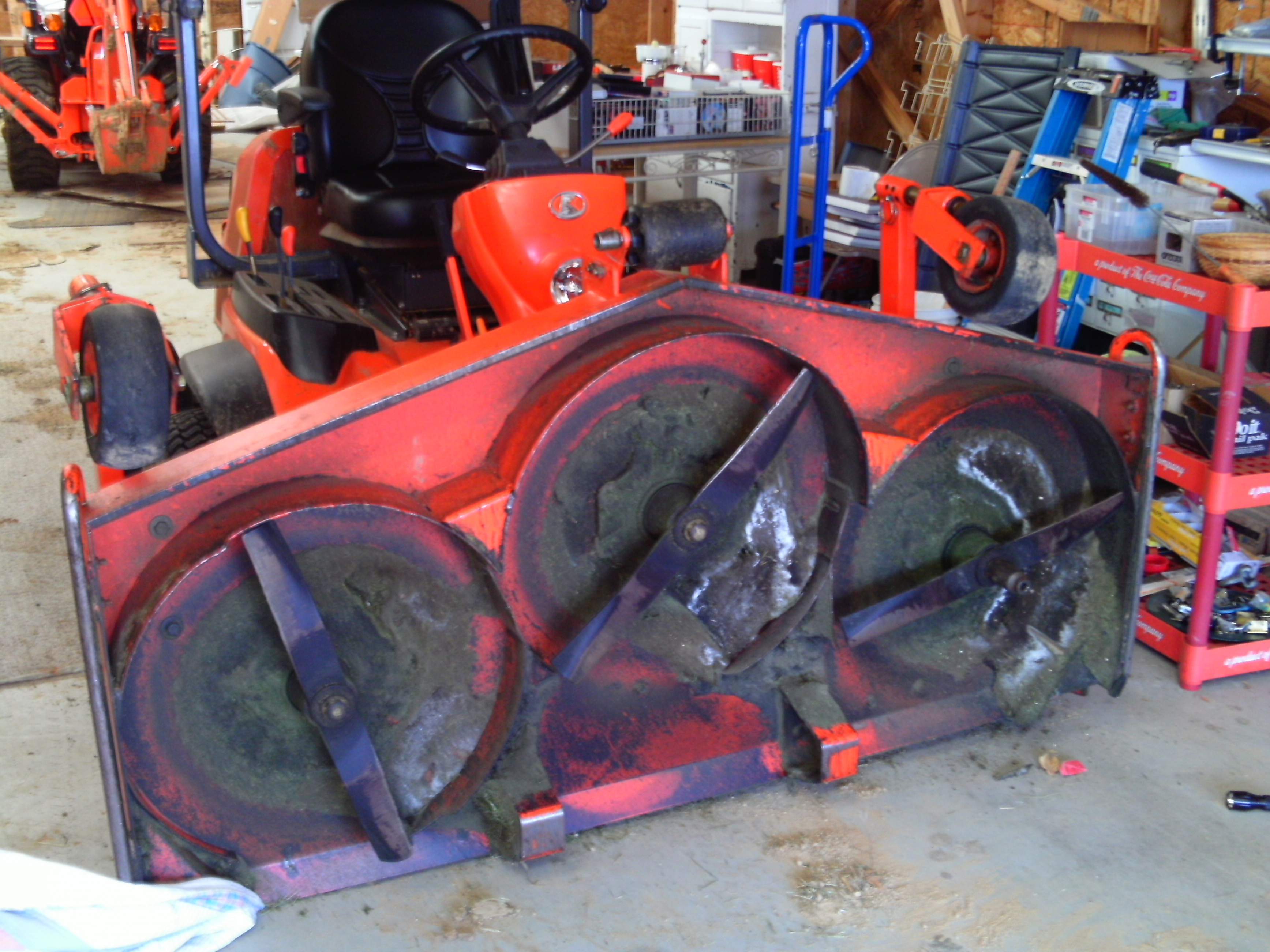

You do NOT have to disconnect the drive shaft to raise the deck. I missed pulling the 2 spring loaded pins that attach at the rear levelers and couldn't get it to lift soooo I pulled the round collar off at the drive shaft connection at the machine end just like on the MMM decks on other Kubota models but it didn't help until I pulled the 2 spring loaded pins. I have 2 of these mowers and I just replaced the blades on my new one 2 days ago but forgot how I did it but knew I didn't release the drive shaft. This one in the picture is 4wd and I've had it for about 3 years and I bought another one 4 wd for home use this year and I sold or traded in the 2wd F2680 that I had been using for 4 years on the flat rental property. Guess you can see that I really like them to the tune of having bought 3 over the past 4 years and currently have 2 that I do all of my mowing with them. They aren't cheap but they are the finest mower made.
To raise deck there are 4 spring loaded pins to pull, one lever that is stored on the deck is inserted into a slot and pulled or pushed to release tension on a shock like on car trunk lids and one more spring loaded pin is released to fall into place when you lift the deck to keep it locked up. 5 spring loaded pins and a lever and lift.
