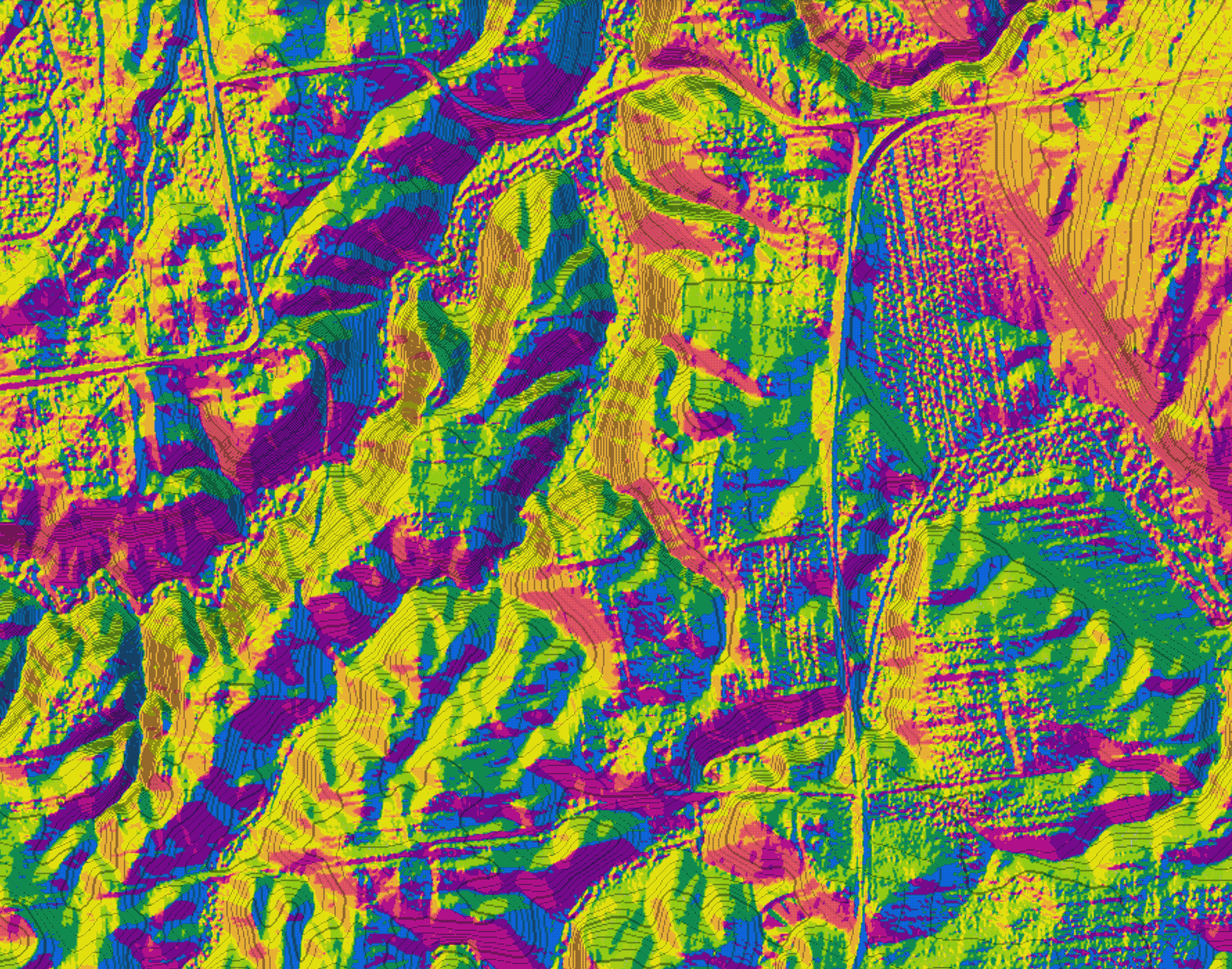

One hobby for me is analyzing old road maps and overlaying them over images of the modern terrain using various imagery such as aerials and especially Lidar images. Ive found that the Procreate app ($20) on an aging iPad Pro and the Apple Pencil give great utility yet are fairly intuitive to use. I like to capture images from the National Map as screen shots and import them unaltered into a Procreate project as layers. The National map provides many layers itself such Lidar, wetlands, a variety of base aerial images or maps including older topo maps that can be adjusted by transparency or moved up or down. I can geo-locate and pin coordinates on the map. In regards to lot lines I avoid the GIS online offering by the County and use the .aspx extension maps and convert them to pdf so procreate can see them. The challenge is to size and the lot lines map over the Lidar and other data accurately and working at a scale where even a small offset can convert to many foot of error.
I took a few minutes and grabbed a sampling of data of a nearby area I was researching to see if evidence of an old road that no longer exists shows up (you can see the road a little left of center in some of the images) and overlaid the data with the County aspx file for that area and exported them from Procreate as a gif here. Included is lidar (hillshade stretched) with auto contour lines, a couple of the base maps available, multi-directional Lidar with catchment detail (light pink lines) that shows drainage areas, aspect map (the colorful one).
Note that not all areas have Lidar of this quality, so your mileage may vary.
