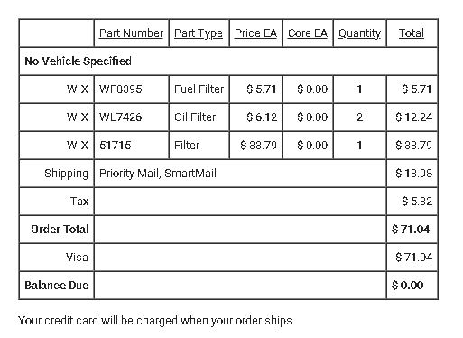

I have some thoughts on this. When I serviced my tractor, I didnt use LS brand filters. I used Wix from RockAuto.
Fuel Filter - Wix WF8395 paid $5.71 Legacy Tractor has it for $58.11 LS Brand.
Engine Oil Filter - Wix WL7426 paid $6.12 Legacy Tractor has it for 21.10 LS
Hydraulic Oil - Wix 51715 paid 33.79 Legacy Tractor has it for 48.02
I didnt change the air filters (just blow them out), and shipping from Rockauto was $13.98 plus tax, comes out to $71.04 (bought 2 engine oil filters).
If I was to purchase these filters from Legacy Tractor, I'd spend $148.33 plus tax (that counts two engine oil filters.) But, I dont pay shipping...
There is something to be said for using branded products, but I dont believe this is a good opportunity for the filters I use. Wix filters are great and using off brand filters does not void warranty.
