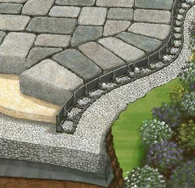

I would be afraid that the pavers near the downhill side would eventually start drifting/slanting down the slope. Do you plan to have a curb or retaining wall on that side? It would provide a clean edge too.
