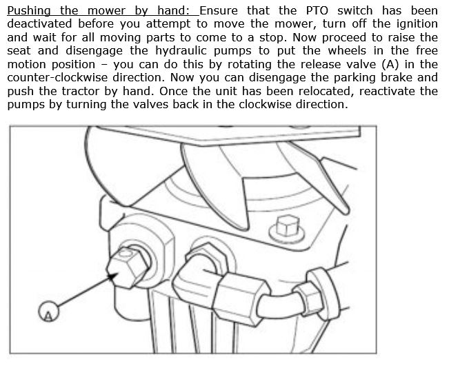

Is there any trick in turing the shaft that is supposed to switch between freewheeling and drive on a hydrostatic drive? I have a Ferris ProCut 32 and the hydraulic pump belt gave out just after my wife drove the mower out of the barn. I would like to get the mower back in the barn but I need the drive wheels to freewheel. I found the shaft on the pump that needs to be turned. I have tried turning it with channel locks and locking pliers and it won't budge. It does have whole in the shaft the size of a #8bolt. I put one of those in and just bent the bolt. The manual just shows a diagram but does not describe having to do anything special to turn the shaft. Is there any trick to turning these shafts or is this one just stuck?

Do the tow valves need to pulled out vs turned. I have seen some that get pushed in, some that turn, some that pull out. I would try pushing or pulling on the tow valve to see if they move.
   / Freewheeling Hydrostatic drive #6
According to this, it's suppose to turn counter-clockwise.

Maybe it's locked under some sort of hydraulic pressure? Maybe it's just stuck. I'd try cracking some of the hydraulic fittings on the pump, to let off some pressure on the pump if there is any.

No. Typically it's just an on-off valve. On my old Grasshopper and on my new Bad Boy, they are pull valves with clips to hold them out.
