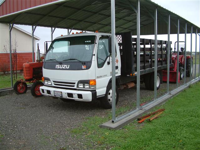

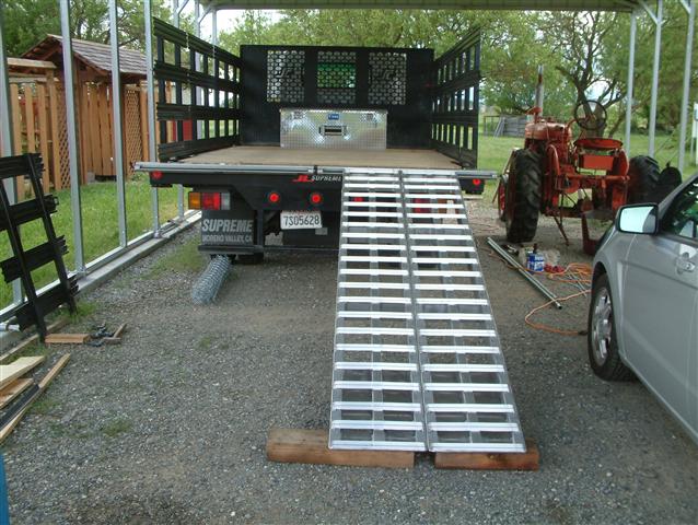

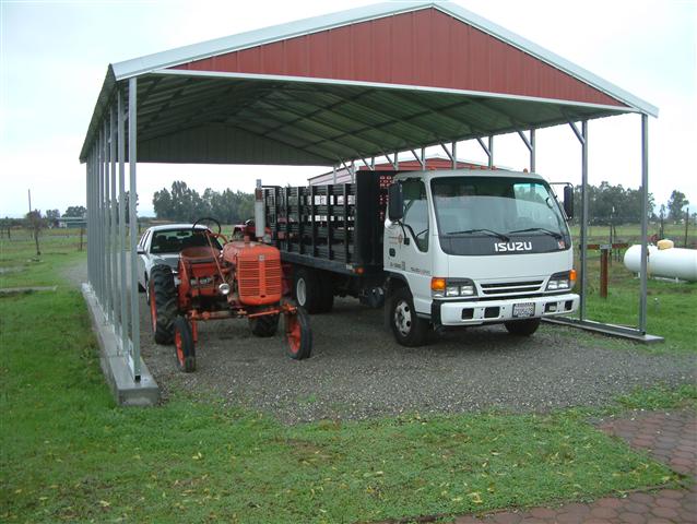

That's what I did after beating my head against the wall for nearly two years trying to find a decent, affordable used 5-6 year old 3/4 or 1T pickup, diesel or gas to haul my parade tractors (3500 lb max). I finally bought a 2004 Isuzu NPR/EFI stakebed (8x14 ft bed by Supreme) with the GMC/Chevy 6.0L LQ4 V-8 gasser and 4L80-E 4-speed automatic ($11K, 49500 miles, found it on eBay--owned by a tile company that went belly up).
A few 10-ft aluminum ramps and I'm in business. I really like the classic lines of that NPR tilt cab design.

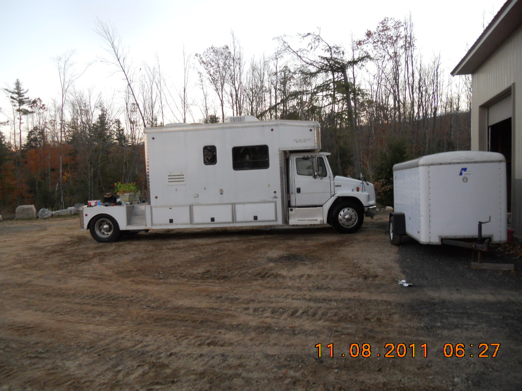

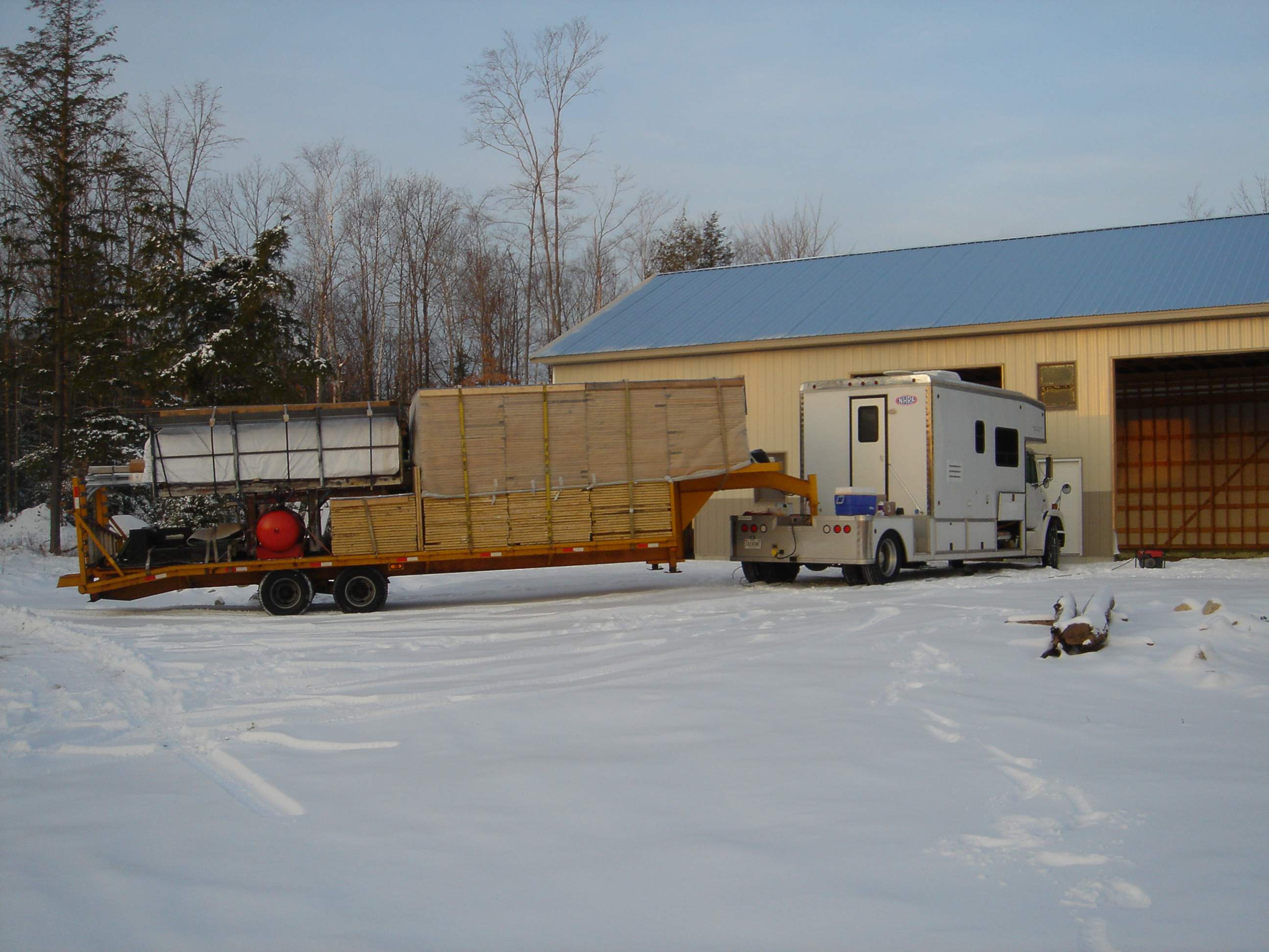

I have a FL70 with a 3126Cat & Allison AT, it's a 33,000 gvw truck and it has a little 14' living area behind the cab. It is a real nice tow vehicle. It was taking forever to download your attachment so I'm not sure if it had a price but they are nice (the Sport Chassis) but the ones that I've seen are spendy for mostly a single purpose vehicle. These trucks are built several times heavier than any of the "heavy one tons" (450-550 or Dodges versions) and are designed and expected to go several 100k easy with prolly a whole bunch more load and abuse than you or I would ever subject them to. The numbers on the "baby Cat" C-7 (7 liter) for HP are low but I think that the torque is better and will pull you deep into a hill before a downshift. Mine is about as aerodynamic as a brick and I get about 7 mpg, with a load as in the pic. If you are not going to pile on the miles, it might not be worth it because of the limited "audience" when it comes to resale time (as compared to the 450/550 senario) The other concern is with the sport chassis, you might get into CDL territory. Mine is built and registered as an "RV", side stepping the CDL and scales! It (mine) clearly is a "camper", just a weird one. The sport chassis that I'm thinking of is a overgrown PU tk. with a high GVW that with your trlr. will deffinetly warrant a CDL. (as far as I know) Good luck
