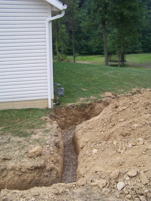

Here's pics of my latest project. In order to cut off some of the water coming off the hill towards my house, I dug a trench 12" wide by aprox 150' or so. It ranges in depth from 20" to 40" obviuosly sloping toward the rear of the house. I used 1 4" perf. pipe wrapped in a sock that ran the length of the ditch in a bed of #57 river gravel about 3-4" deep. I covered the pipe with the #57 gravel to within 1-2 inches of the original grade. Here's some pictures hope it's not boring. The NH TC24DA and 756C hoe saved a lot of work!
   / French Drain Project.
#2
Facing toward the front of house.

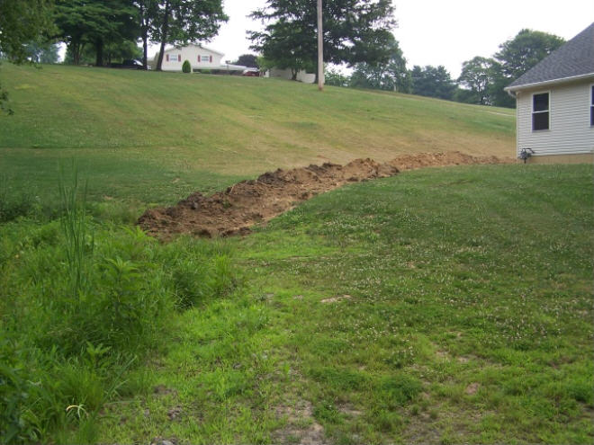

A little "jog" to catch the spouting line. This was run through solid line separately in the same trench.

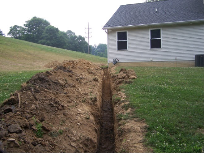

This is facing towards the rear of the house were the grade goe down hill.

Another shot of the grade change in the rear.

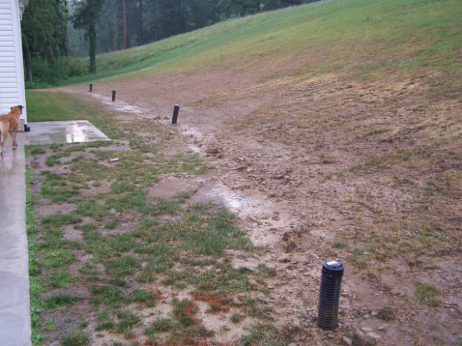

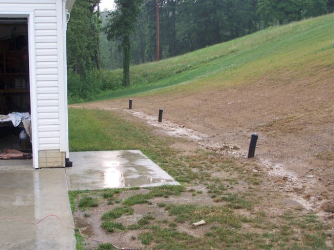

Sorry there were no pics between the open trench and the finished project but mother nature was on the way. Here is just after being done. We ended up with 2 inches of rain in about 45 minutes. This usually would have been a river and had standing water, however this project ended all of that.
Another shot. This worked pretty good, in fact like a dumb a** I went out in the middle of a nasty T-storm to check the end of the pipe and it was flowing very well. The pipes sticking up every 20' will be for surface drains/grates after the grass returns and I get the top soil moved in and the swales made.
