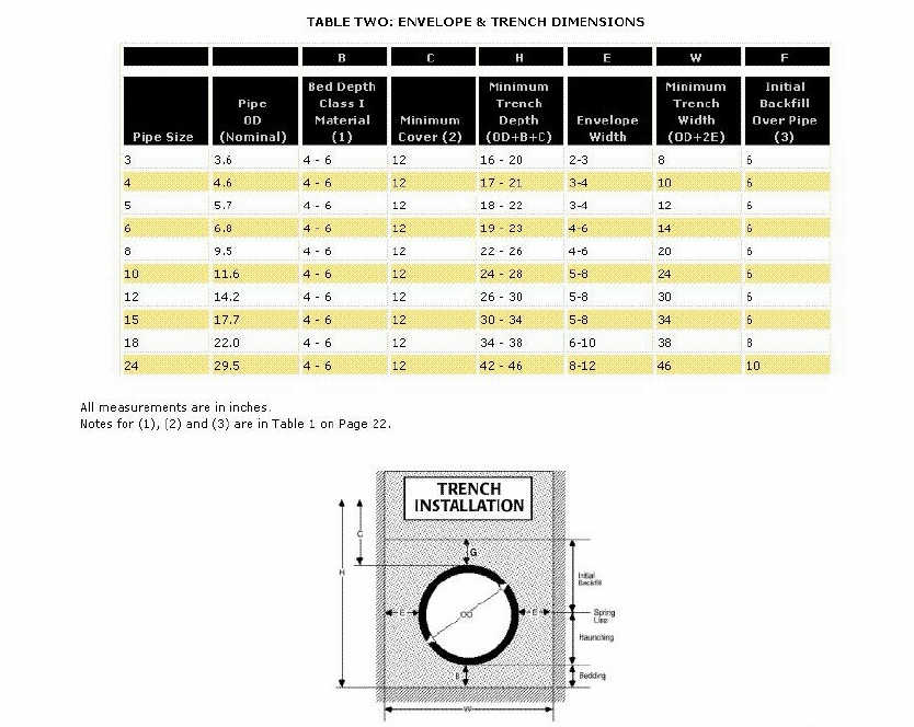

Does width of trench really matter? I ask because rather than dig a big trench with a hoe I can use a chainsaw type trencher and run the pipe quickly and cheaply. Less gravel too. Would want a wide enough trench to work in though.
My boss engineer actually recommends sand as backfill since the surrounding soil is less likely to migrate into the gravel voids and plug it. The sand could be run clear to the surface to pickup surface water more effectively.
Socked pipe seems to be ideal but I'm sure the cost is higher than socking your own.
/ French Drain Project. #19
I don't think that applies to what I meant. Does the width of the trench matter in terms of the pipes ability to dewater the site? Constructability and proper bedding of the pipe being a seperate issue. The reference gave me a 22 inch trench for 6 inch pipe.
/ French Drain Project. #20
The trench width should be no wider than what is represented in the attached table, except as necessary to construct the trench or install the pipe. According to ASTM D 2321, the trench width should be no wider than what is required to safely and conveniently compact backfill material on either side of the pipe. As I understand it, in clay soils you do not want to make wider trenches, rather, you will need additional drain line laterals. More info HERE.
