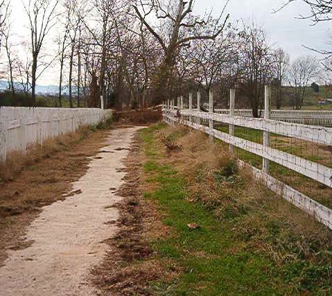

I bought this piece of property and house for a great price with one small(some may call it huge) problem. It is in a flood zone. Some folks may remember the pics I posted from last Feb. When I first walked through the place I had ideas of where I wanted to build some drains; however, I waited until a few rains to get an indication of the problem areas. The former owners had cattle, so they poured concrete in alot of areas so they wouldn't get stuck in the mud. This pic shows a long run of concrete which becomes a river when we get alot of rain, at the end of the run is the creek where I want the water to run into. The right side of the fence is my orchard. I live in East TN, the old timers around here say they have never seen it rain as much as we have had this past year. Figures, cause I just bought this estate in a flood zone; which I always thought "how stupid can someone be to purchase a place in a flood zone."

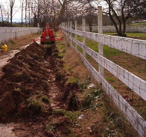

I bought the BX22 because I didn't need anything bigger and I knew I would use the BH a great deal. This little machine really does alot of work and I am having a tremendous amount of fun while I am so-called "working". I wasn't too cautious of making this ditch straight. I was more cautious to keep it gradually getting deeper in grade. I first wanted it wide enough to put three 4" pipes but opted to use only 2.

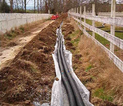

I wanted to take more pics as I progressed thru this project but I worked on it between the rains and my other work schedule. I didn't remember to take pics until it was too late. I probably should have put three pipes in the ditch and I hope this doesn't come back to haunt me. I also wish I had only made the ditch one bucket wide, my bucket is 12". The fabric I used was 3' wide and 120' long. I had to buy some more fabric, only 1' wide, to put across the top after installing the rock. The fabric would have overlapped if I dug the ditch one bucket wide. Oh well, it will take more water this way. I have the drain all covered and graded but again, didn't take pics and it is under about an inch of snow now. I used almost 300' of 4' perforated drain pipe, 2 1/2 tons of gravel and fabric. The fabric was almost half the price of the entire project. The pipe was around $75.00 nad I have about 50' feet leftover. The gravel was $10.00 a ton, I hauled it myself. The small BX22 FEL fit right up into my truck bed, I could get most of it with a small amount of shoveling. The fabric cost around $60.00 and I have some leftover. My next project is drain the water from my downspouts into the field.

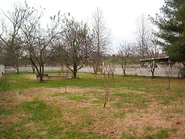

This is a picture of the orchard, which is on the opposite side of the fence from the drain. I done alot of work to this orchard and it still needs a great deal of pruning. The orchard hadn't been taken care of for about 7 years. I have 8 apple trees and 2 pear trees. There are some smaller newly planted trees which i still have to find out what they are.
