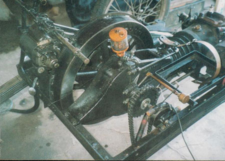

Here's a picture showing one of the oil cups...
This engine is modified with electric start...
