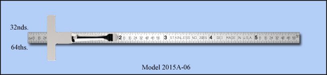

After initial adjustment is accomplished, I set the springs with a feeler gauge. This will give equal pressure on all of the springs.

A method of increasing it one small step at a time until it just doesn't, or only rarely slips, is the best IMHO. Once you arrive at a good setting, you can use one of these to easily reset each of the springs to the same place.
