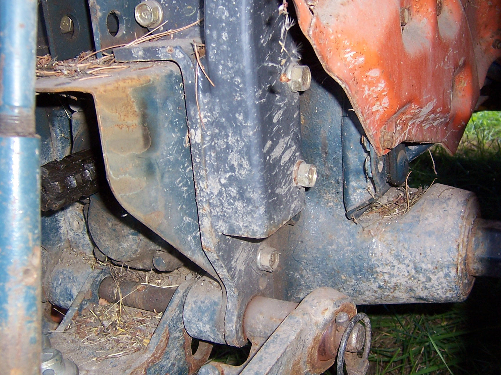

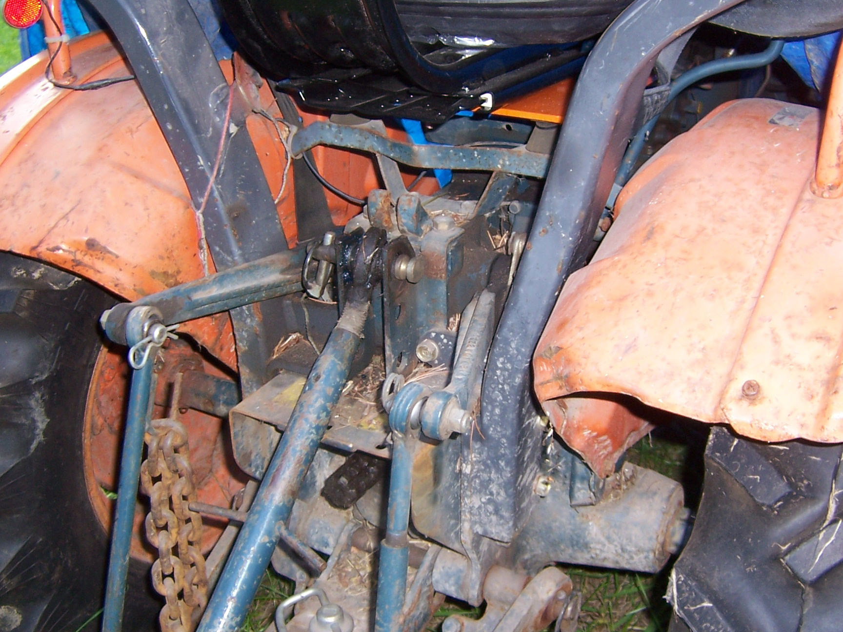

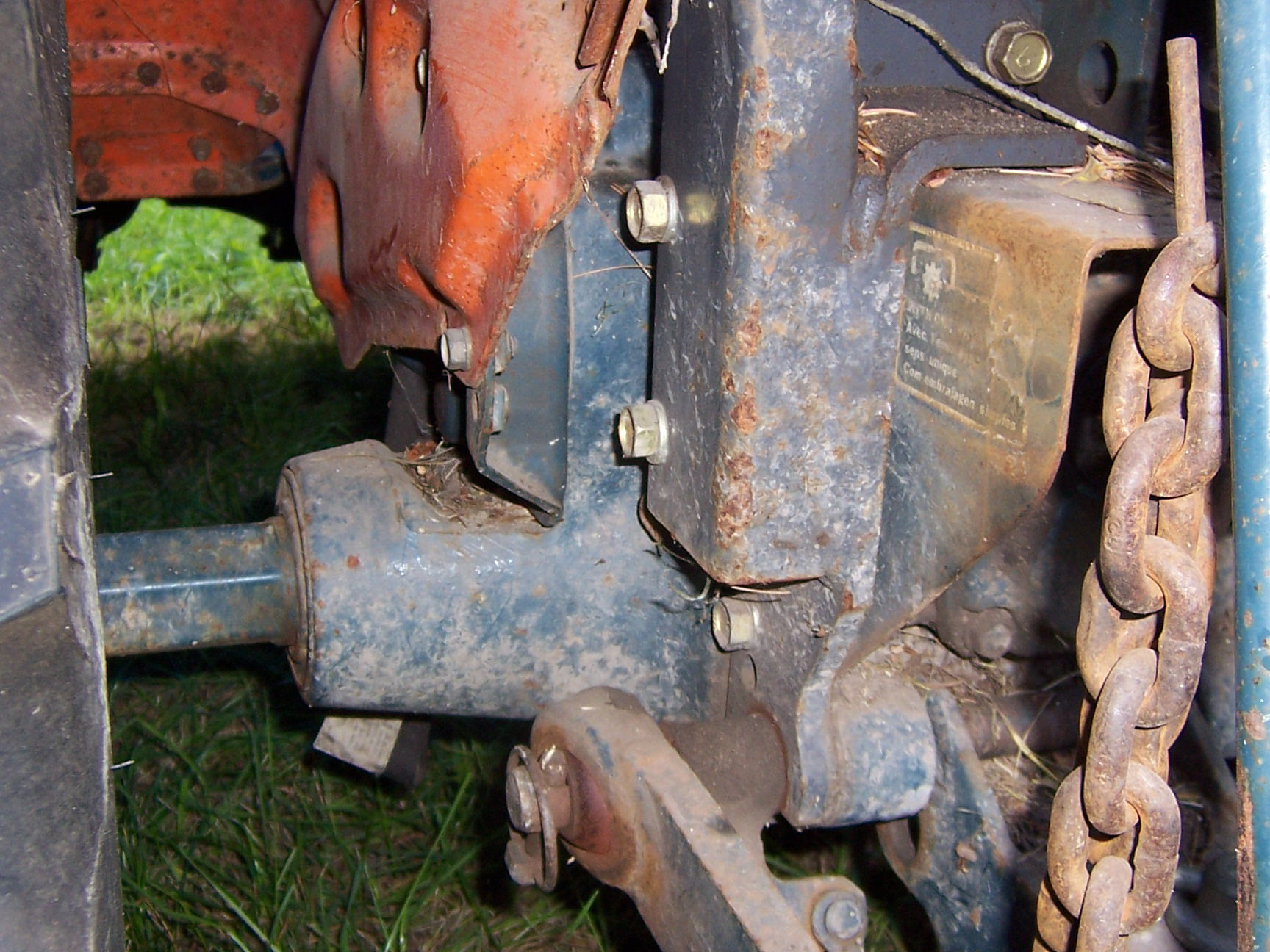

Can you post a pic of how that ROPS mounts on the b7100? I do not have one on my tractor but am thinking it would not work well with my backhoe attachment (subframe mount). It looks like it would be right where you legs go after you turn the seat around.

Here are three shots. The shaft for the 3 pt. goes trough the bracket that is welded to the ROPS bar and they sent new chain connectors that are shorter to allow for the thickness of the bracket. Kubota sent me an offer to get the ROPS for about $100.00 about 15 years ago so I went with it. It also came with seatbelts.
