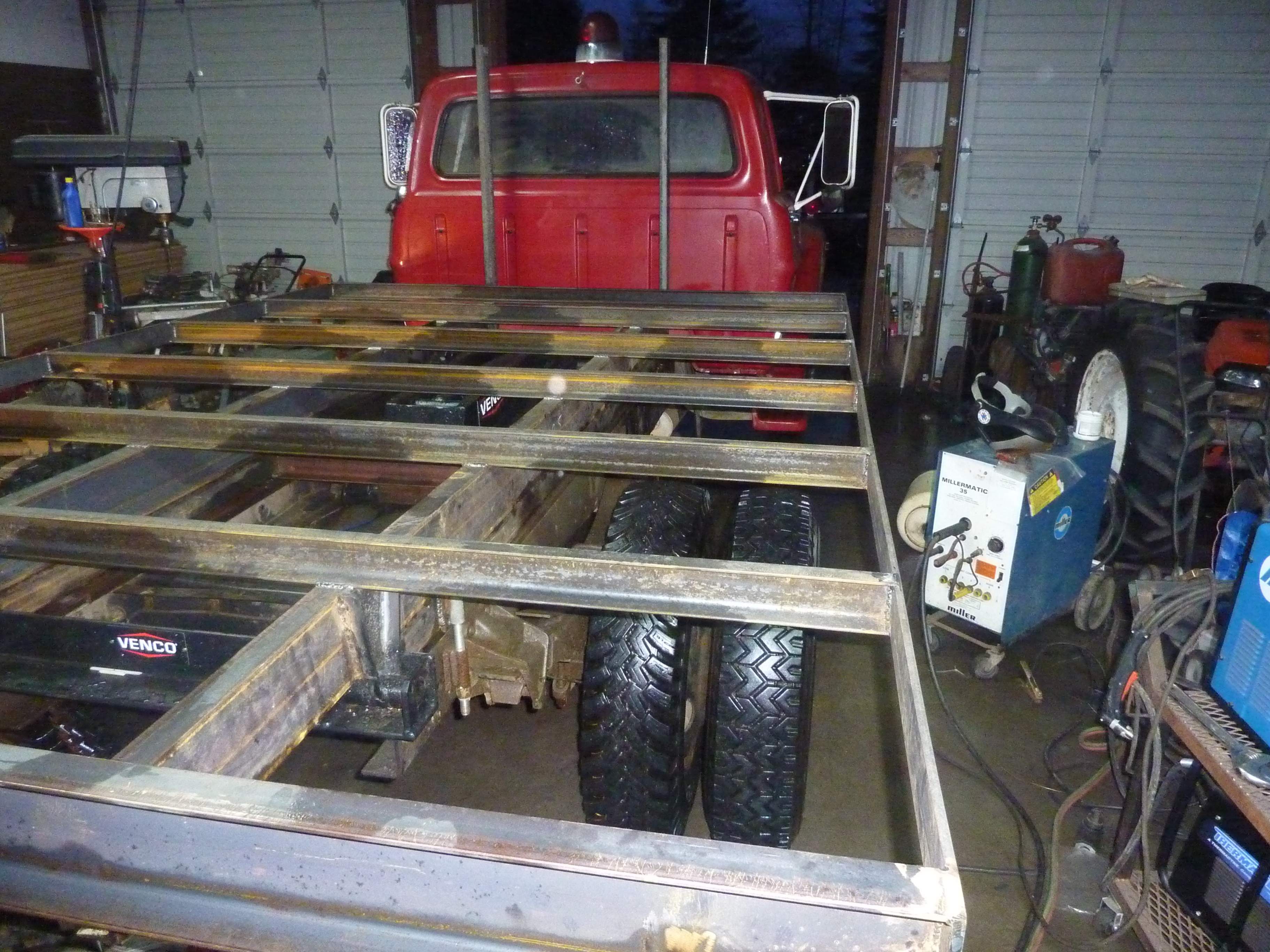

Anyway, pulled the tank off and built the subframe today. I put an air system on to run the water valves so I will keep the airtank on for low tires and such. I used a 1973 toyota celica airconditioner pump. they are two cylinder and have their own crankcase. Makes for a great compressor. On the tag it is tested to 425 lbs. Don't think 125 will hurt anything.
Have a couple of used propane tanks for the air and hyd. Will hang those later.
Tomorrow will cut some more gold and start fabbing the bed. Will take a few pics if anyone is interested.

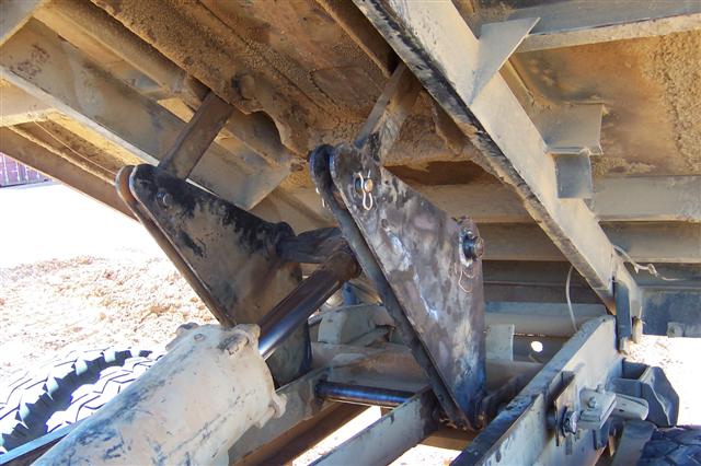

One thing that I really hate, and see all the time, is the sissor lift system used to lift the dump bed. The hydraulic cylinder is run off the PTO, and that works great. The cylinder is attached to a T kind of shaped piece of metal that in turns is attached to several arms that lift the bed. It allows the cylinder to fit inbetween the frame rails, and gives more room for the bed. That T shaped thing has broke on my twice now. The first time I'm sure it was just fatigue since it's so old. The welder I paid to fix it didn't get it right, and the next time, I took it to the most expensive, but what I'm told, the best welding outfit in town. So far, so good.
When I look at dump trucks, and I do, I see that there are several other ways to lift a bed. Before commiting to any of the options available, I'd spend some time researching all of them. There is a difference in how bigger beds are lifted compared to smaller ones. I think it's significant and if I had it all over to to again, I'd buy a different truck just based on the brakes and the lift of the bed.

Today I put the new pump in, fitted the hoist and welded it up to the main and subframe and put the rear of the bed on.
Tomorrow, it is cut all the crossmembers, stake pockets, headache rack, mount the air and hyd tanks. Big order, will see how far I get.
It is turning out to be a bit higher than I would like, but that hoist mechanism needs some room to fold up and the truck frame has a crossmember right under it with just a couple of inches to spare. Other than that things are coming together nicely.

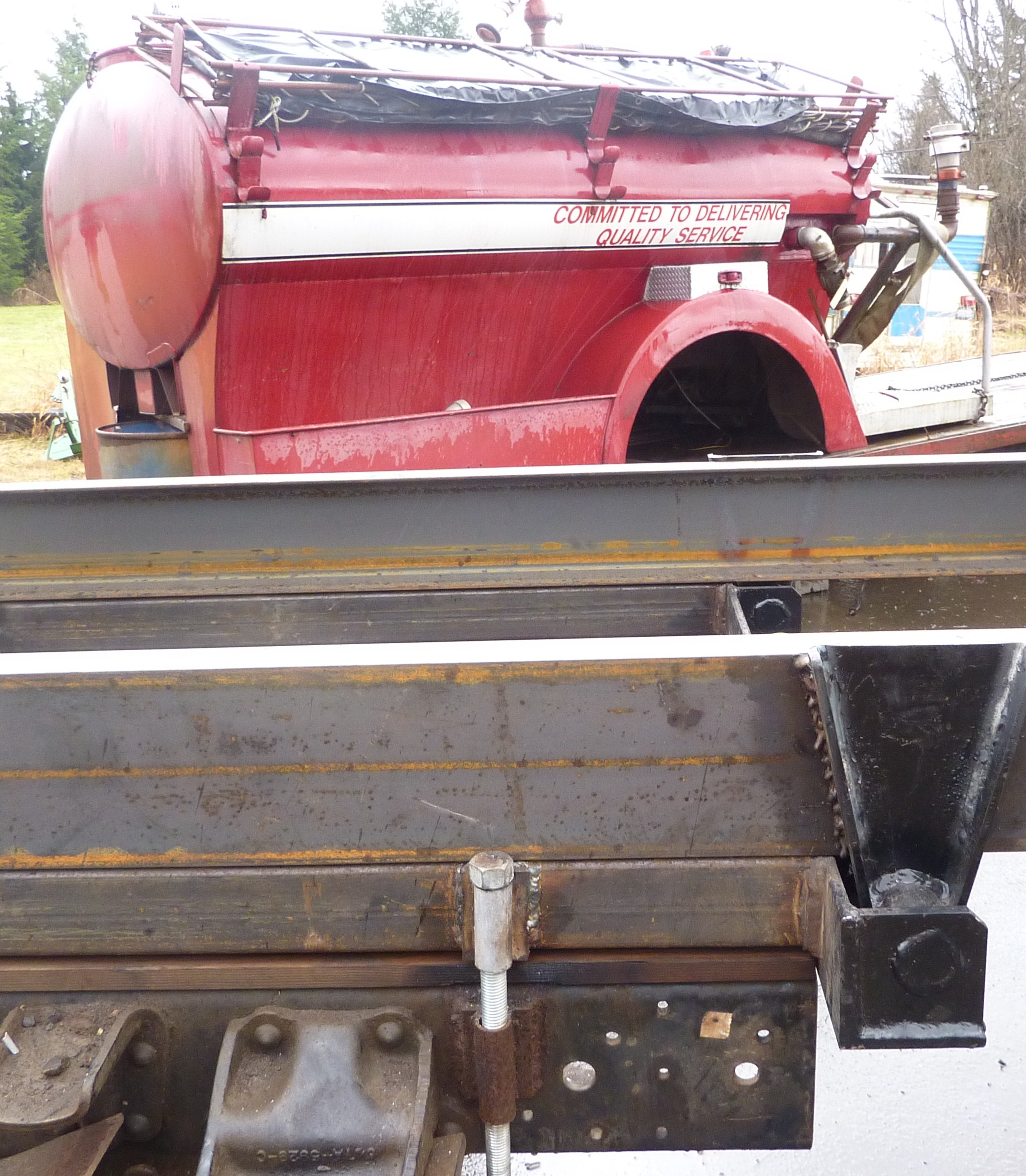

Spent some time on the project today and took a few pics. Had a problem with the welder and had to change out the wire sheath, was sticking and giving me the fits lol. Also with all the wet here, welding is one of those delightful things to do if you like getting shocked while laying a bead down. Maybe that's why some of them look like I have a bad case of shakes after new years.

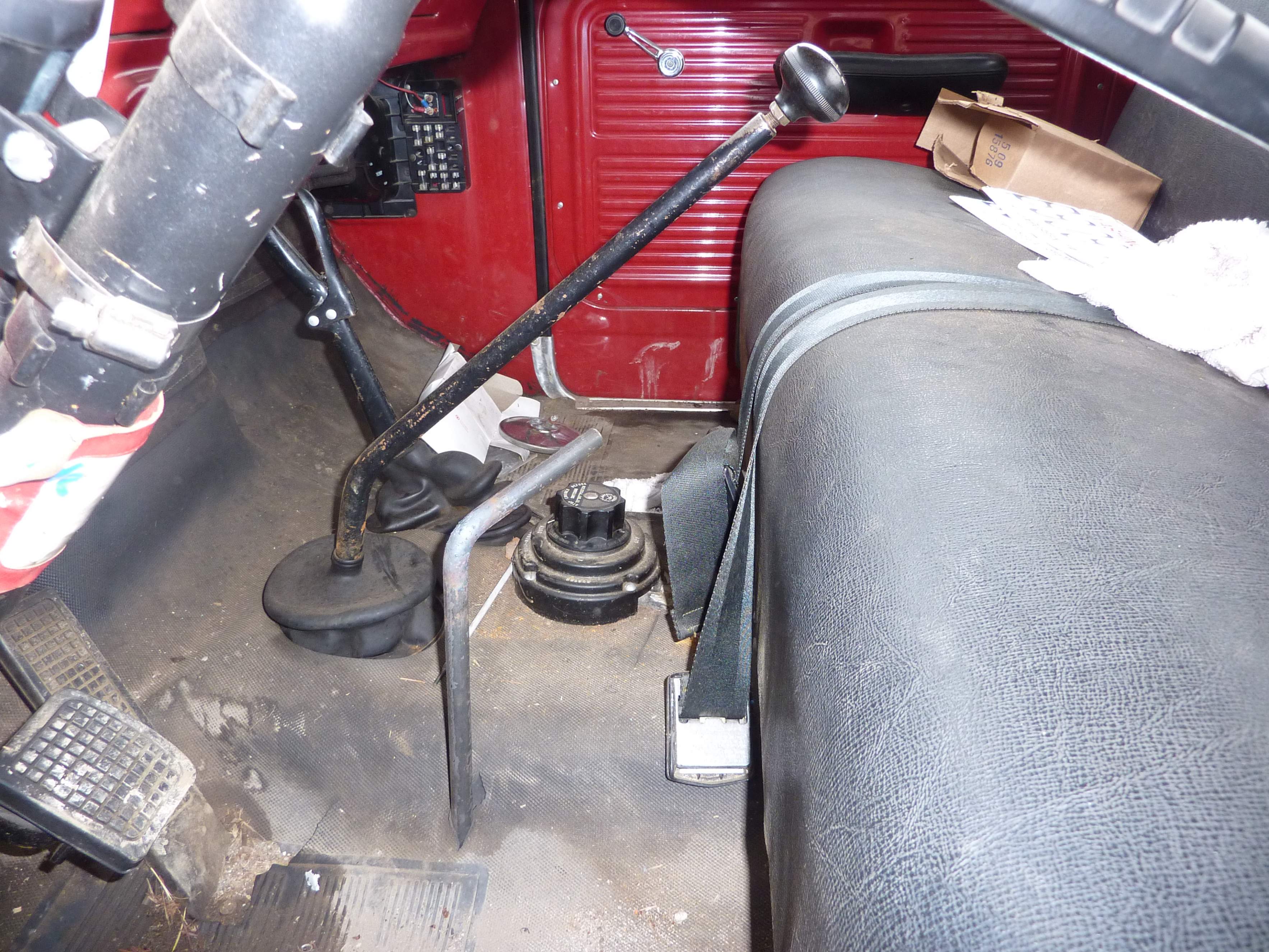

These pics are of the way I bolted down the subframe to the truck, the system for operating the hoist. I didn't want to make a long slot in the floor so I went with a rod sticking up that I can twist, works great with little pressure. The one of the rear pivot is not by the book. They call for cutting out the truck frame and mounting it there. If I had done that I would not have had the room for the hoist mechanism between the bed and truck frame. Besides, no way am I going to cut or drill holes in that truck.
I see I need to do some deslagging from the stick welds on that hinge.
These are a few I took today, if there are any questions on how or why I can get into detail.

cross pieces, will have the stake pockets in tomorrow hopefully. They help tie in the side rails. I have done it this way on several trailer and flatbeds. works well.

Do you intend to leave those strips of plywood between the truck frame and the dumpbed subframe, or are those to not scratch too much on the truck ?
From my time at a truck bodybuilder, i noticed in bodybuilders guidelines of several truck manufacturers that putting wood between the truck and the subframe was strongly disadvised, however this was common practice in the old days.
I see you mount the bed with long threaded rods: these will allow enough movement and stretch, to prevent your truck frame from cracking.
Another thing advised by Mercedes was cutting a V shaped notch in the horizontal flange of the subframe C-channel: This allowed the tip to bend, to prevent that the rigid end of the subframe channel would cause peak stresses at that point in the truck frame.
