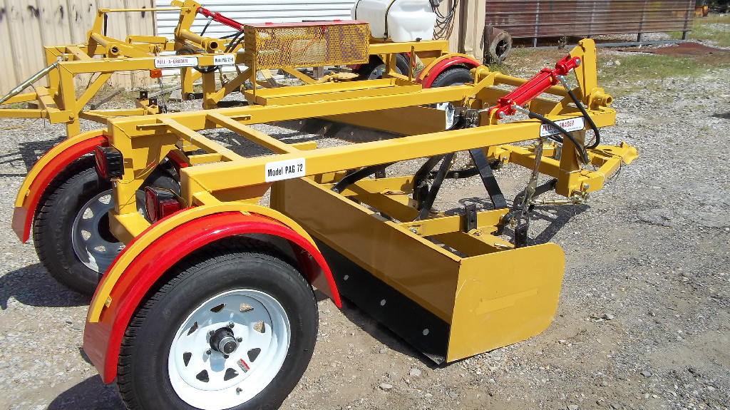

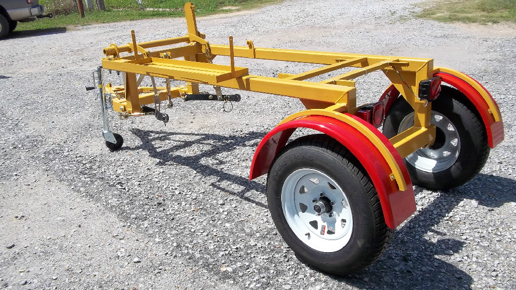

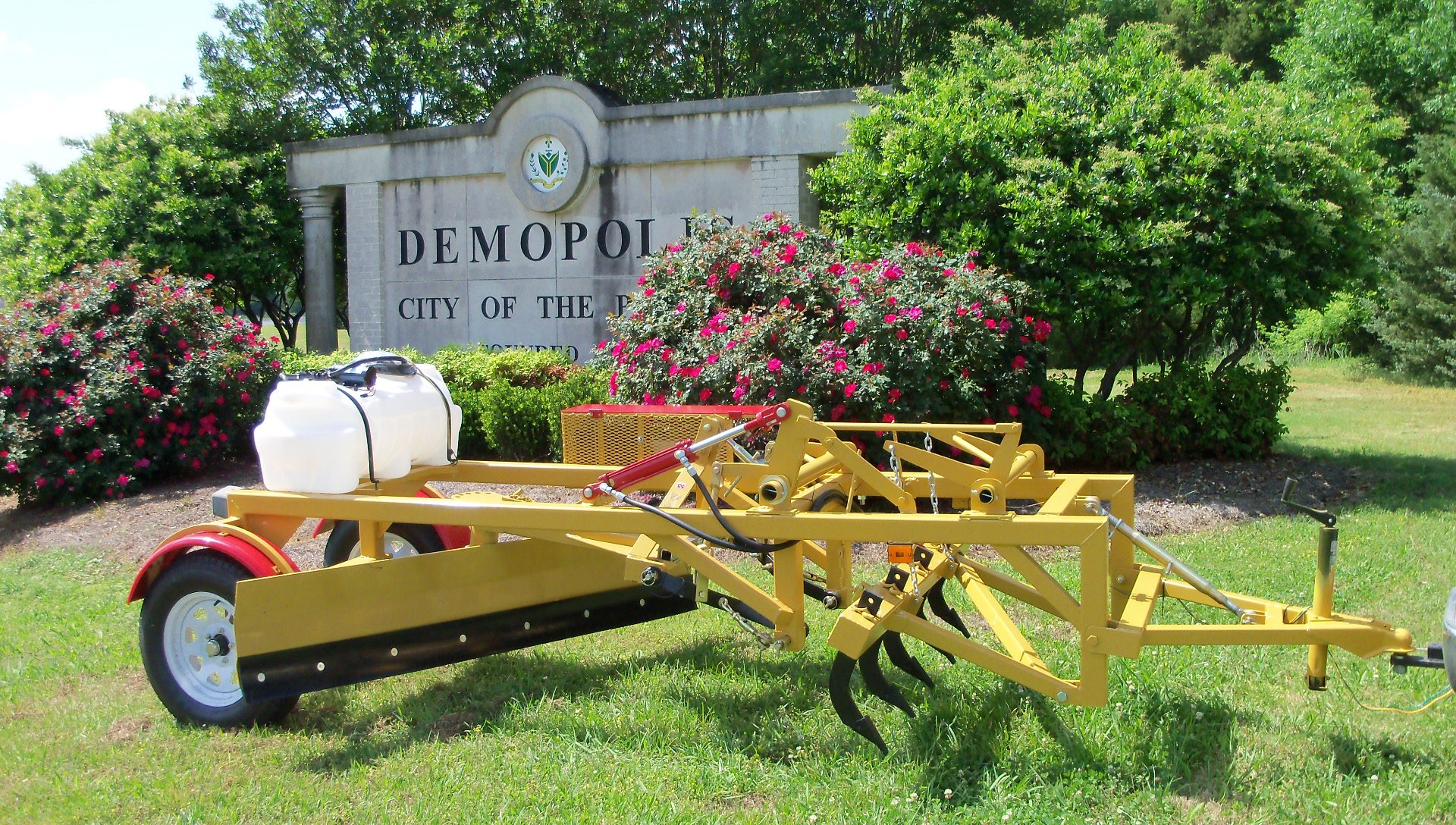

This sounds like what you are trying to do. It uses your rear blade or box blade.
Pull -A- Grader 1 - YouTube
Pull -A- Grader 2 - YouTube

Thats close, Bruce. What I propose to do differently is that the backblade I already have, will not be altered in any way while mounting to the old loader carrier, at least not right away. What could get altered down the pike is a hydraulic blade angle swing changer. I also noted that the wheels are close to the blade. I plan to position my blade well forward of the wheels. If I don't, the raising and lowering of the 3pth to control blade height will not work very well.
