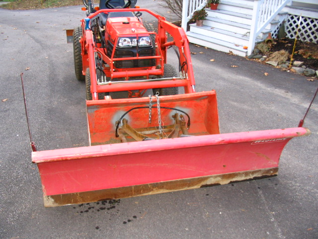

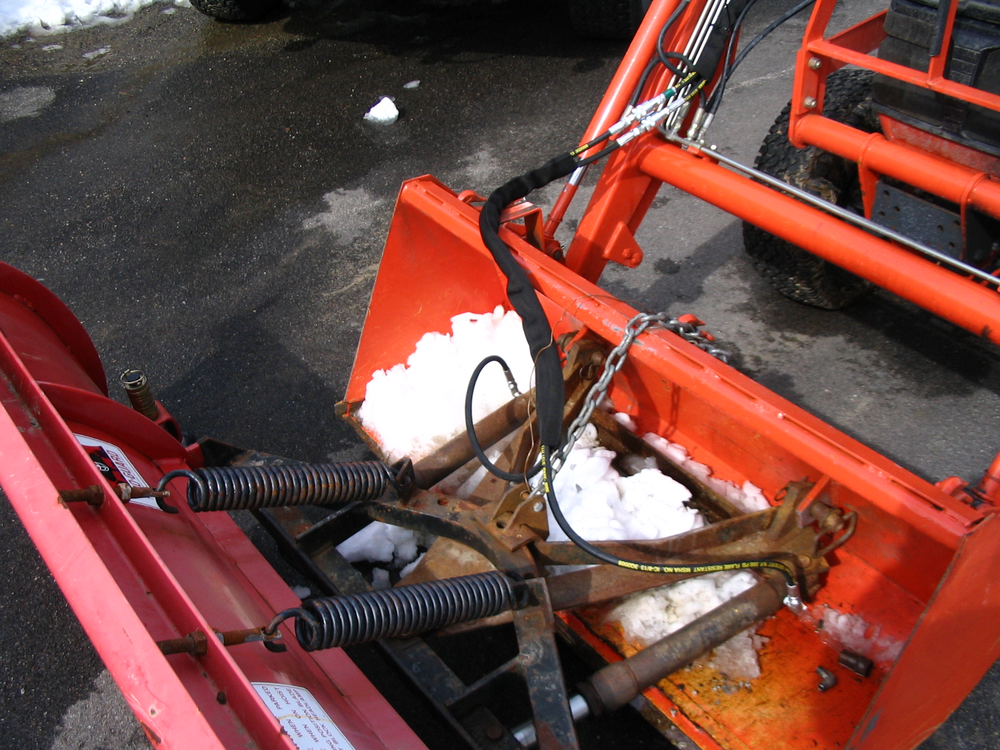

My B7510 with loaded turfs with a craigslist western plow 6.5' cut down to 6' and hydraulic angle...Works the balls!!!
