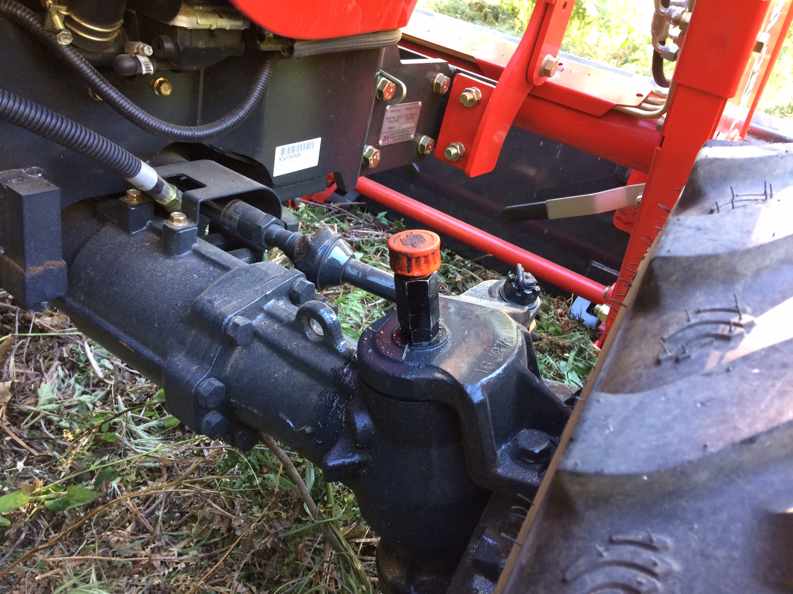

I've noticed gear oil leaking from my 3725's front axle filler a couple times. The last time I had it parked on a side hill with the right side lower than the left for about an hour while running the chipper. There was oil all over the tire. It's coming from the vent hole in the filler cap on the right side.
I mentioned this to Dave's Tractor where I bought it and they said they've asked the factory to address it and in the mean time have come up with a fix. Which they sent to me. As you can see it's an extension tube between the axle and the filler cap.
It seems to help. It's still weeping a little but I may need to tighten it down some more.

Thanks for the heads up. I may have to do the same thing to mine. Haven't side-hilled it yet, but need to mow my ditches soon, so it may be a problem.
Do you know if that's just a standard part (like pipe thread-or)?
   / Front axle fluid leaks on side hills #4
It's prolly a boss fitting. That has the same thread pitch as pipe, BUT it is a straight thread NOT tapered like pipe. It uses an o-ring to make a seal. I t that it? B.

I tightened the fix that Dave's sent me and it's not leaking. When I installed it I was being conservative on the torque; it needed more.
The vent hole in the cap is small and there's often a labryrinth in there as well to keep the fluid on the inside. So it may take some time with the vent side of the tractor down to start leaking out the cap.
