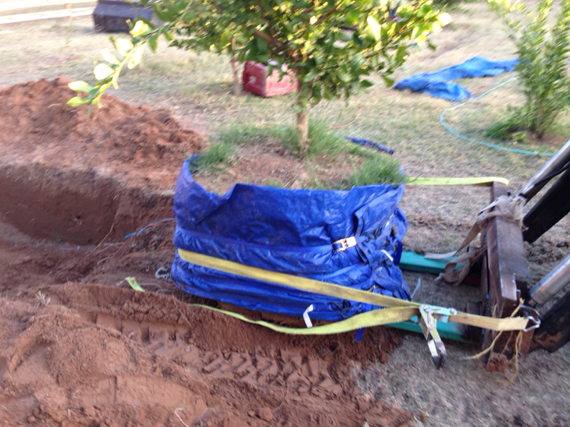

Well I will clean it off of all residue to get a better shot in detail. I just noticed tonight after quick inspection I hadn't noticed it before but that's what life's all about. I've been moving some extremely heavy loads with the loader thirteen total and nothing breaking but the fork once..
Would've thought itta snapped by now.
