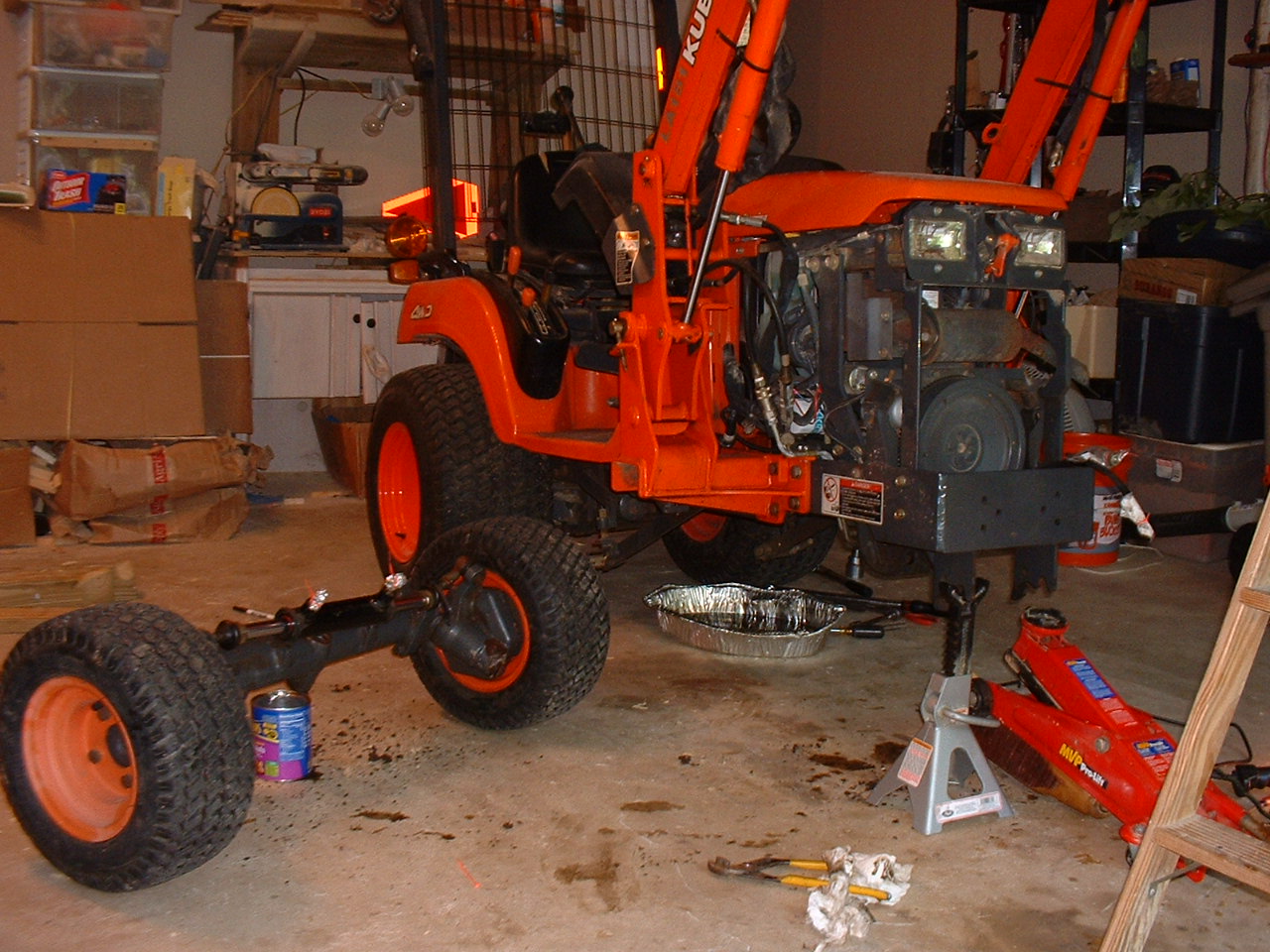

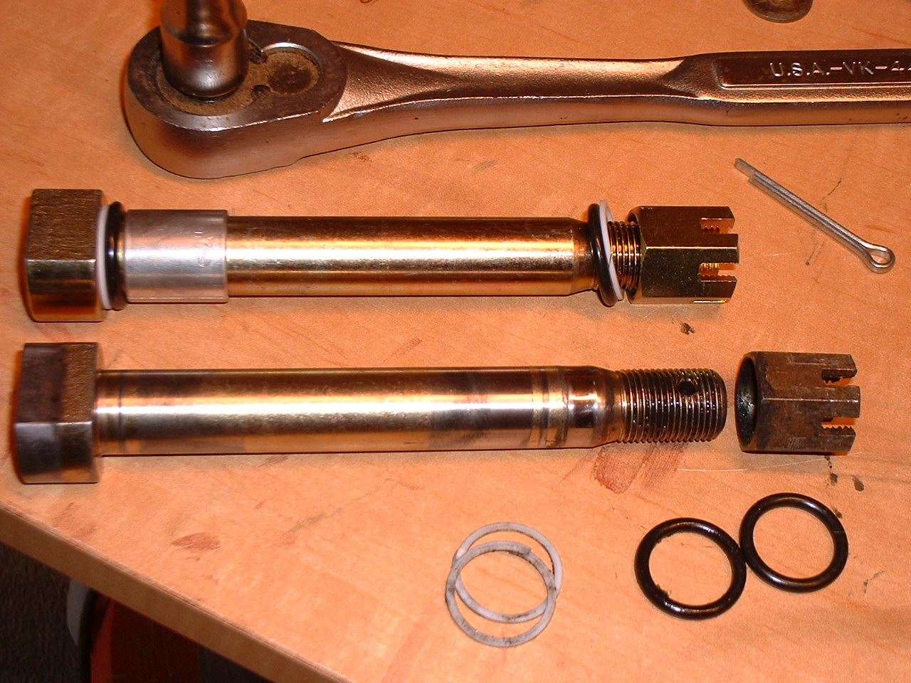

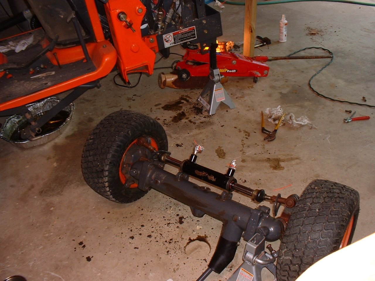

Don't know about you guys but this is how I love to spend my weekends. (NOT) Of course after waiting a week for the parts, the dealer gave me the wrong size bushing so, guess next week I'll be putting her back together. From the look of the pivot bolt one side looks very worn my guess, this is where the oil is getting past the seals as they didn't really look that bad. :eek::rolleyes:

Hi Ron,
I bought this tractor used with front the end loader nothing else, which is all I wanted it for. I already had a dedicated lawn tractor. It had around 420 hours on it. I had not made any adjustments to the pivot bolt.
I've only put around 30 hours on it myself, so far all front end loader work. When I first got it home It had a bad hydraulic leak under the steering unit. So while I had it all apart I replaced all of the hydraulic hose's. :eek:

you may have got off lightly actually. i had a few go through where people have not used a counter weight and the hubs have cracked at the bevel gear pivot. this turns a leaking king pin seal (well thats what we thought it was until we got into it anyway) into a fairly expensive repair.

The jury is still out on if I got off lightly. Did not notice any cracks at least not to the naked eye. I hope it turns out to be a simple fix once I getter all back together. :eek: Expensive is not in my play book at this time.

Alright,
got the new bushings and o-rings in, put the axle /power steering and hose's back on, and no leaks of any kind. Cleaned up and lubed my 4x4 shaft and splines. I also went with 80/90 weight this time. The SUDT is to thin for my taste. I even fixed my heat gage while I had the front grill off. Feels good to have er back up and running.
Next move is to add ballast per everyone's suggestion here and, also to make some sort of venting for the axle. Anyone done this if so any tips on the best way.
Right now I'm thinking just drill a small hole in the cap and cover the hole with Velcro and then maybe attach some fine screen and cotton gose over that. right now just my initial thoughts. :eek: :rolleyes:
