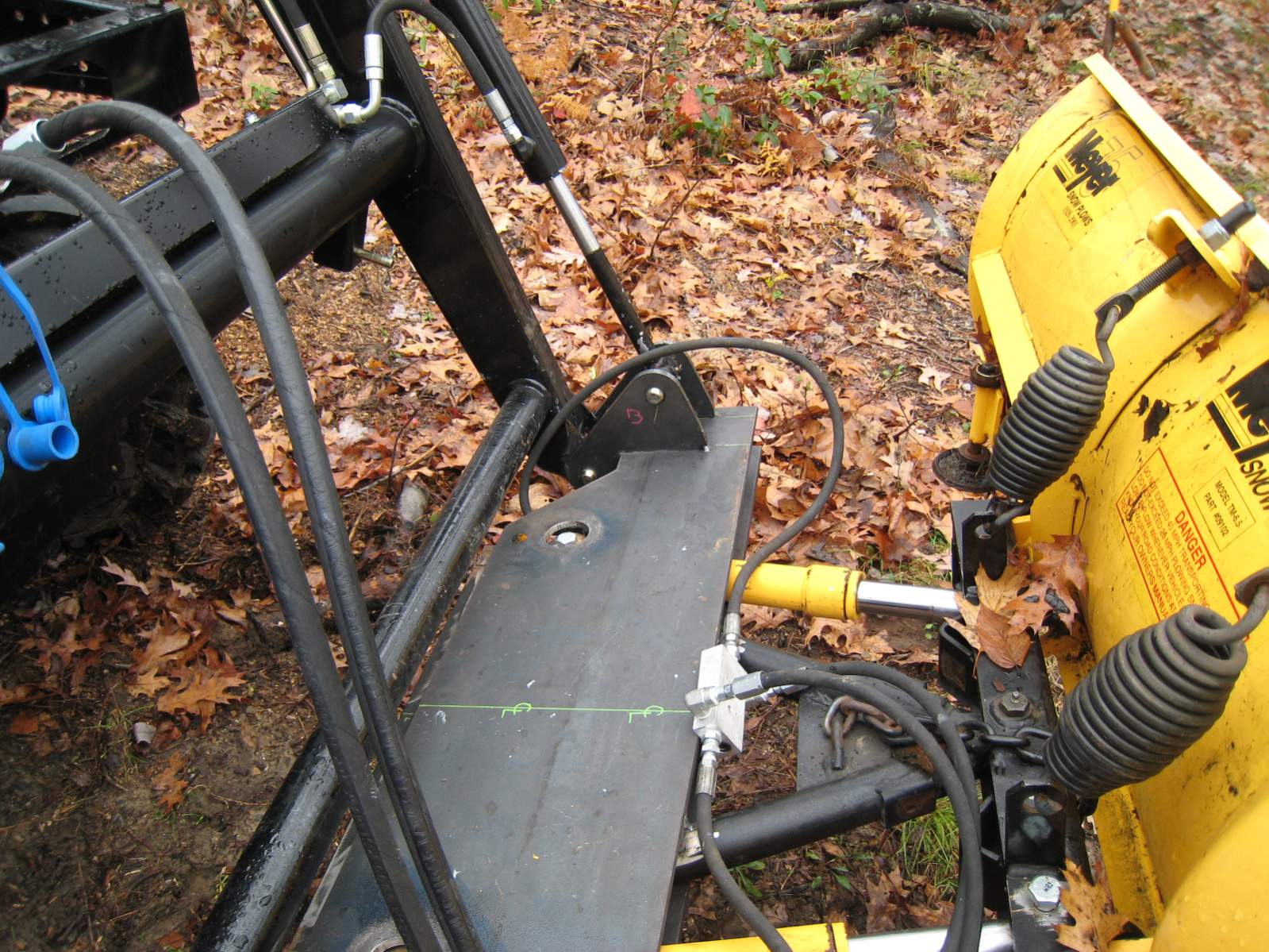

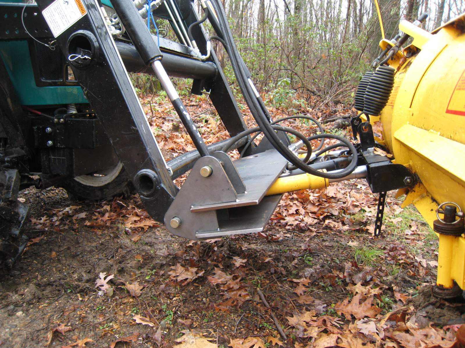

Thanks for the compliments. Here's how I did it. I already owned the Meyer plow and bought it new a long time ago. I have no welding equipment so I brought the "A-Frame" from behind the plow to a local weld shop and had them cut off everything I didn't want. Per the photo below I was given the two triangular brackets on each end that are connected to the loader arms. They came from a firm already in the business of making a loader snow blade. Same story for crossover valve. In the photo you can see the brackets with the loader pins but no reinforcing bushings. Next I made a model of plywood and kept adjusting the model until it was right. Then back to the weld shop for prefab and tacking. Then back home and onto the loader for a final check before it became all boxed in.

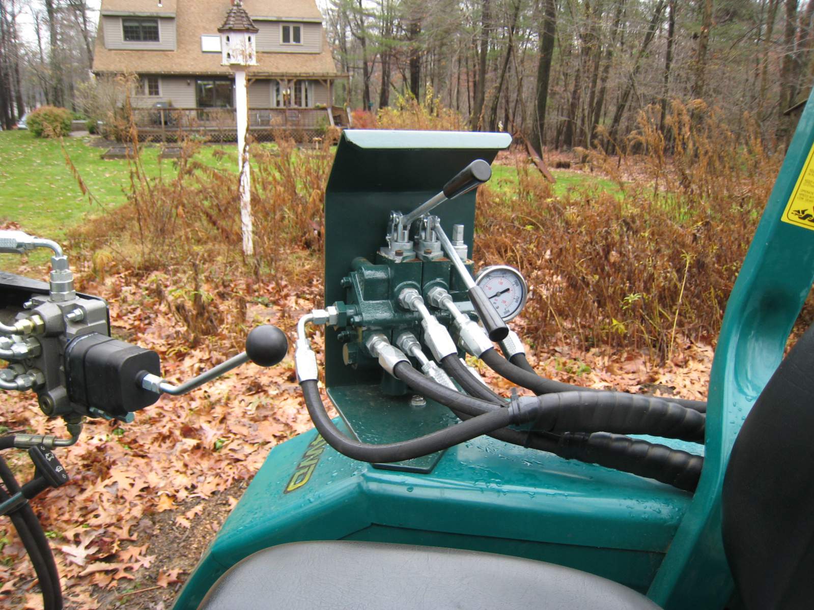

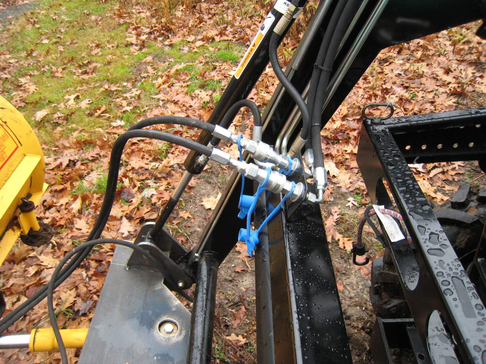

The angle cylinders run off the front remotes controlled by the valve in the picture. With a lot of help from 3RRL I added these valves, rear remotes, and front remotes.
