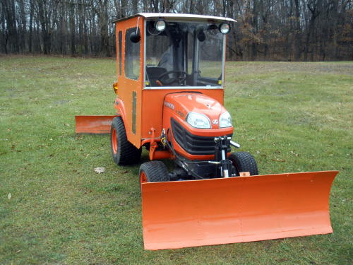

This blade started out as a 100 gal upright LP tank front&rear plow.jpg made everything but the hoses & hyd cyl. It is used on my 900" and also off property.

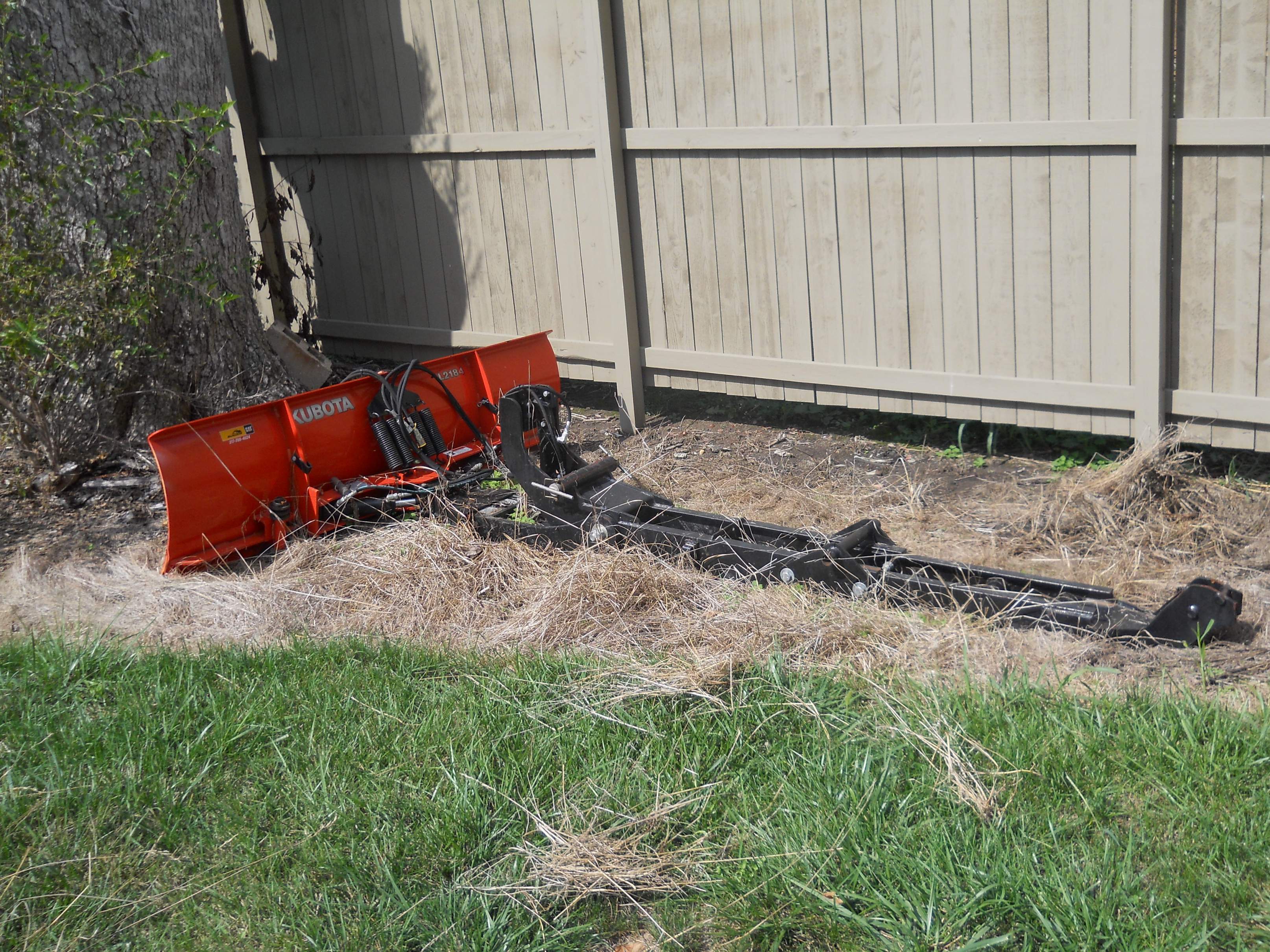

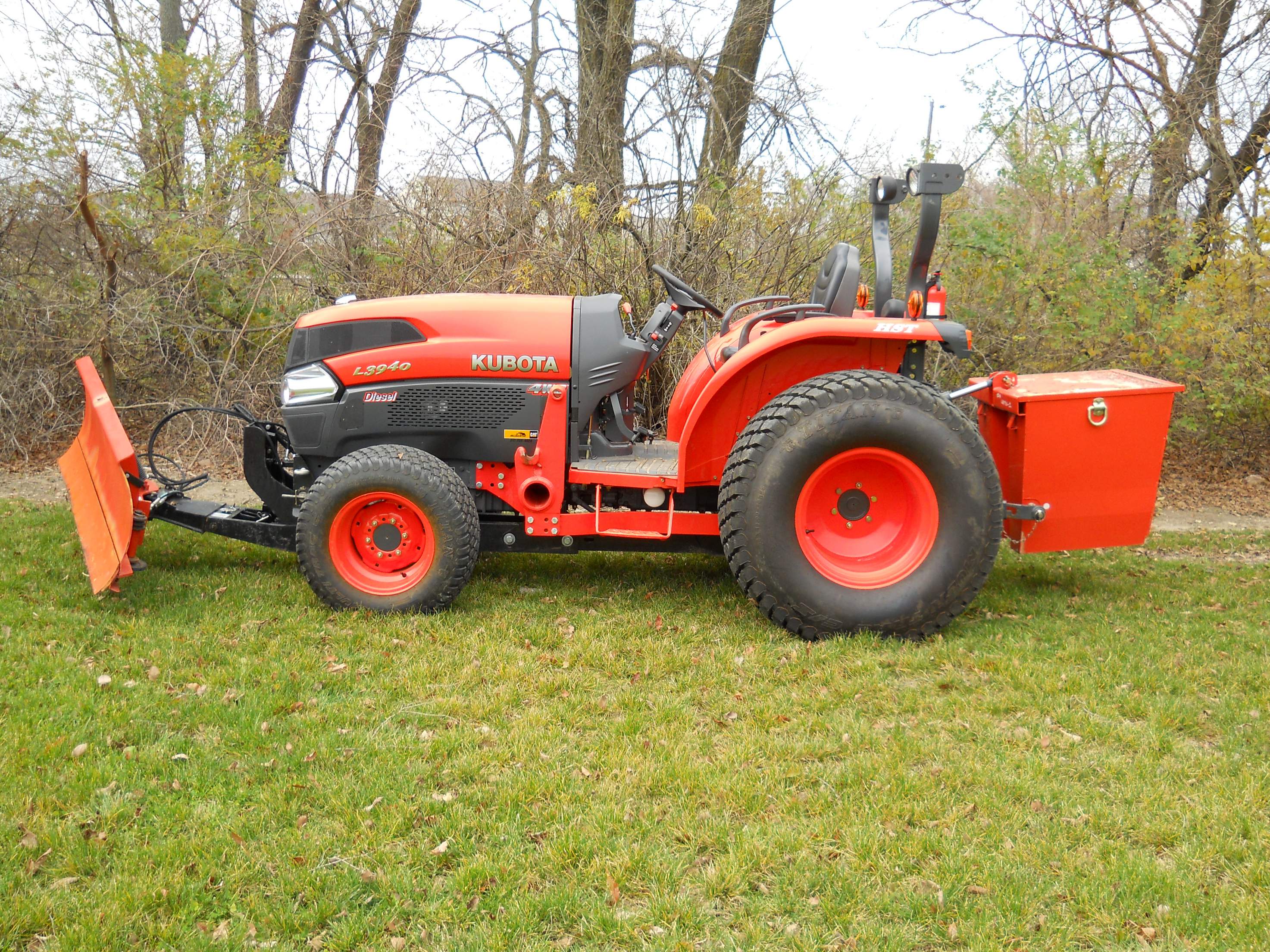

This is my set up, cannot imagine anything working better front blade wise. Probably more expensive, takes longer to mount/dismount, and takes up more room to store, but you will not be disappointed with performance or stength. Philip.

Just a little more info. I welded ears on the quick-tach plate to attach the blade so the blade floats independent of the loader just as it would on a truck mount. For the hydraulics I ran hoses from my rear remotes for the blade so I still have full use of the loader for adjusting angle of attack if needed for hard packed snow.
