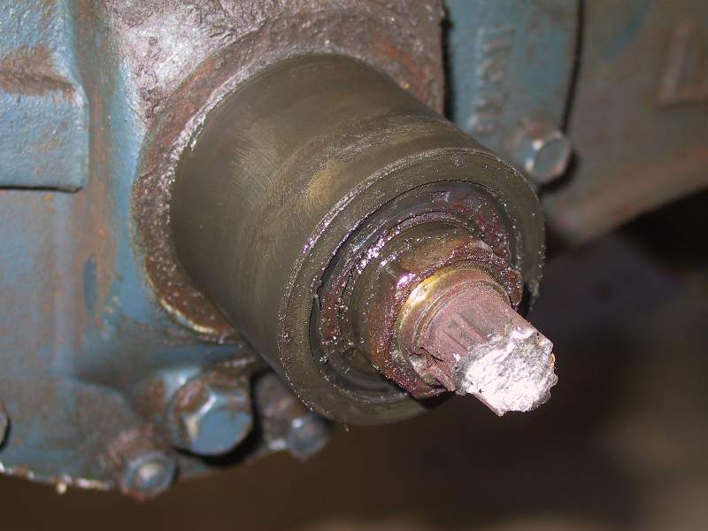

It been a while (a long while! including a month long vacation!), but, I thought I should let everyone know that I fixed the problem!!!
Thanks for all the advice... I ended up doing the job myself. Didn't have too much trouble... I bought a bunch of shims, thinking the tolerances could change, but I ended up not using any (actually, there was one measurement that was close I wanted to adjust it, but of course, that was one shim I didn't buy... oh well, like I said, the measurement was close, not way off...). I also took the "opportunity" to replace some seals that were leaking.
Anyway, 4wd is back up and running and all leaks are fixed! I've put about 20-30 hours on it since the repair and all is well....
Thanks again!
Billboe
p.s. Attached is a photo of the damage...

Billboe,
I am a field service engineer for a manufacturer of Rockwell hardness and tensile testing equipment. I looked at your broken part and I am convinced it broke due to improper heat treating. Take it to the bank.
   / Front Differential TROUBLE! #25
Billboe,
I am a field service engineer for a manufacturer of Rockwell hardness and tensile testing equipment. I looked at your broken part and I am convinced it broke due to improper heat treating. Take it to the bank, this part was defective. See the ridge where is was case hardened? This part should have be hardened to all the way through. In a QC check, this part is sawed in half and hardness is checked for case and core. For whatever reason the core hardness failed.
