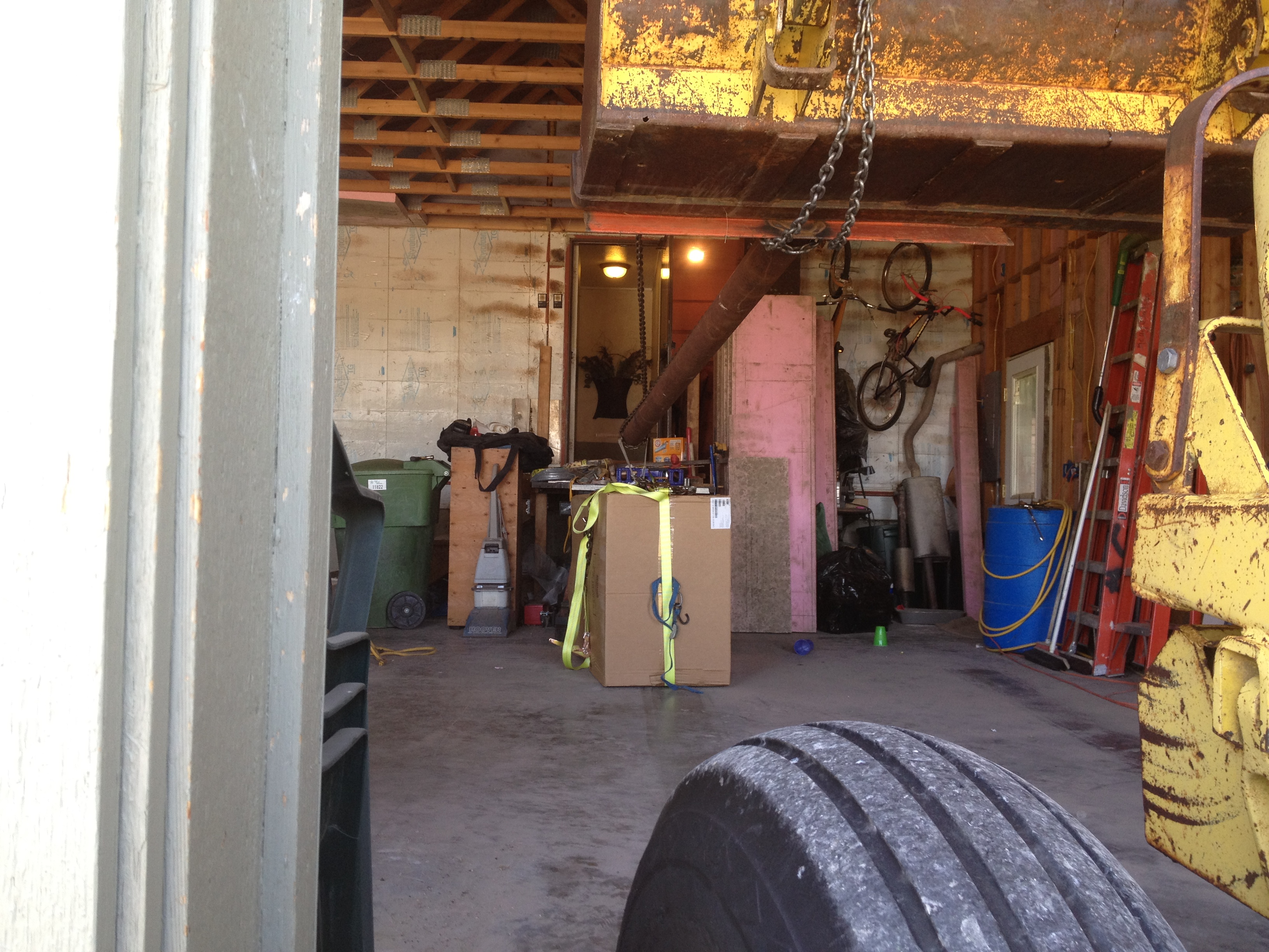

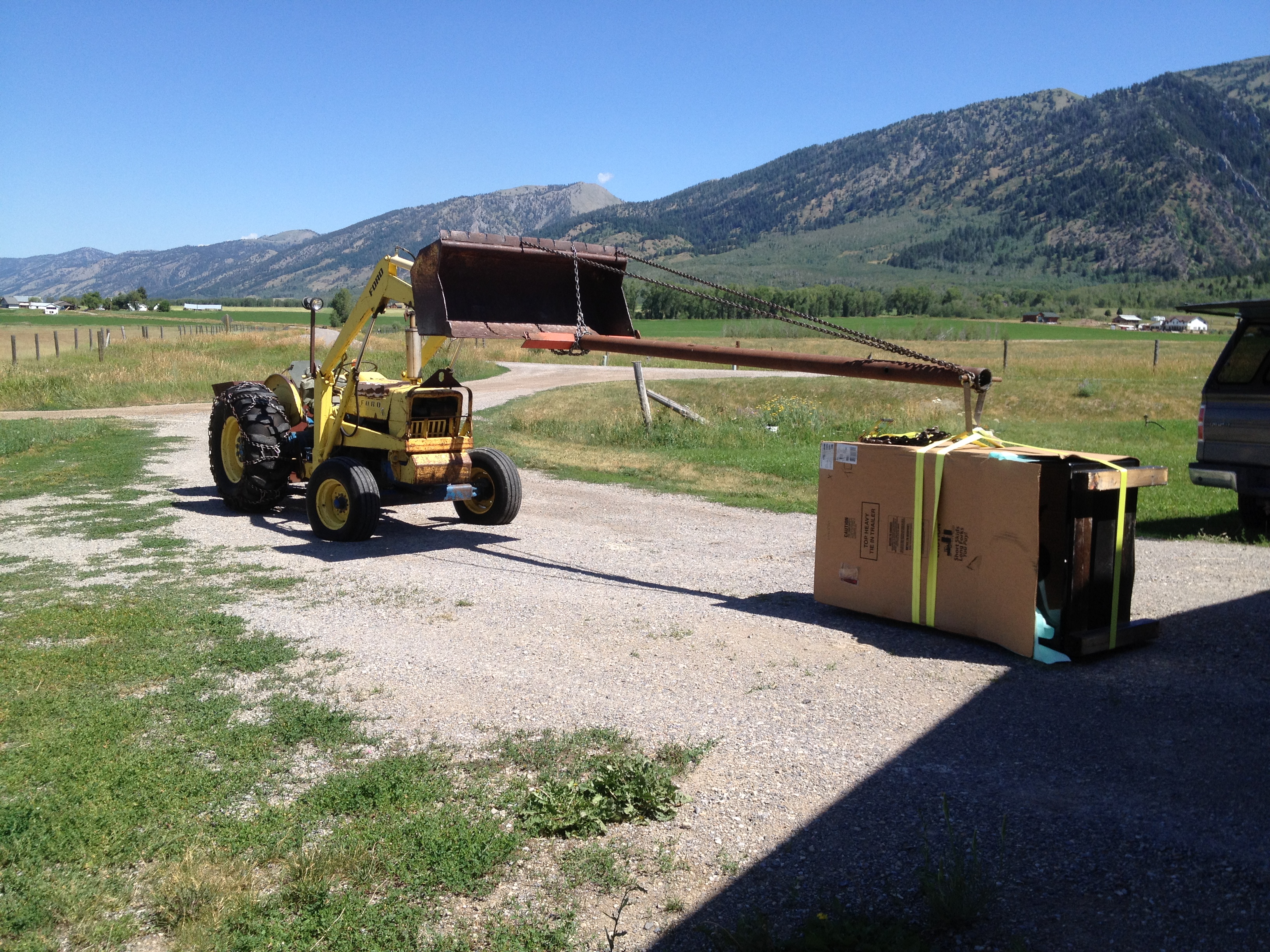

I made this stinger for moving a safe into my house. I also have a shorter stinger but don't have a picture of it.

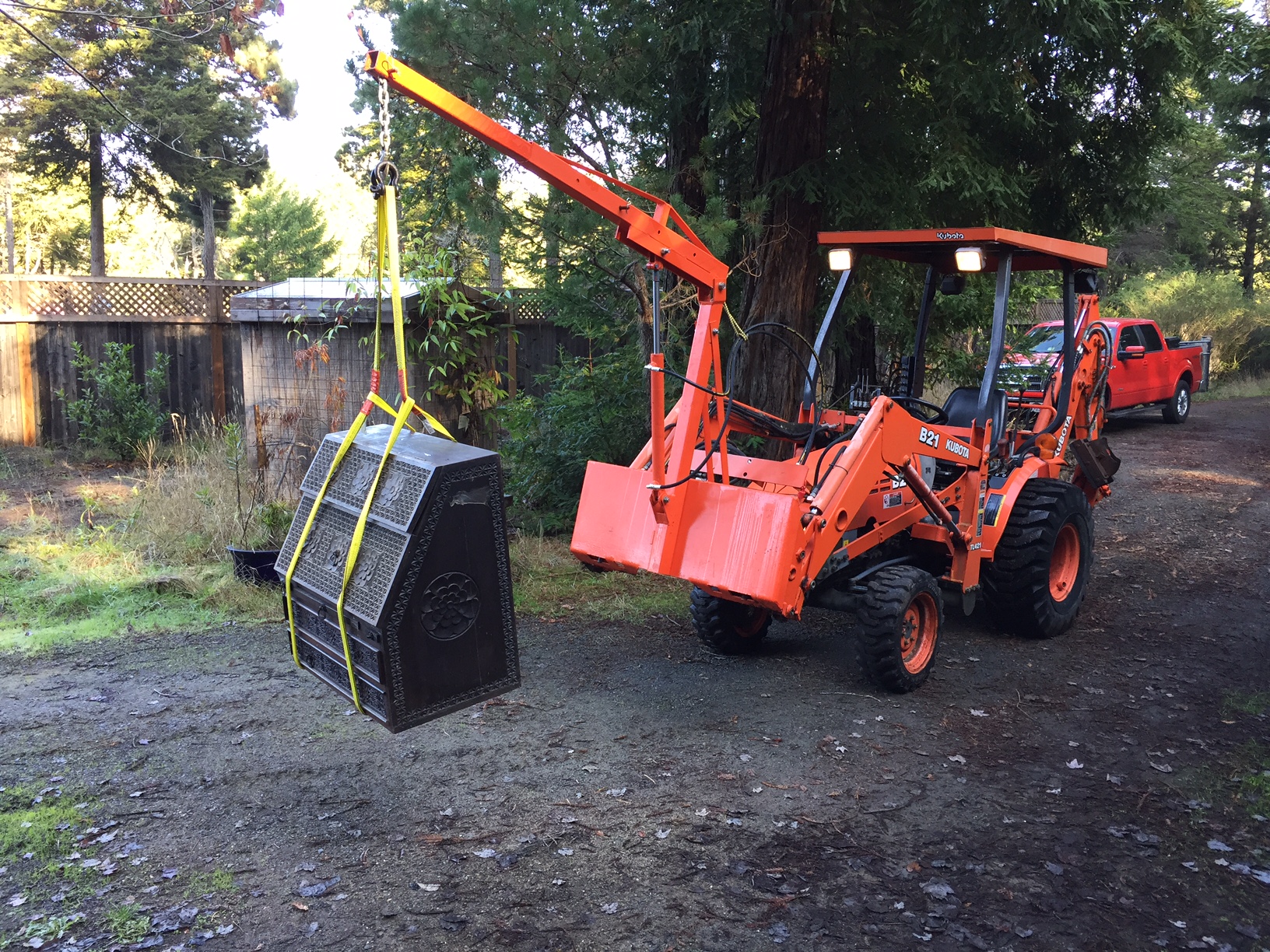

Many thanks to texasranger556 for giving me the idea to do this. Following up on the post above. I mounted an old engine hoist on a SSQA plate and replaced the jack with a cylinder run by the tractor hydraulics. It is very handy and was easy to make.

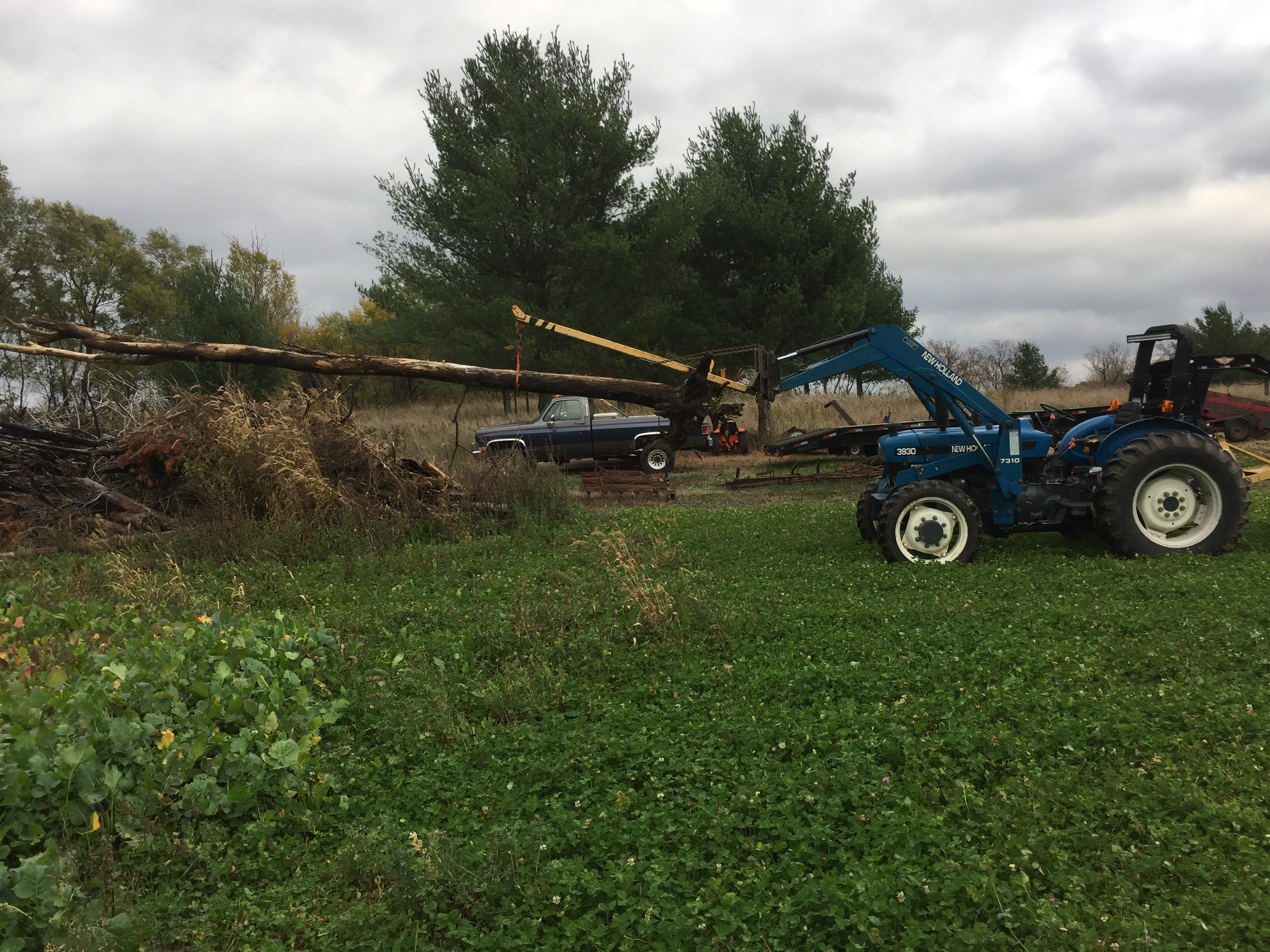

I made one from square tubing, that fits on the forks:
That looks nice but what is the real benefit of the cylinder? If the arm was fixed in the highest position couldn稚 you just tilt the bucket up and down to lower it?
/ Front End Boom/Crane #19
Well I agree pretty much with what you say. The cylinder is not essential, the boom could work without it, just like any other boom folks have made. I put the cylinder on with some ideas in mind. First I wanted to preserve the engine hoist functionality, so swapping the hydraulic cylinder for the muscle-powered jack seemed like the right thing to do. Second the cylinder operates slower than the curl function on the bucket, so easier to control. Third I am going to mount my Remington electric pole saw on it for tree trimming. I figured the slow-moving cylinder would be easier to engage the saw than the curl motion. The last thing is stability. For lifting heavy stuff on and off trailers or pickups, I plan to put the loader on the ground and do the lifting with the cylinder. The B21 gets pretty wobbly with a weight hung out, either front on the loader, or back on the backhoe. These are some specialized needs, that might not be important for many folks, but add up to why I put on the cylinder.
