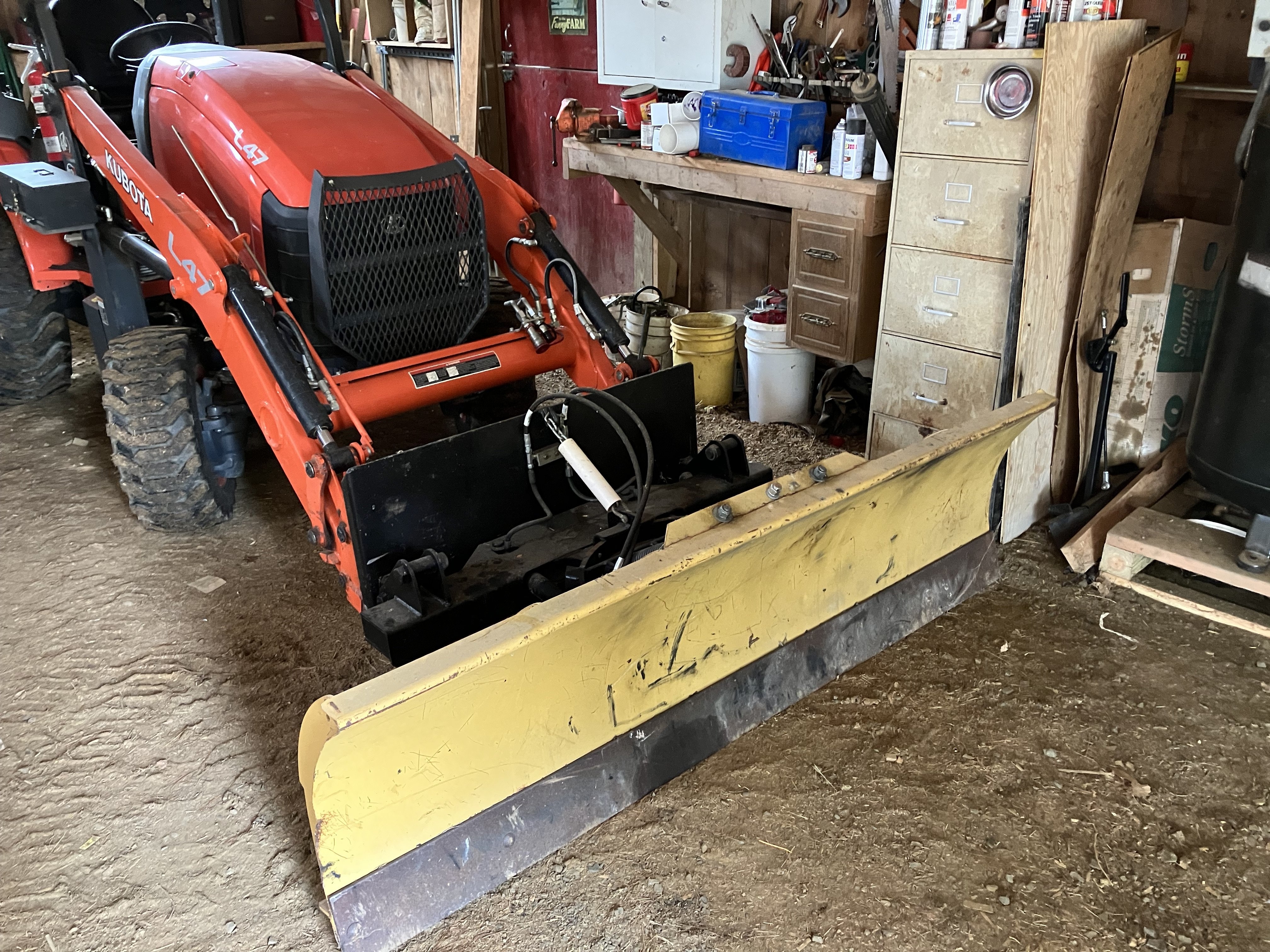

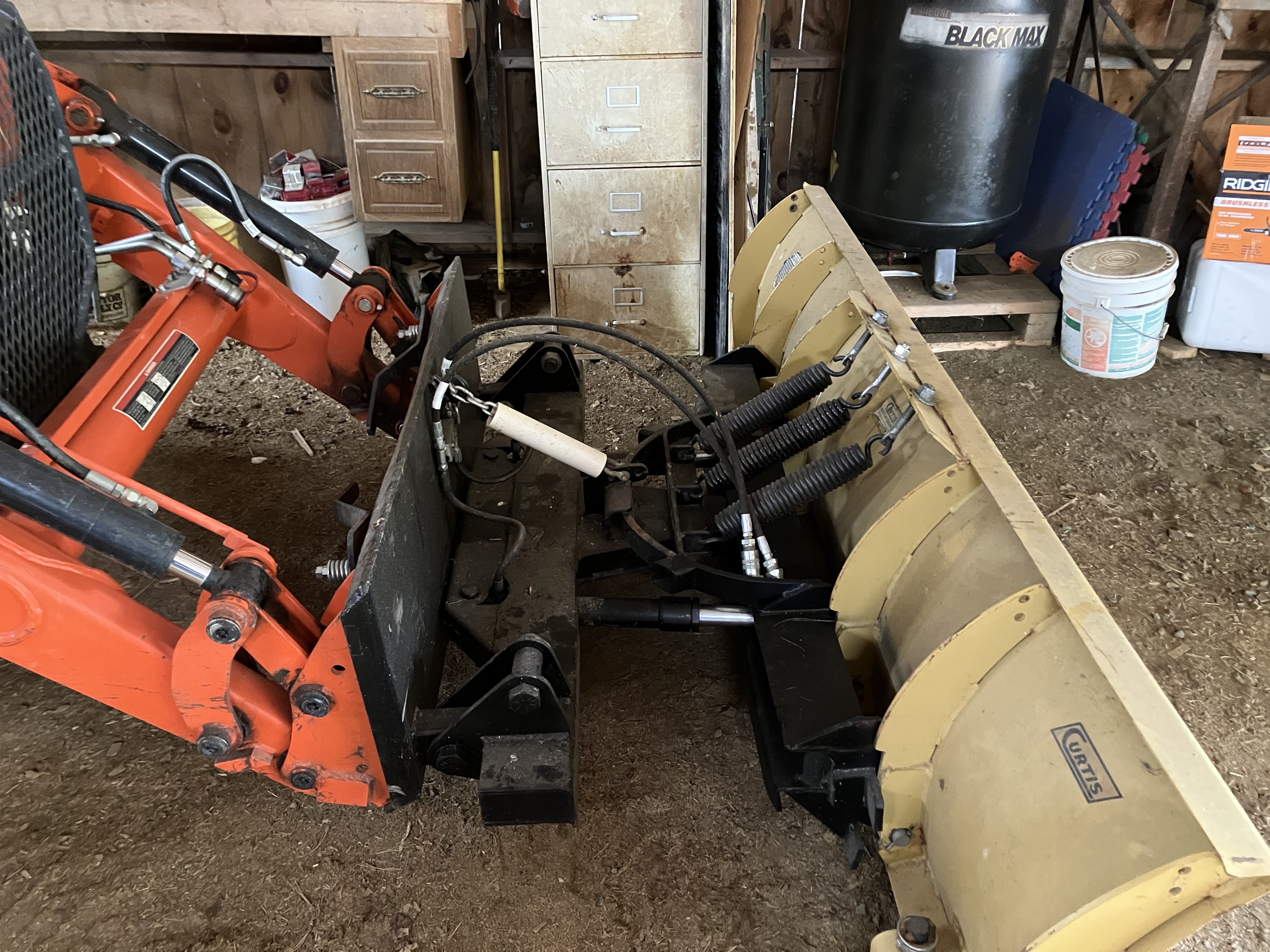

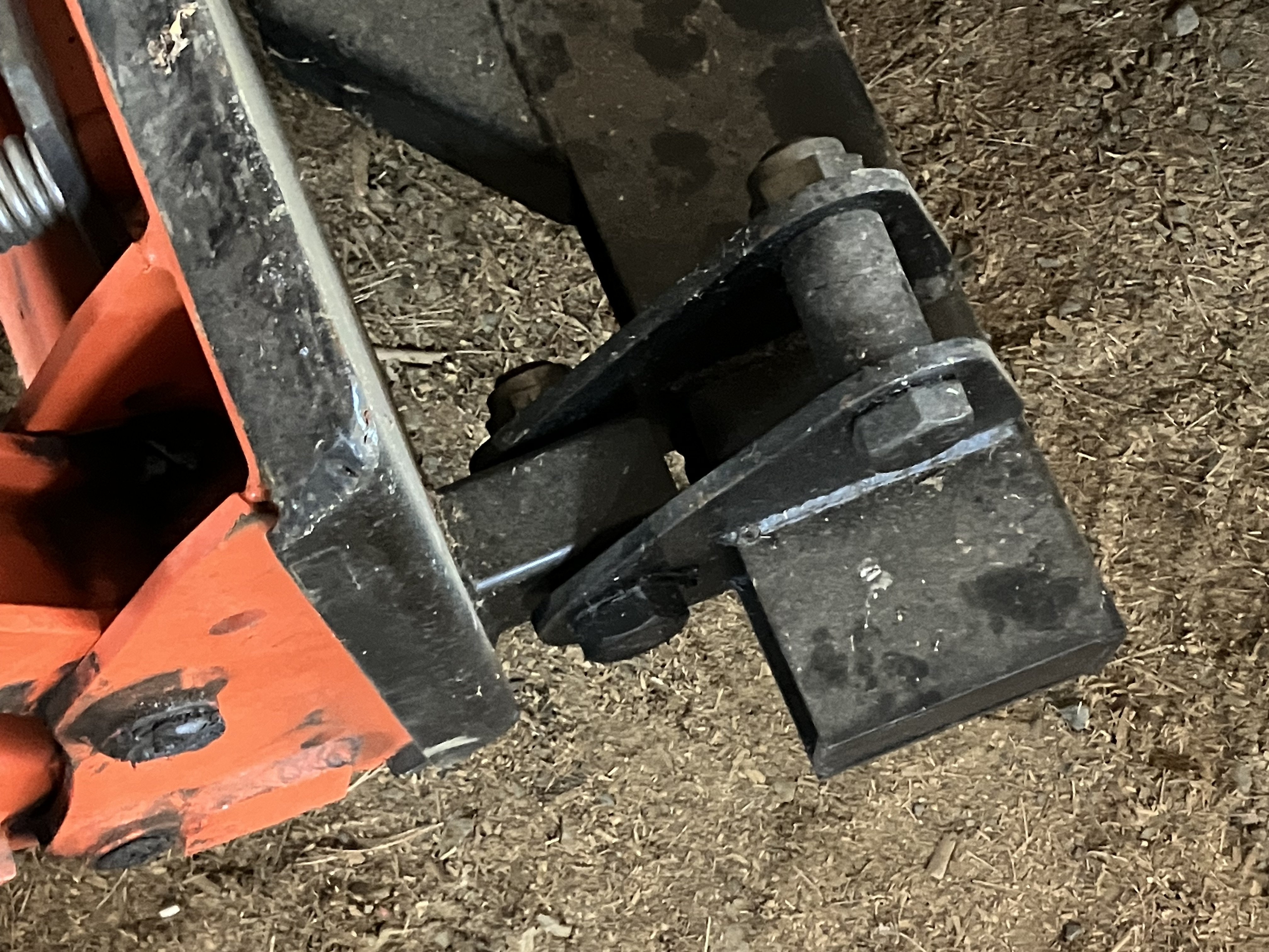

I have a Curtis plow that was a pin on loader mount. I converted it to SSQA with a floating/ chain mount blade.
It works pretty much like a truck/frame mounted plow.
The PVC pipe is for storage so the SSQA plate remains upright. I'll remove it before doing any plowing.
   / Front end coming up while plowing snow with FEL mounted snow plow #27
Yep. That's the best way to do it.
   / Front end coming up while plowing snow with FEL mounted snow plow #29
It probably is but when you have a solid mount Kubota blade you work with what you got.
My Curtis blade was originally a solid mount. I modified it to a floating blade.
I helped convert other solid mounts. It usually isn't that hard or expensive.
If you post a photo of your setup I'm sure the folks on the forum could help you redesign it if you want to.
