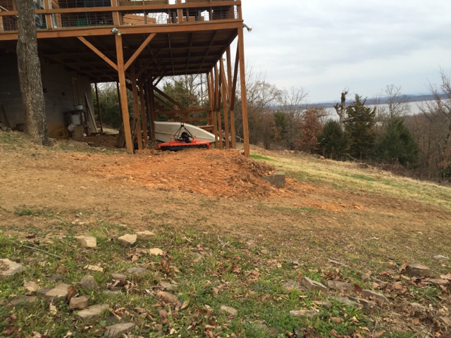

If just a toothbar does the job OK and or with a subsoiler etc...for loosening enough to remove with the FEL...and if there is a place to stock pile a few loader buckets where it could be accessed with a 3ph rear scoop pan...it would add some capacity and help balance the load for the 300' haul...
I see 3ph scoops all the time for anywhere from $100 -$150...on CL...

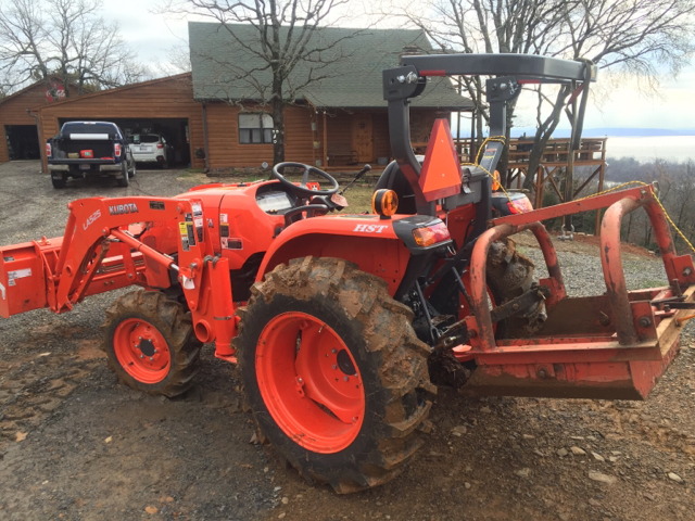

And then I am looking at CL and this shows up for 100 bucks. ImageUploadedByTapatalk1456333439.179014.jpg

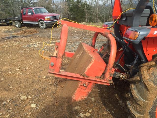

It has rained here hard yesterday so it's a mess around here but I had to try it out.

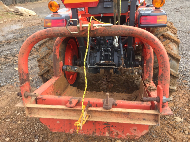

The trip mechanism was frozen up up a little time with penetrating oil, prybar and wirebrush has it working again perfectly.
The spring is gone and I used a bungee for now till I see one in my travels.ImageUploadedByTapatalk1456333639.046438.jpg
I have to say, pulling on the string, hearing the latch click and the thump of the bucket dumping brought a grin to my face like a little kid! ImageUploadedByTapatalk1456333740.747898.jpg
I read a lot about them after it was mentioned here. They have apparently been used on farms for quite a few years since FELs were (and still are) so expensive.
This'll carry a good sized load up the hill also in conjunction with the front bucket AND makes it easier to back in and dump under the deck.ImageUploadedByTapatalk1456333997.193318.jpg
