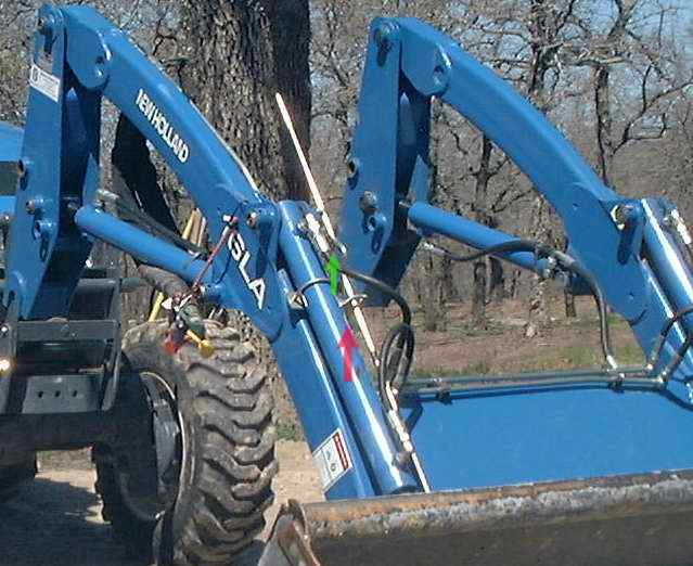

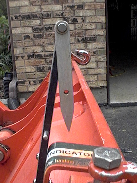

I really like the level indicator on my NH loader. The pictures attached show a rod that has a "kink" in it (green arrow). When that kink aligns with the bracket shown with the red arrow, the bucket is level. The bracket is just clamped to the roll cylinder with a U-bolt and can be adjusted up and down. The rod attaches to a hole in the dump lever mechanism on the bucket as shown in the second picture. Since you can clearly see the whole rod from the operator's platform, you could paint this rod with indicator bands to your heart's desire. I haven't seen a level indicator I like better than this.

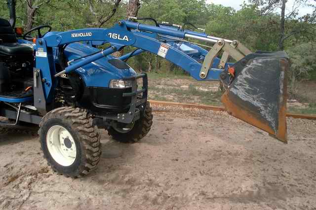

The only problem with most of the level indicators is that the only time the bucket is actually level is when the tractor is on level ground. The rest of the time it's just keeping the bucket parallel to what ever slope the tractor is on.
My cheap homemade indicator shows me if the bucket is level no matter what slope the tractor is on. When the pin and pointer are lined up I'm level. So far I haven"t bent it or knocked it off "yet".

That's a really good idea and simple too. The only thing is, is that you are looking at the side of the pendulum. One thing that might make this a little easier to read is to paint the sides of the support and the pendulum a bright color (orange of course) so that you could see when they are or are not in sync.
