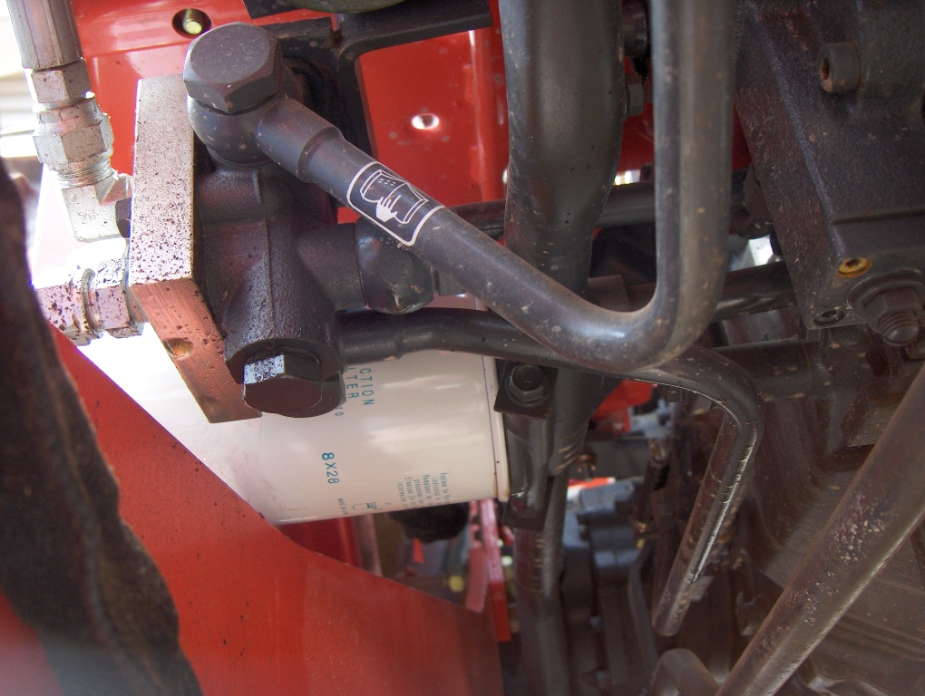

My friend has a L4400HST and was questioning the FEL lift ability. The first pic the location of pressure relief block. The second pic is the hex head that holds the pressure relief spring and adjustment shims.

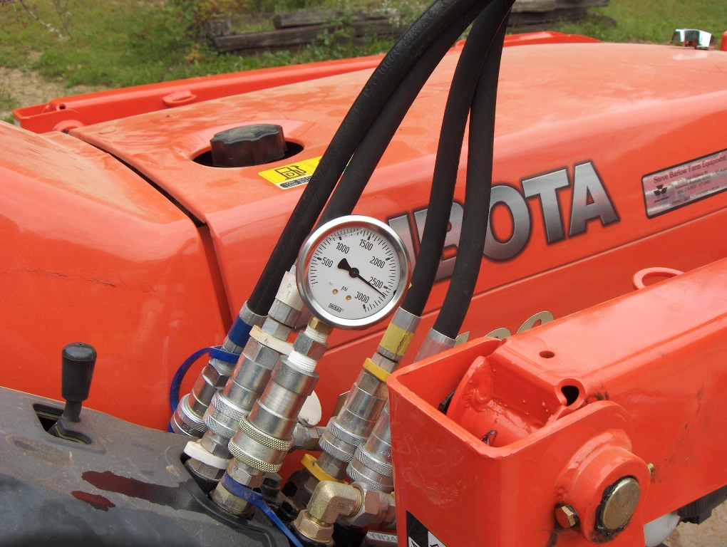

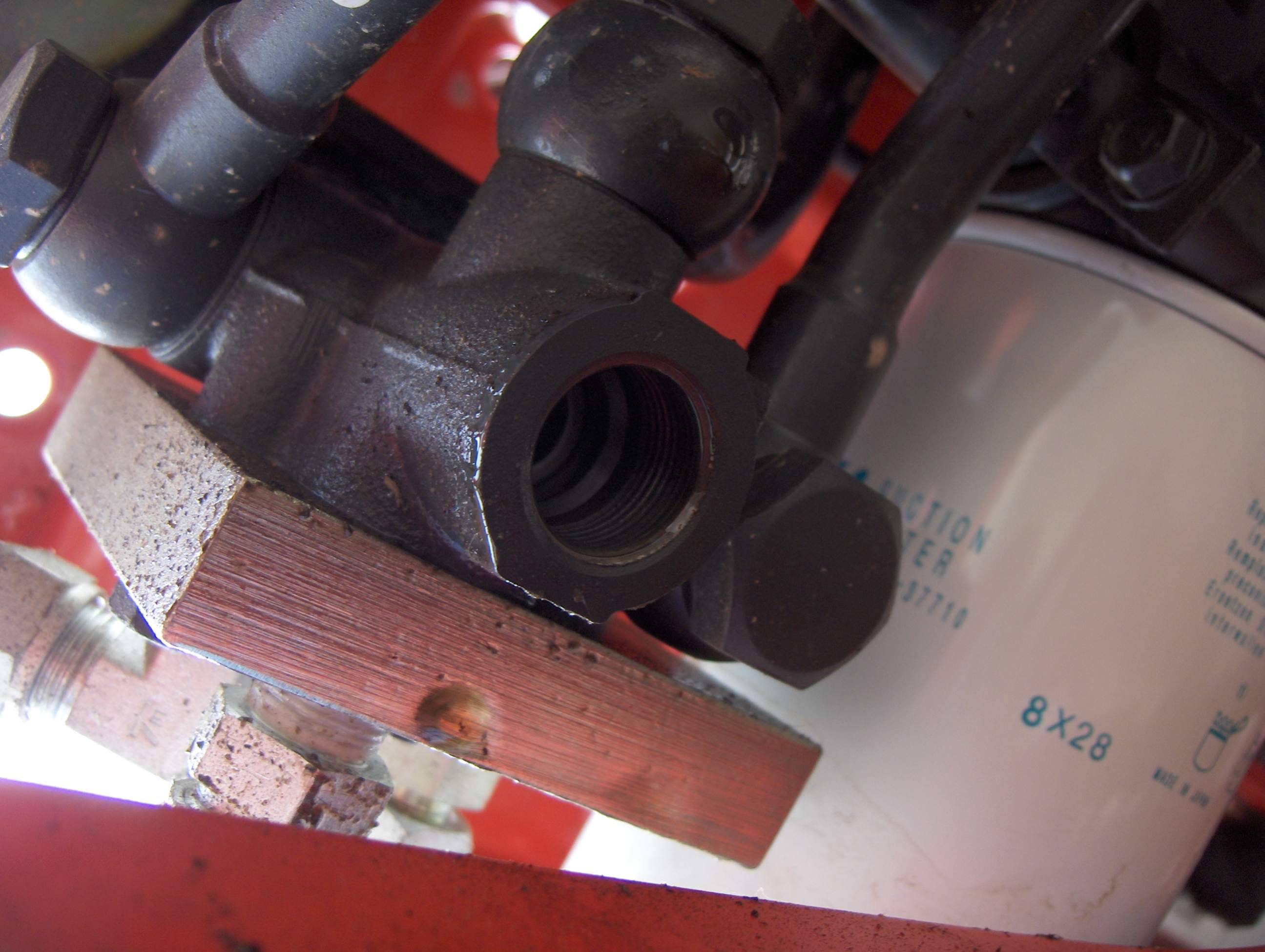

Before we did any adjusting of course we checked the pressure at the FEL quick connect. We held the control valve open till the guage topped out at 2540PSI with the engine turning about 2000 RPM.The Specs call for a max of 2631PSI. We used a wet dry vac attached to the hydraulic fill opening and on to keep from loosing any hydraulic fluid. The pick of the valve with the releif valve spring removed is with the resevior full and the vac on.

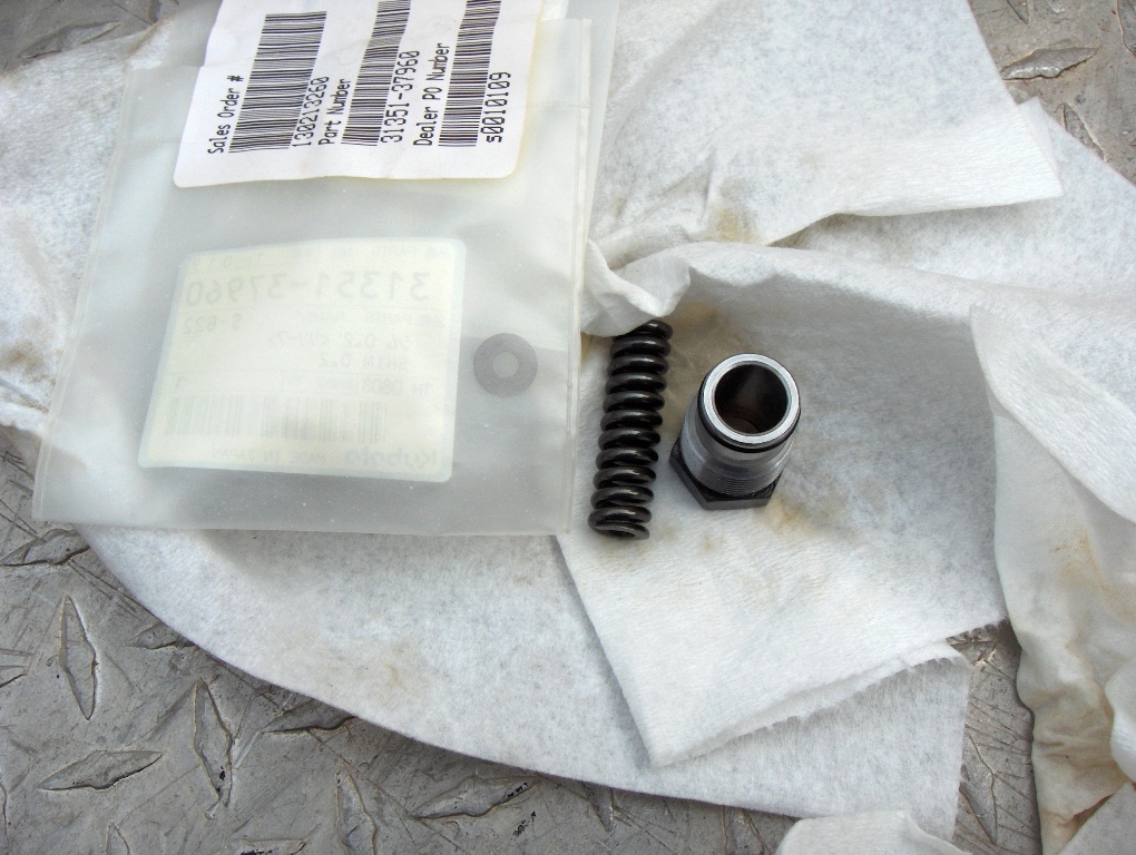

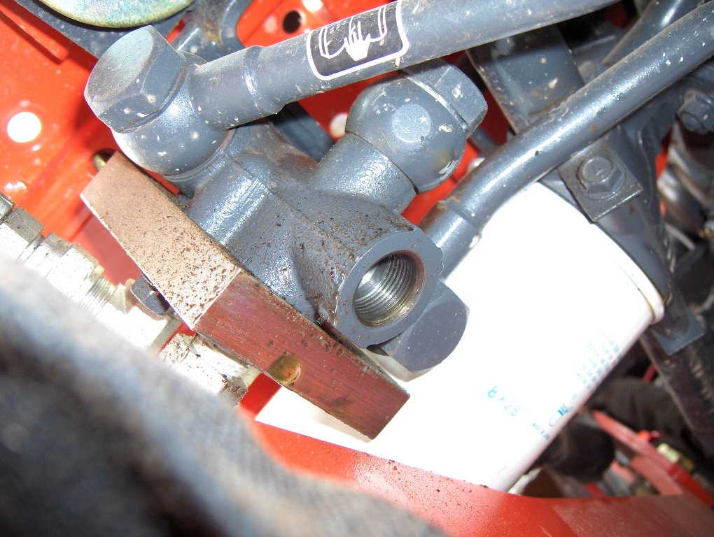

We removed the spring/shim holder of the relief valve and I included a pic for clarity also another pic of the valve body that is a little clearer. the original pressure of 2520PSI is about 110PSI low and he wanted to put it at the top of the acceptable range. The shims add aprox. 38.4PSI for each 0.1mm added. so we added 0.3mm shims the existing shims and reassembled the spring assembly.Threw a shim still in the package for reference in the last pic.

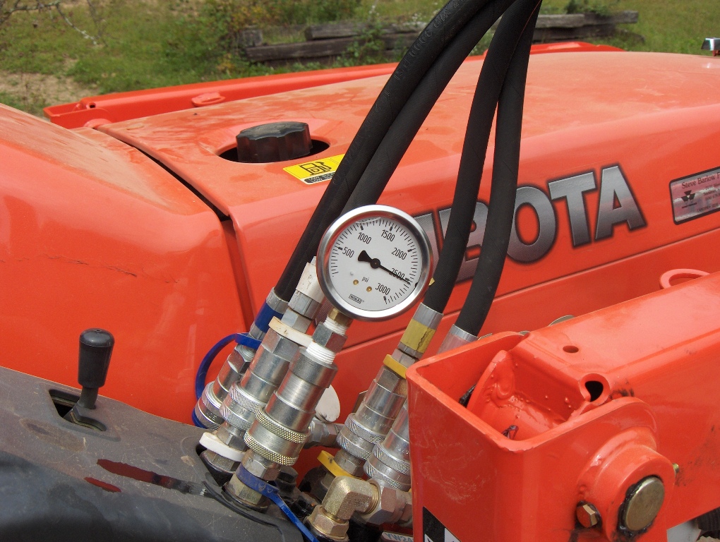

The results are in the first pic with the pressure pretty muckh on spec at 2630PSI. My friend tested the loader and says he can tell a difference in the added 110PSI. I had adjusted the relief on my tractor a few months ago and I wanted to document the process for the next person who might want to check or adjust the pressure relief on their tractor (mine is a Kubota L4400 as well).

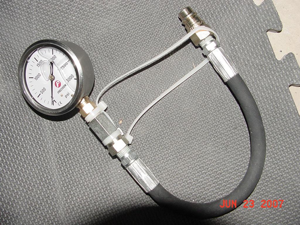

Thanks for posting this, I have a L4610 and also think my lift capacity isn't what it should be. I have wanted to check the pressure and will do so the way you showed. Where do I get one of those fancy quick connect pressure gauges?
/ Front End Loader Pressure check #19
You make one up. Obtain a 3000 psi hyd gage , a short hose, and QD fitting for the end. Plug the QD into one of the valves and activate the lever, and the pressure relief psi setting will show on the gage.
Or put a QD on the gage.
#20
Tractor supply has the gauge and fittings.
