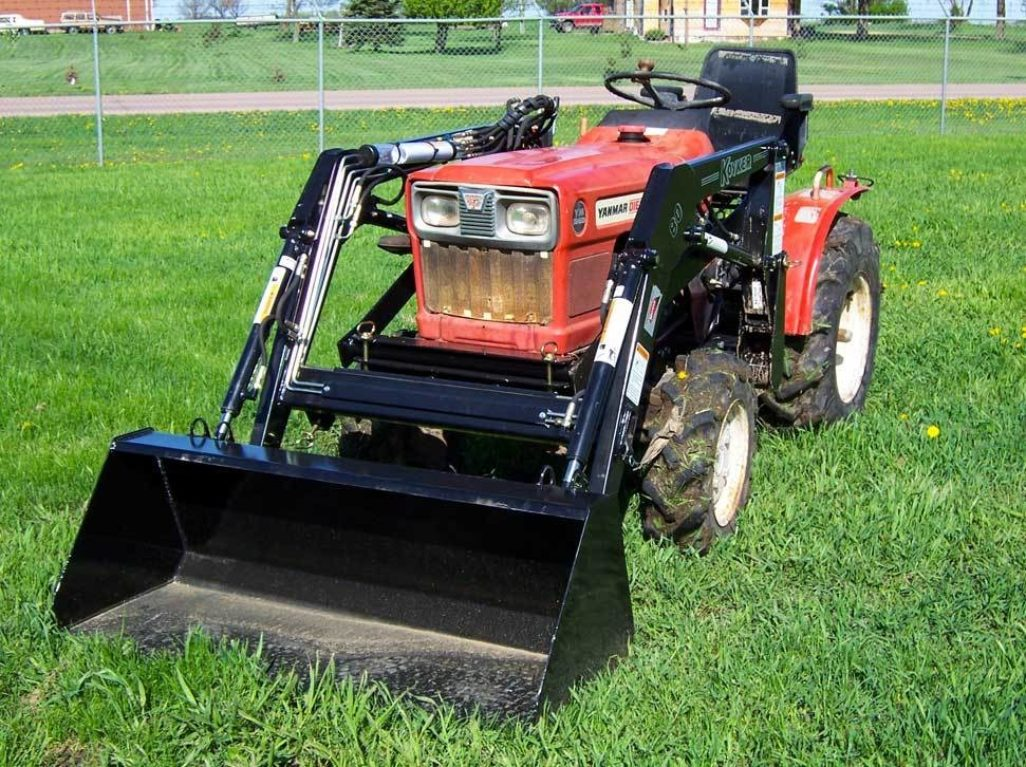

Check this thread out.
The Koyker model 80 loader fits like a glove.
See Koyker's data page here and all the Yanmars using it too.
Model 80
And they have the smallest as a loader 50.
And on the page, you can find a dealer near you for having it delivered and installed. Comes with everything.
Here is a YM1300 aka YM155 like model

Thanks for the info! I appreciate it.
