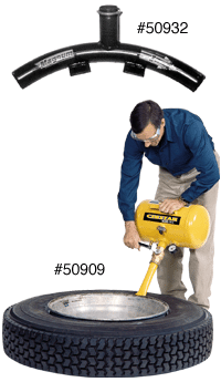

The tool Dave's Tractor described is available but costly. But it will seat the bead. It's just an air tank with a 1/4 turn ball valve that releases all the pressure at once through a pipe that is flattened on the end.
