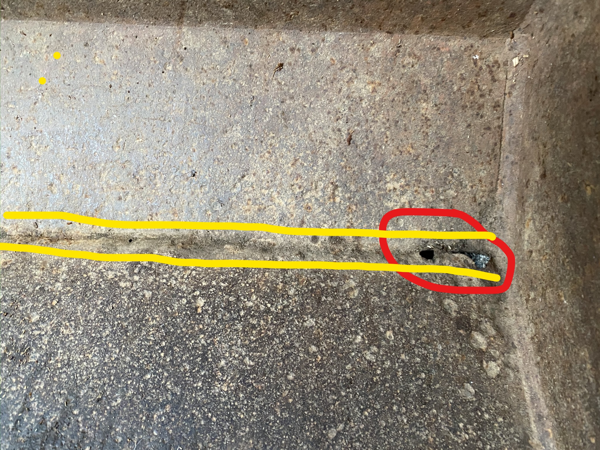

My front loader bucket is getting pretty thin at the end of the bottom section to the point where I'm starting to see some holes there (see attached picture - red marks). Any suggestions on how to best fix it and extend the life of the bucket (I really don't want to buy a new one anytime soon).

What kind of welder do you have?

I would cut out the worn out corner (red) and weld in a flush patch and weld a full width wear strip on the underside of the bucket to preserve the buckets bottom corner width. (Yellow lines)
A 3 inch strip x 3/16or 1/4 inch thick would do.

I had the same problem as you. And Big Barn has a good solution, very similar to mine. Although I didn't cut out a section that was worn, but rather ground it down to good, bear metal, and then welded the "wear plate" to the bottom of the bucket, and finally welded shut the slot I ground down in the original bucket material. This way, it keeps you from burning a larger hole in the bucket if you get too aggressive with the weld. The newly installed wear plate acts like a backer-board for the final weld. (I'm not a professional welder and I need all the help I can get).
The bucket steel is very thin, probably only 1/8". I put an 8" deep wear plate on mine, because I back drag a ¼ mile gravel drive every 4-6 weeks to keep it smooth. Wear plate has held up nicely.

I have found 7014 a good easy to start and run rod if you have a DC stick welder. I like to use it to fill holes. It runs like butter.
