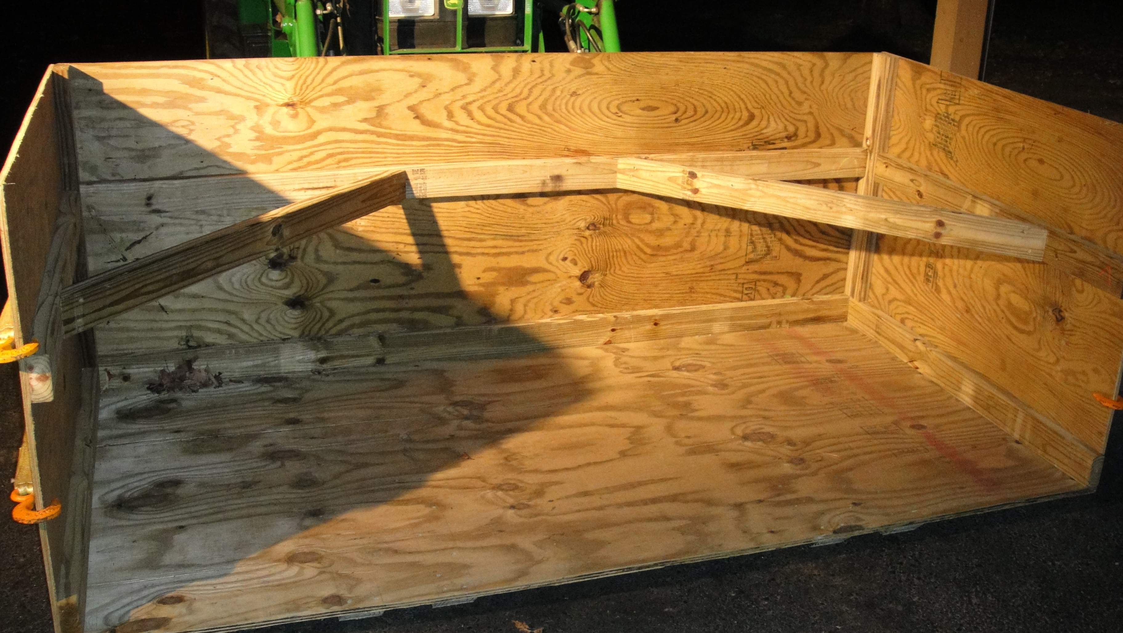

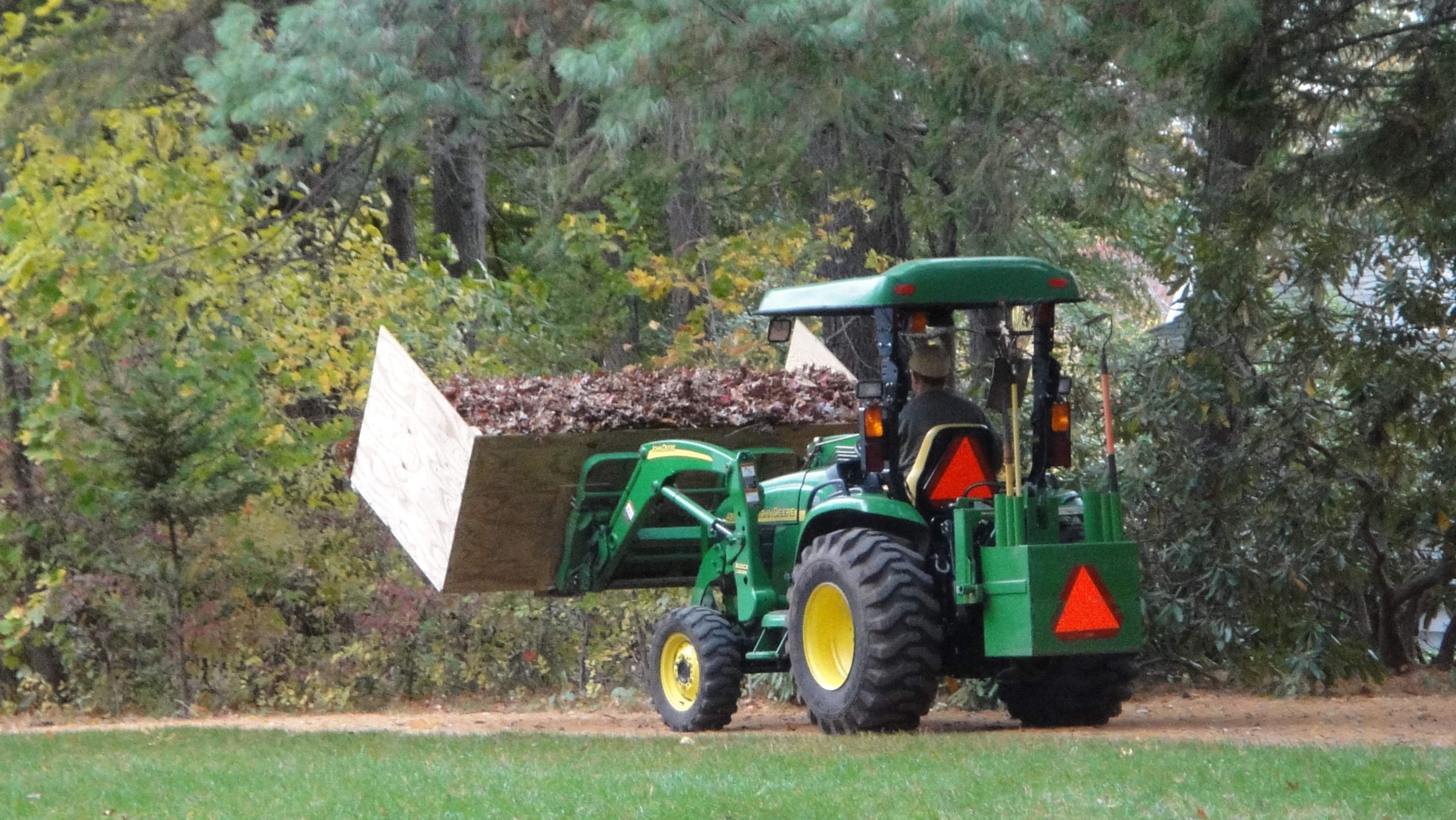

You could use a set of forks and build any type/size carryall you desired out of wood.
Or use a loader mounted receiver hitch and slide a conventional carryall into it.
You could also get a a 3pt carryall from tractor supply for small money.
Here's one monster box I built to handle leaves, also makes a nice work platform for reaching higher places. but this does require you to have the forks.
JB

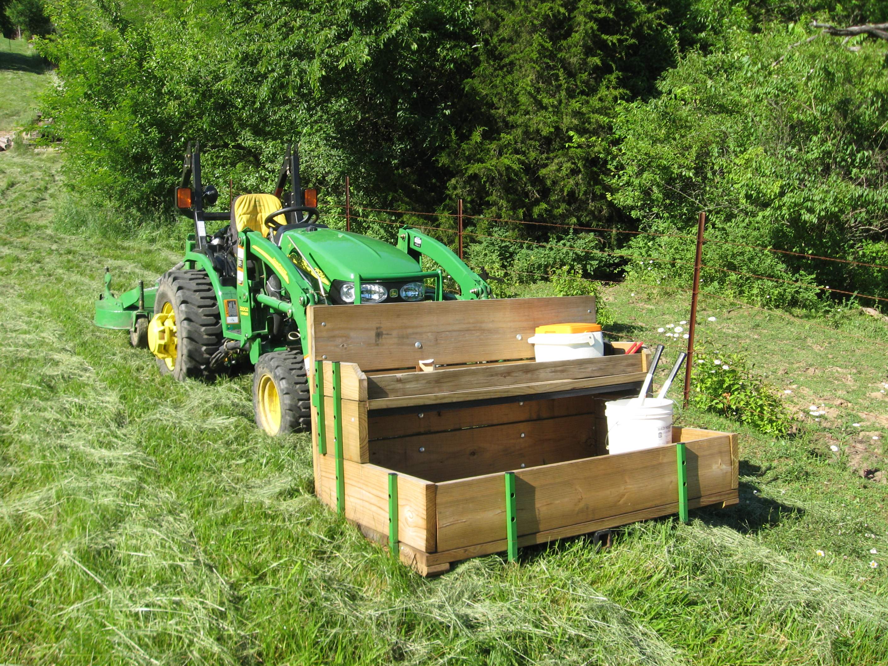

   / Front loader carryall #7
I have the same situation. I really like being able to just grab the carryall on the front and go, without having to drop the mower, chipper or whatever is on the back.
   / Front loader carryall #8
Thats Nice! :) The whole dang work bench! ;)
I like it cause the older I get the less I like working on the ground, this way I got a small bench to work off of!:thumbsup:
   / Front loader carryall #9
That is very nice!! You're set up for the whole day!!
Is that box on forks, or did you build a QA hookup on it?
