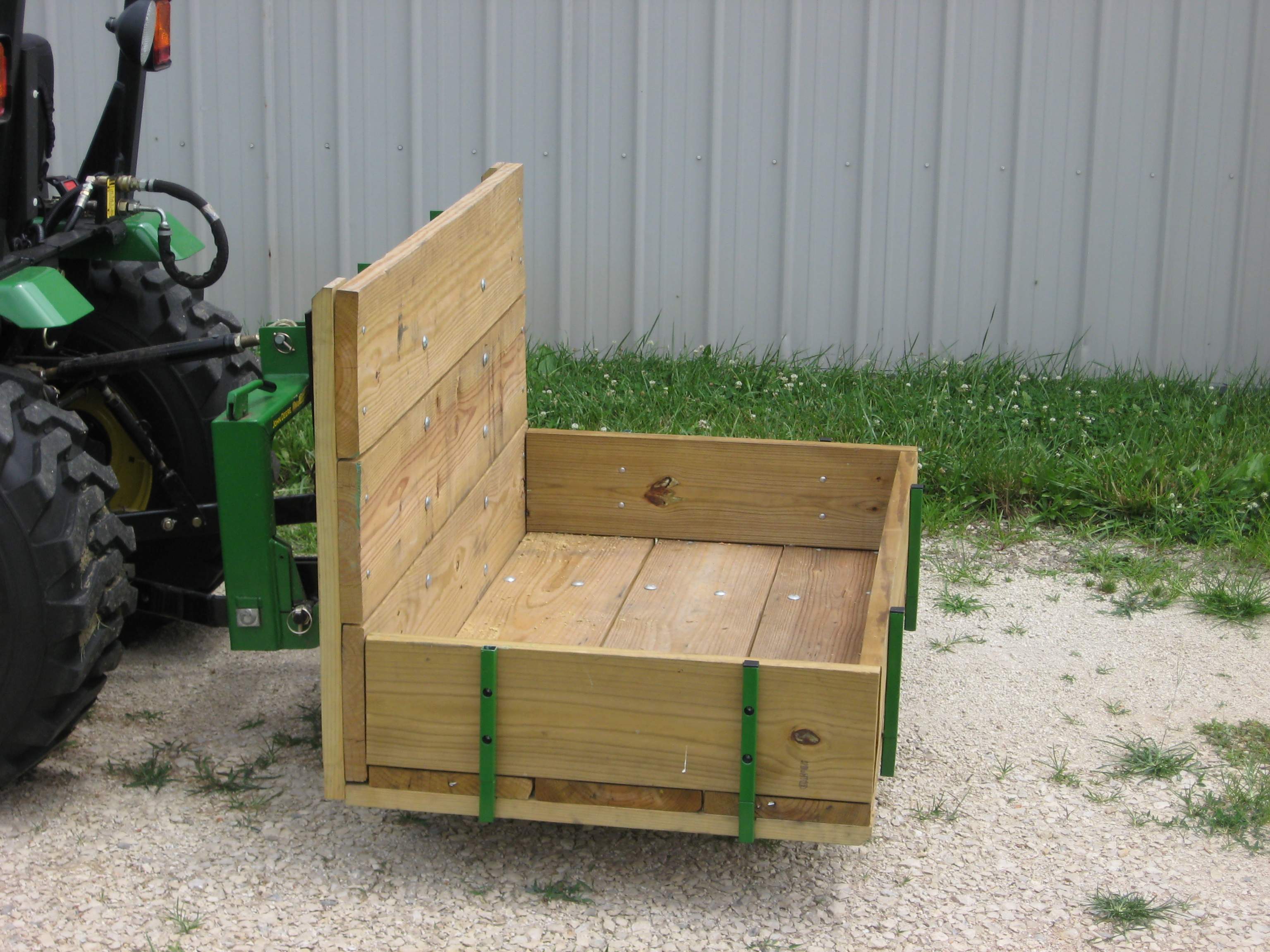

That is a neat setup! As others have asked, is that box on forks, or did you build a QA attachment?

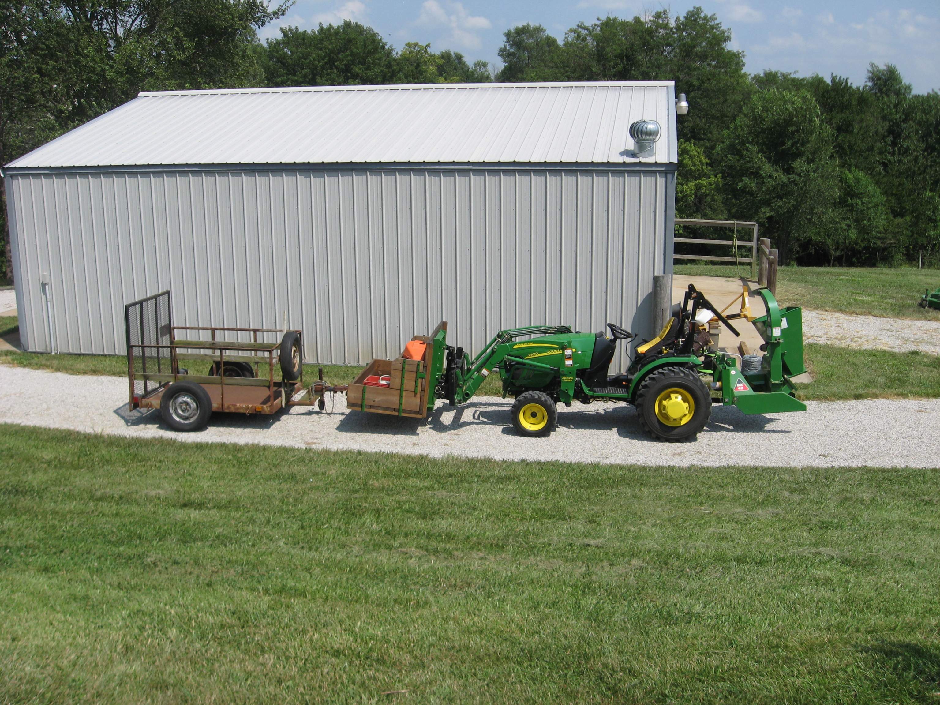

And what's with the hitch receiver under the front edge of the box? You planning to haul garden implements and tow a trailer at the same time? :D
   / Front loader carryall #13

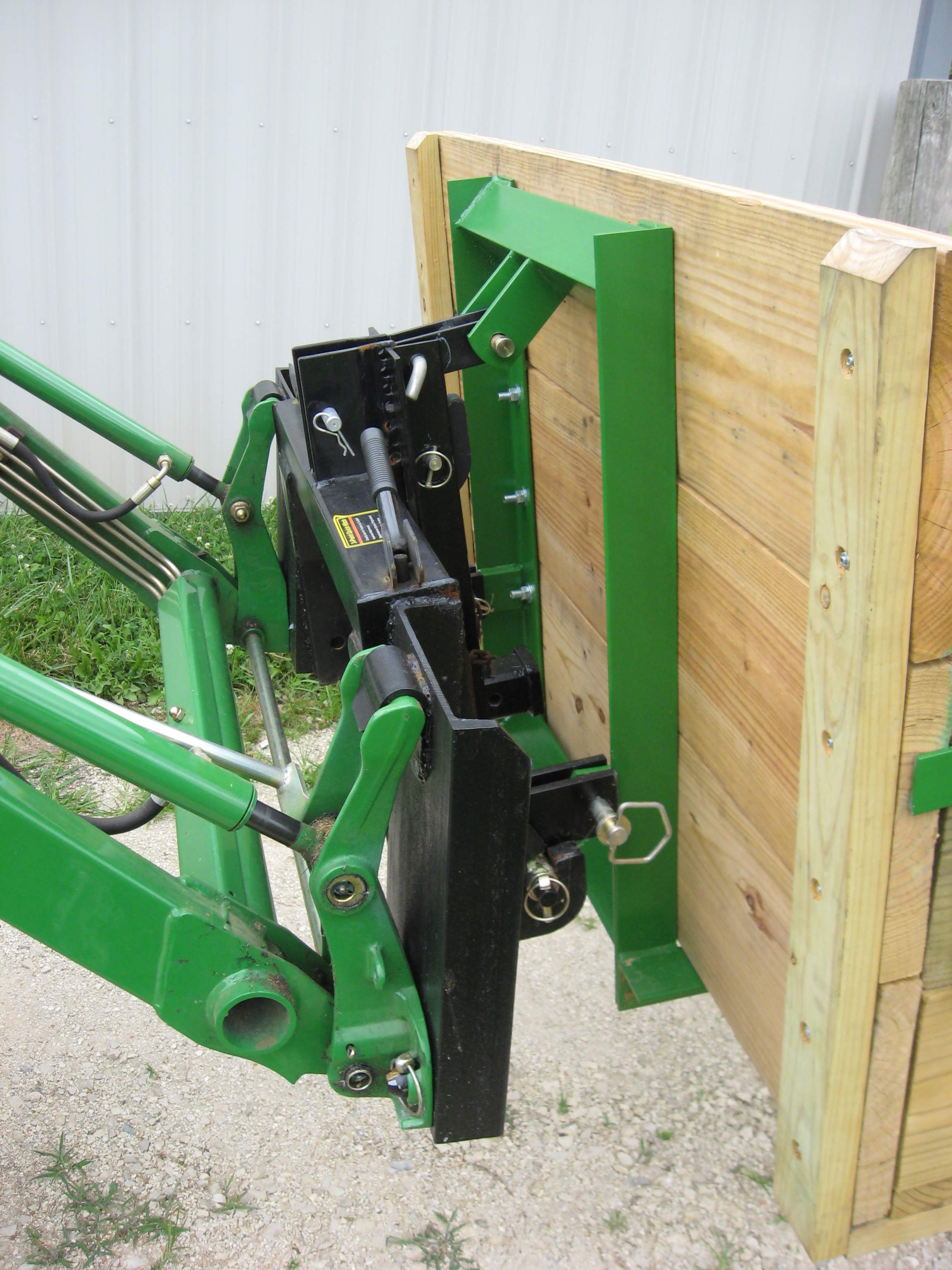

"That is a neat setup! As others have asked, is that box on forks, or did you build a QA attachment?
I modified a HF quick hitch to fit on my loader mounts.
You are correct, Sir, that is a receiver hitch on the carryall. You bet your britches that I do pull a trailer with it in that configuration...
And what's with the hitch receiver under the front edge of the box? You planning to haul garden implements and tow a trailer at the same time? "
That's great! so you could use it on the rear as well. I see you have another adapter between the QH and the carryall?

"That's great! so you could use it on the rear as well. I see you have another adapter between the QH and the carryall?"

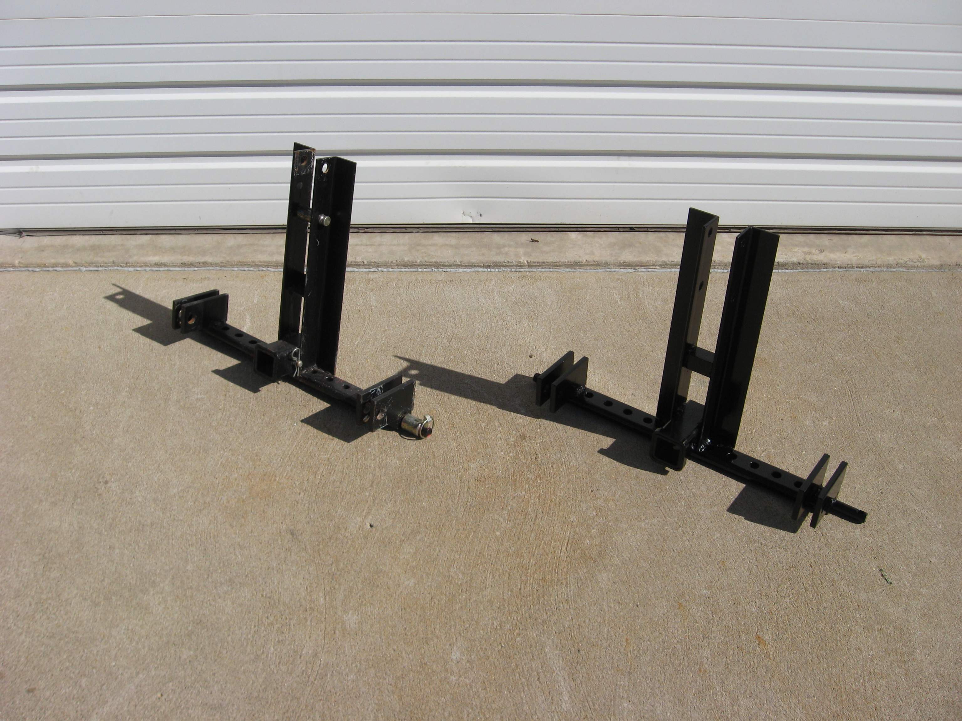

Yes, the "adapter" is also a trailer hitch. I made the adapter because my KK carryall and rake are not quick hitch compatible. One of these days, I'll probably modify them, but the adapter seemed like the easy solution at the time.

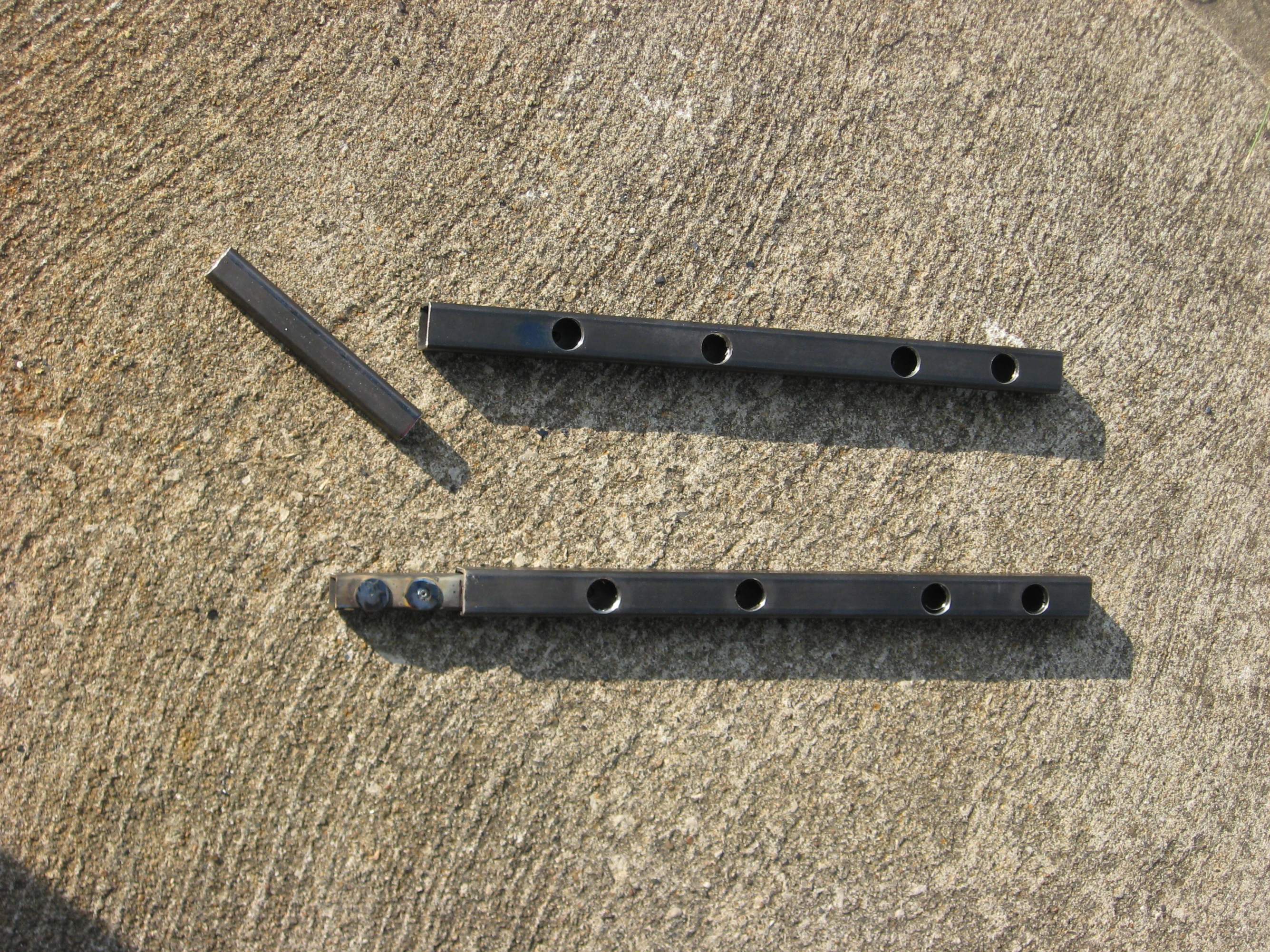

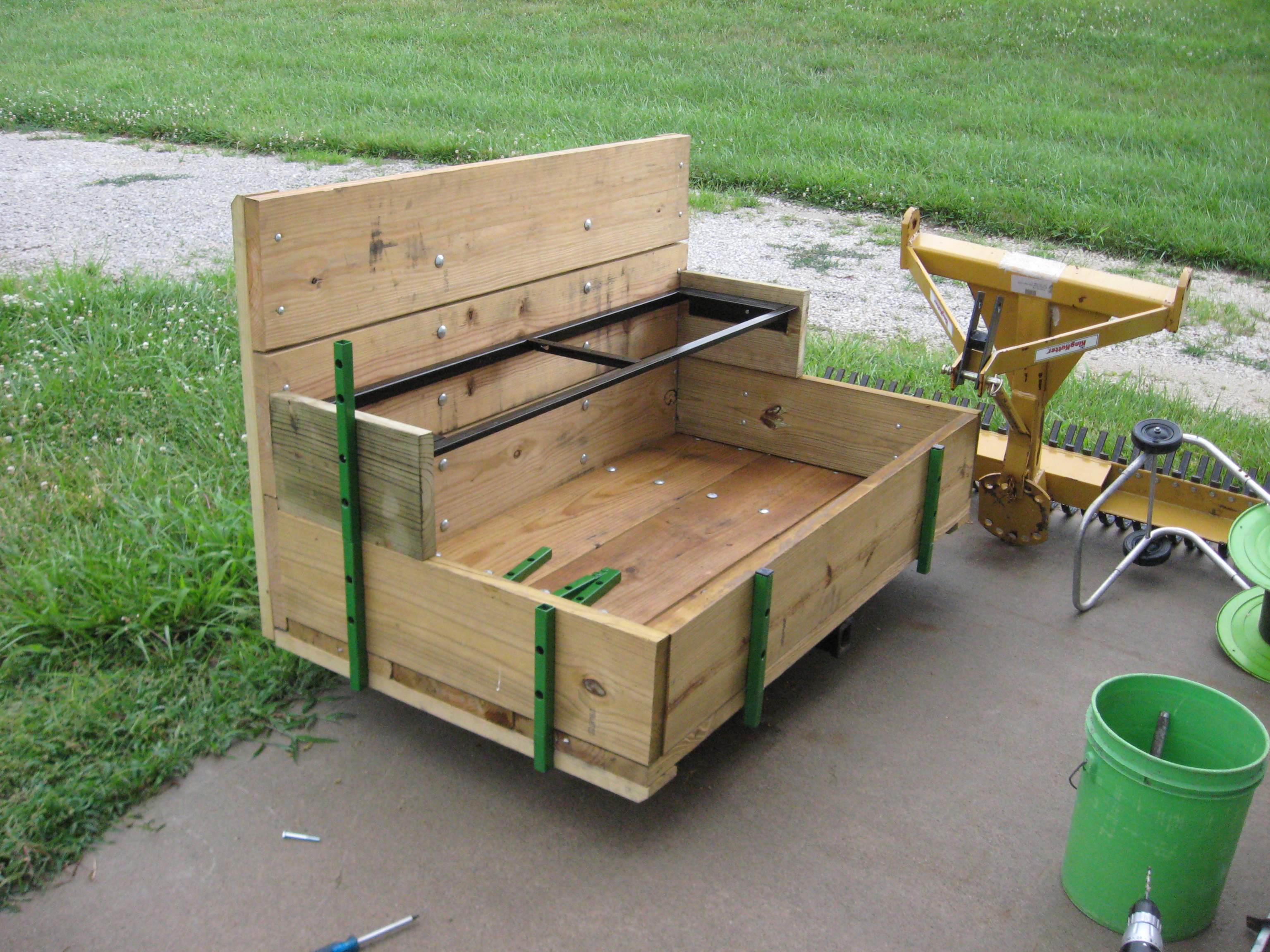

...and to those asking about the carryall build thread... I thought I did one, but the only one I found was this:
http://www.tractorbynet.com/forums/customization/144060-modified-king-kutter-carryall.html

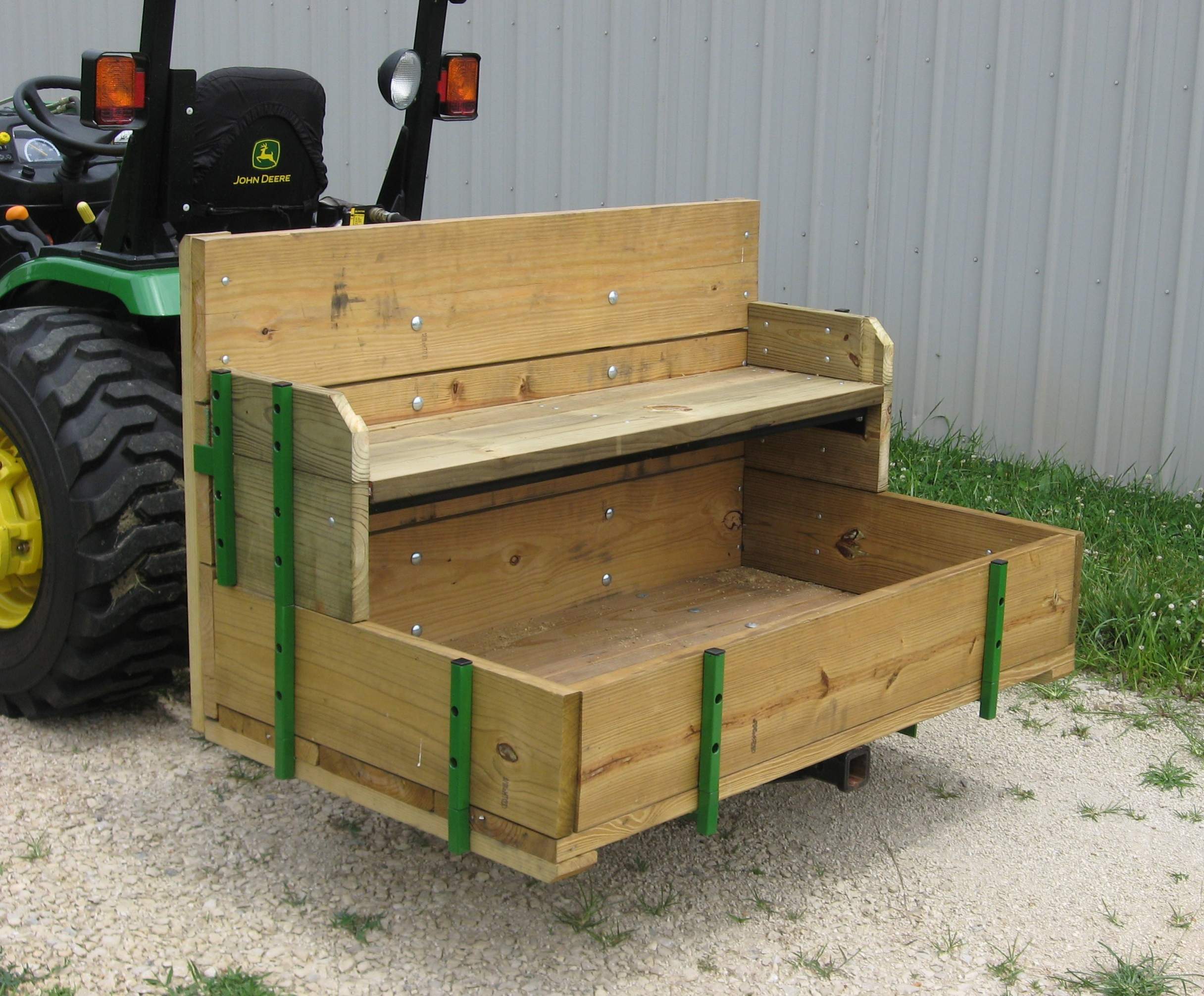

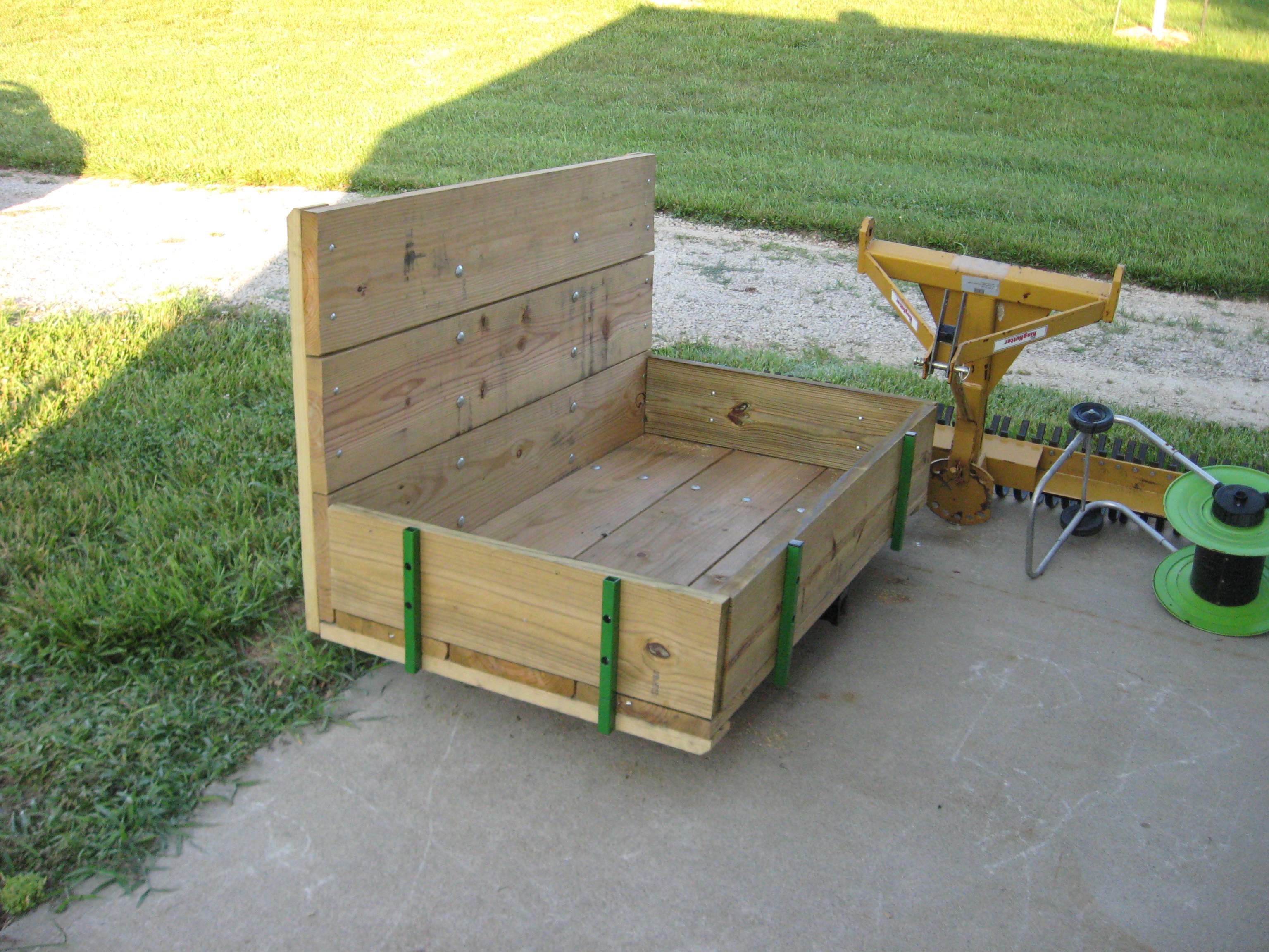

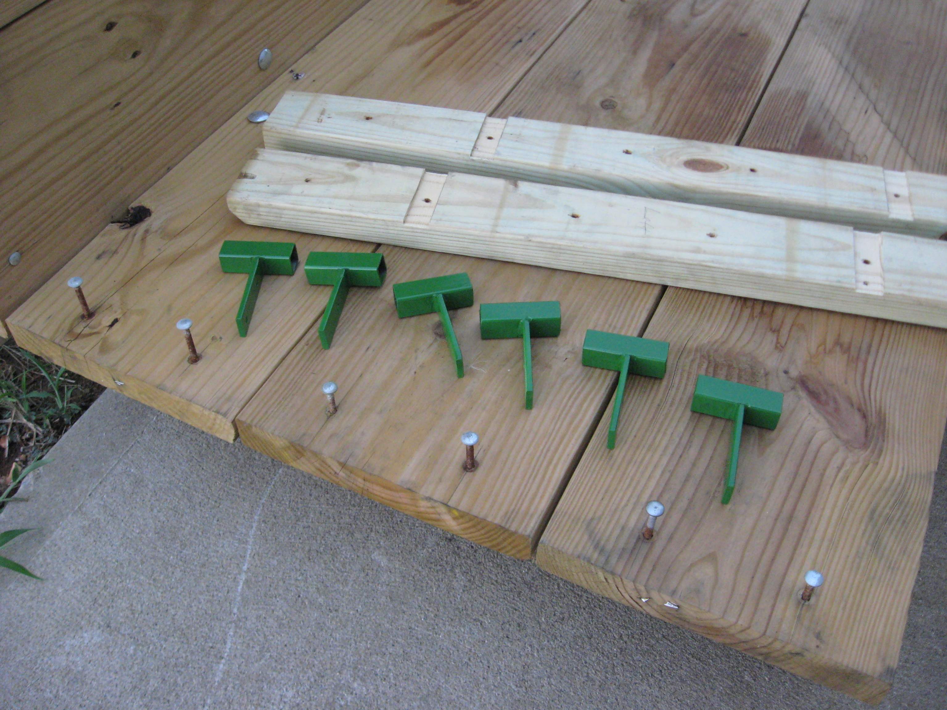

After that one, I built the sides and seat and I'm not sure I posted any pics of that process, maybe they're scattered amongst other threads so here are some. The steel stakes on the sides are "nested" so top tube slides into the bottom tube and the bottom tube slides into the "stake pocket" which is another tube. I don't like bolts sticking out to snag things, so I drilled holes in the tubes to recess the ends of the bolts.
The seat is reinforced with some old bed rails, just to keep it from sagging and racking from side to side. The seat and each of the side and end pieces are removable.

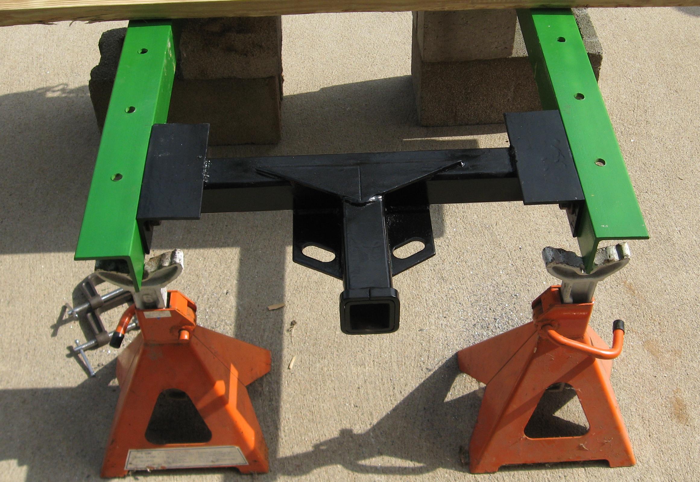

The receiver hitch is just cut-down from one that came off a car, bolted between the "forks" of the carryall frame.
