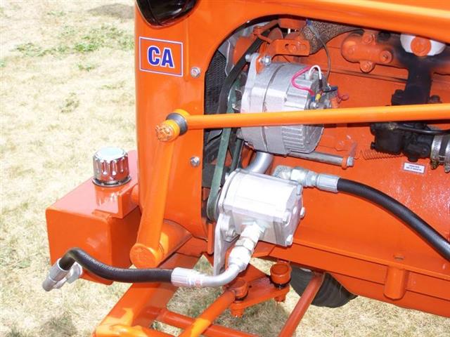

No I haven't. I was wondering how hard it would be to fab up the brackets and a coupler. I have added a clutched air compressor to a truck a long time ago. It was pretty simple. A clutched hydraulic pump would be exactly the same.
My currrent machine has three pumps directly coupled to a 25HP Kohler engine; one on the regular crank shaft and the other two on a PTO stub off the opposite side of the crankshaft. It's very hard on the starter in the winter to crank it over with cold hydraulic fluid. Very hard, but it starts down to -5F, but barely. Not too bad in summer, though. Based on that experience, if I could clutch it out, I would. There's a clutch kit available for a Kohler, but it would add length to the setup that I do not have room for in my engine bay, and since I have pumps on both ends, I'd need two clutch kits. I could get a stacked pump and put all three pumps on one side of the motor, and clutch that, but it would still add length to the setup that I don't have room for.
The clutched pump for a pickup truck engine is pretty darn cheap and belt driven VS a pump directly coupled to the front crank of an engine. The belt drive provides an easy coupling, while a direct coupled pump would have to be connected to the front of the crankshaft on the Ranger. There's not enough room between the crank and the radiator to put a shaft out the front, so you'd have to relocate the radiator up to clear the shaft.
Now I did find this picture on the internet of a belt driven hydraulic pump that appears to be driven off of a double alternator pulley on a tractor engine. There's no clutch and its belt driven. That would be another option on the Ranger if he wanted to skip the clutch.
Came from this link on adding a pump to an AC B.
Adding a hydraulic pump to AC B? - AllisChalmers Forum

That’s probably how I’d do it. The biggest problem I see is the alternator has a wide range of rpm with the upper end too fast for a hydraulic pump.
That's another reason why a clutched unit on an automobile engine would be my preference. You can shut it off if you have to run the engine at high RPM for some reason.
I just wonder how the Ranger's engine would work as a loader with direct drive of the wheels, which means huge RPM swings, which means intermittent power swings on the hydraulics.
