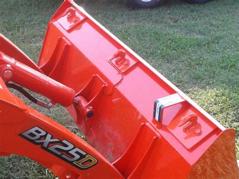

I just got my tractor and the level Indicator is confusing. Unless the dealer set it up wrong but when it's flush the bucked is digging in still. How does everyone else have there? Really wish there was a work around to get something that kubota uses where it falls into the bend part seems much easier to see from the cab.

It should be adjustable, set it up however you like. I have mine on the cab tractor set so it is about and inch off the ground because that is the tractor I use to move snow with and don't want it to dig into the gravel.

I just set my bucket flat, then cut my level indictor rod so its flush with the tube.

I have seen operators adjust the rod (or cut) so it's flush with the tube, depending on design. Paint marks or tape also work.

Park it on flat level surface and make the bucket level. Now what does the indicator look like? Either make a mental note where level is...or adjust?modify the indicator to your liking. But even a level bucket can still dig in, or not dig at all....unless you are on perfectly flat land.

I like my indicator to be correct. Since it is a rod going through a hole in a plate. I found level and painted one color above and another below. Easy enough to do and use.

I have my indicator cut dead on when the rod is flush with the tube.

This one is everything I need. When it is level the bucket is level to the ground, at ANY elevation. If I have forks fie feet of the ground and this is level, the forks are level.
BTW, this is NOT my bucket but an example. I am on my second bucket after 6400 hours on the L2550DT... :)
