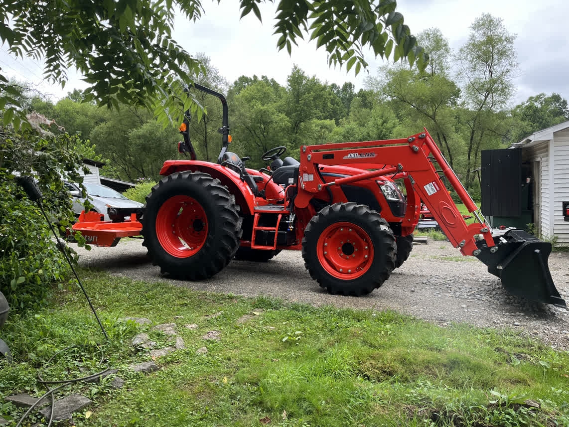

I will try to post some nice pics very soon. Here is a pic my dealer sent me before I could get my tractor.

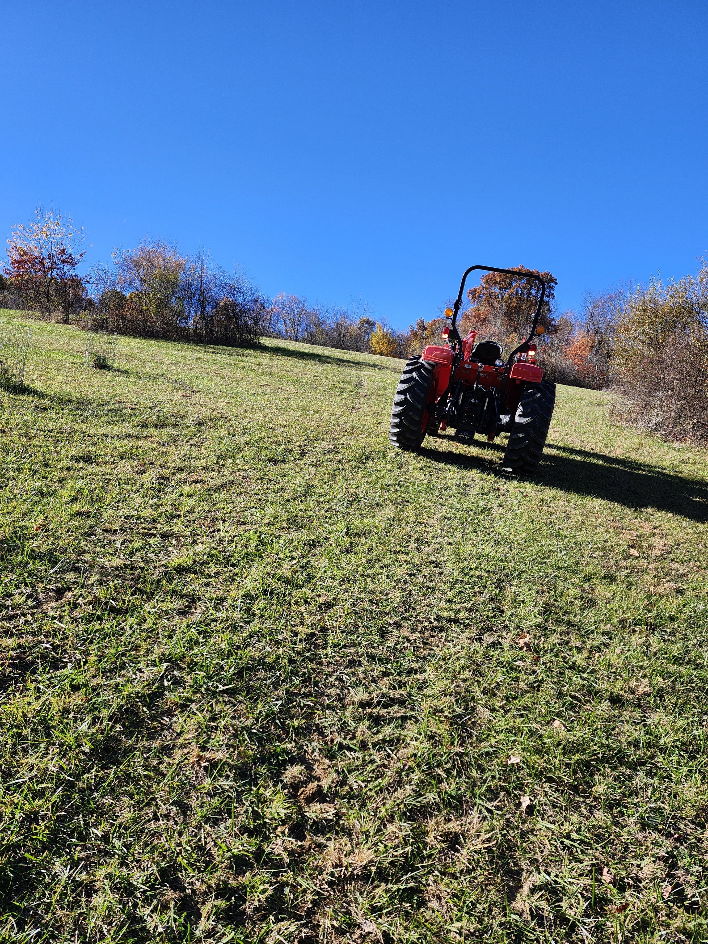

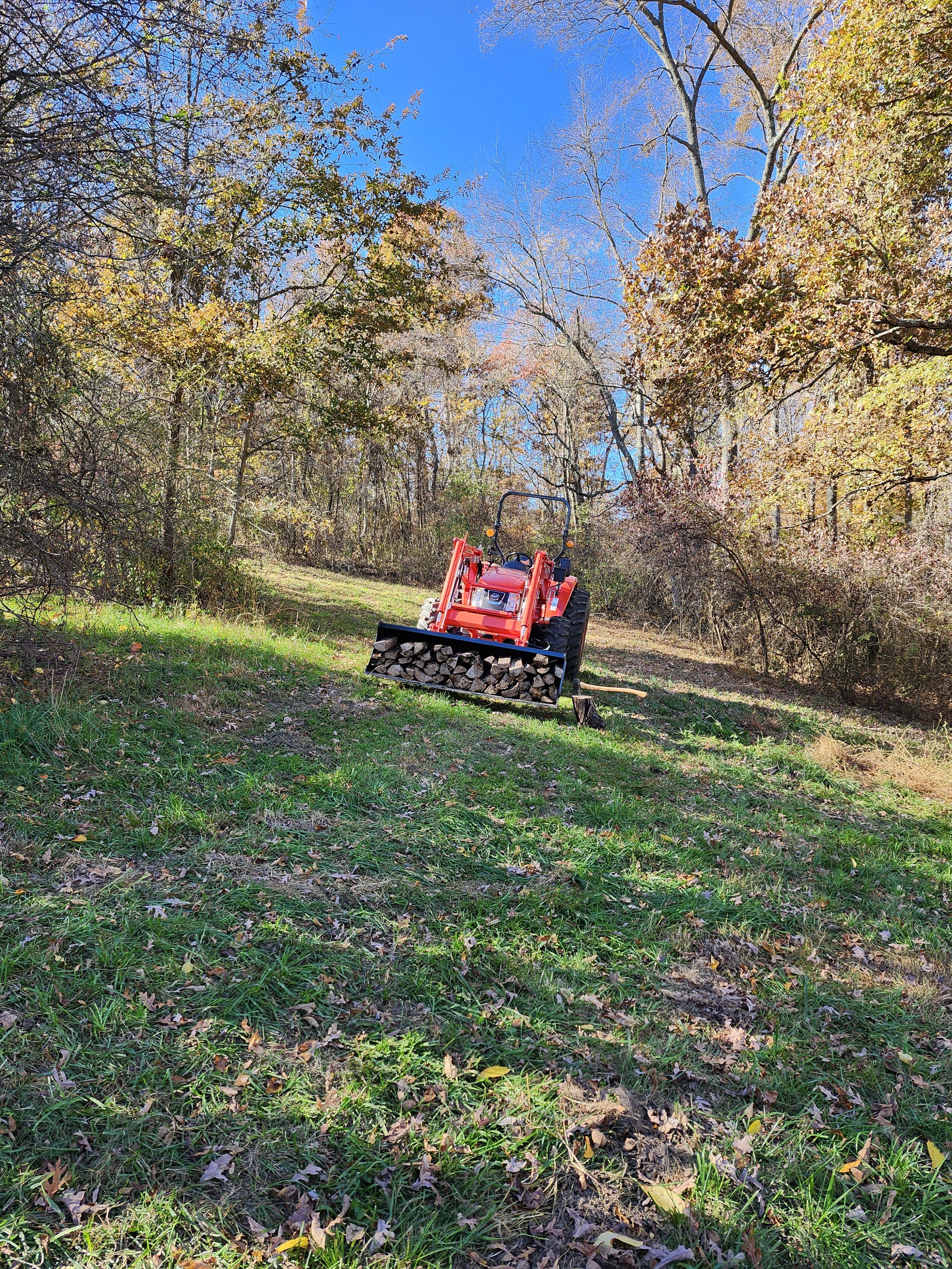

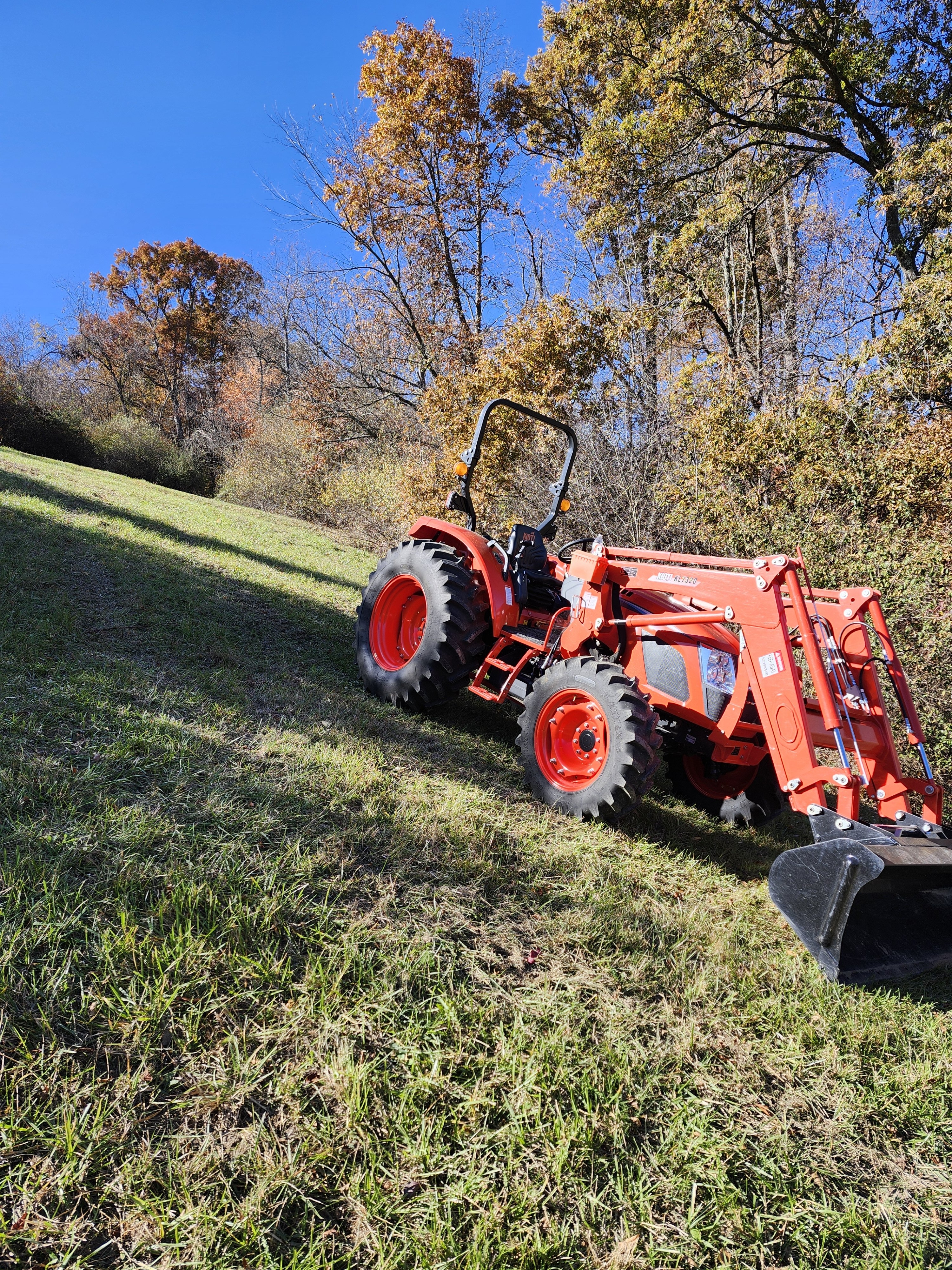

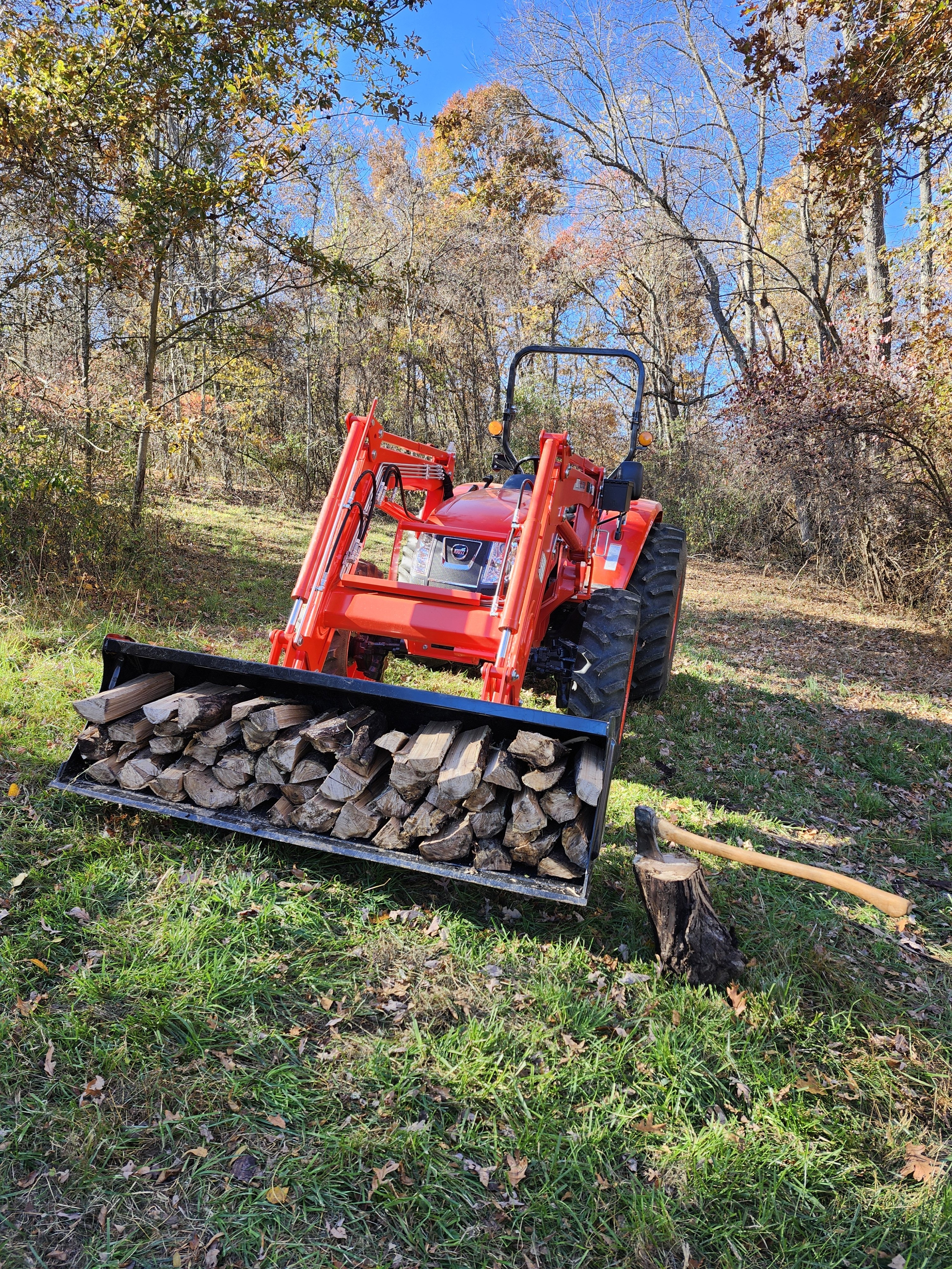

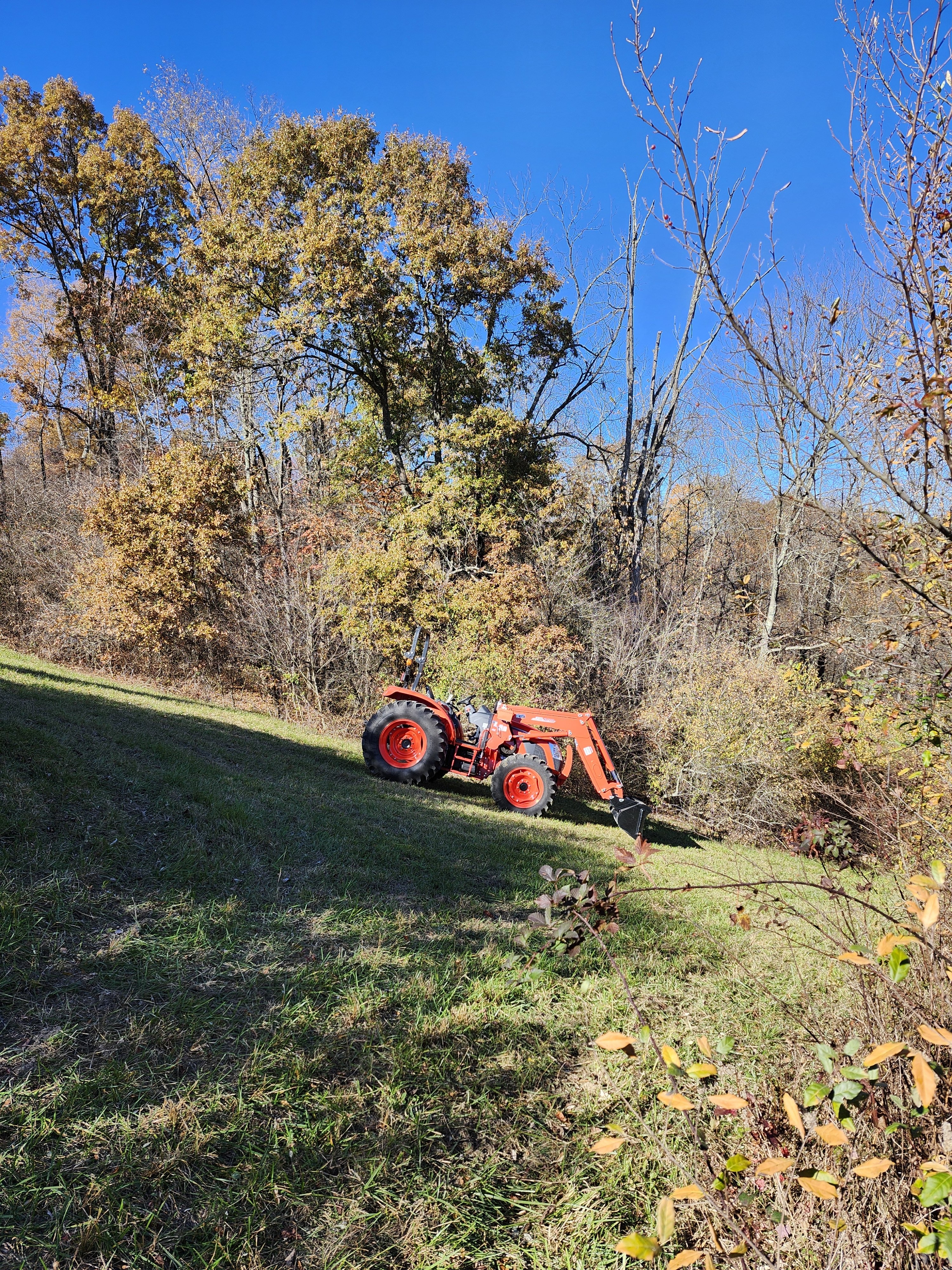

A few more notes. I like the fact I can easily enter/exit tractor from either side. The operators platform is easy to clean. Finally, I like that I actually have a functional seat belt. My other tractors had no seat belt. I have attached some additional photos. Hopefully they give you a sense of the slopes I deal with.20241027_143934.jpg20241027_144205.jpg20241027_144142.jpg20241027_144909.jpg20241027_144929.jpg

I am going to try posting pics one more time. Still trying to figure out best way.

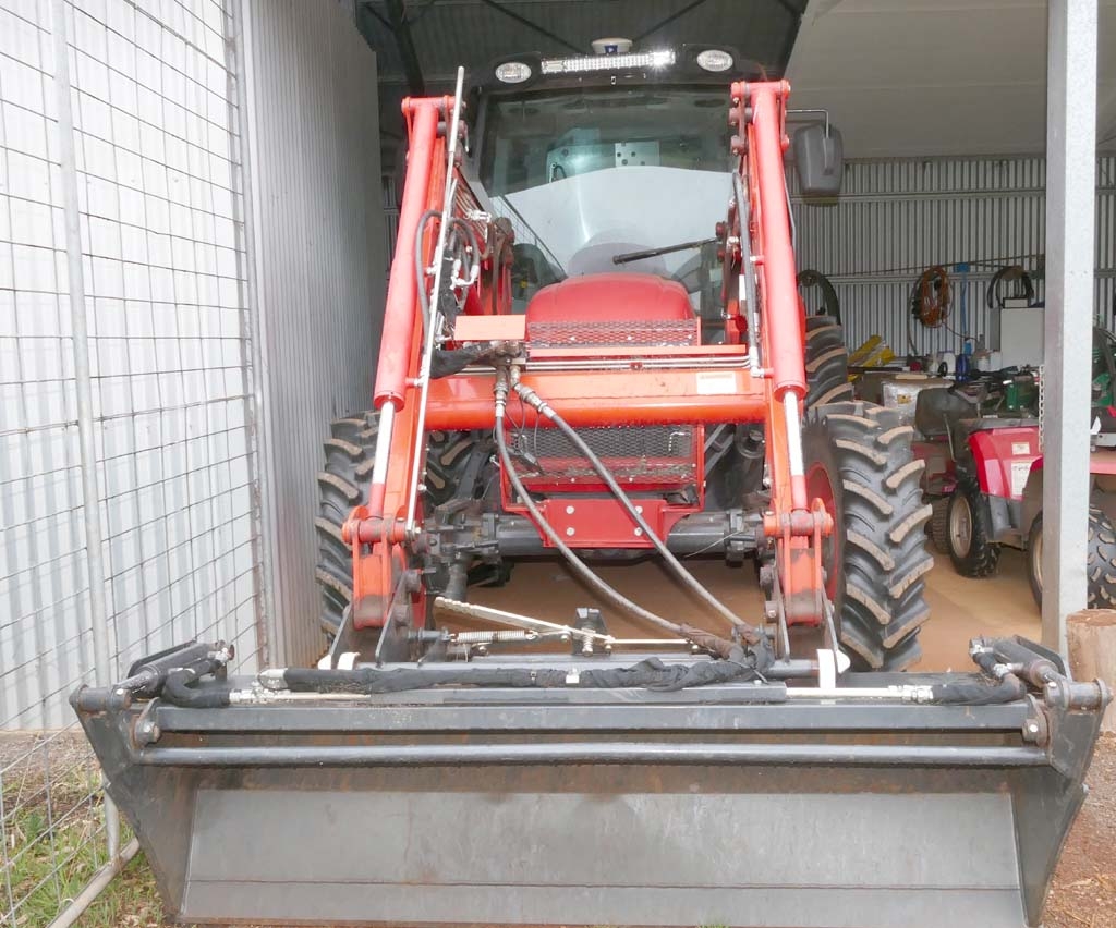

A couple of points which resonate with my ownership of the slightly bigger RX8030:
The FEL cross-bar sure does block out the headlights, so I installed a light bar between the two worklights at the top of the cab. So I guess the ROPS frame could be used as a mount for a lightbar?
